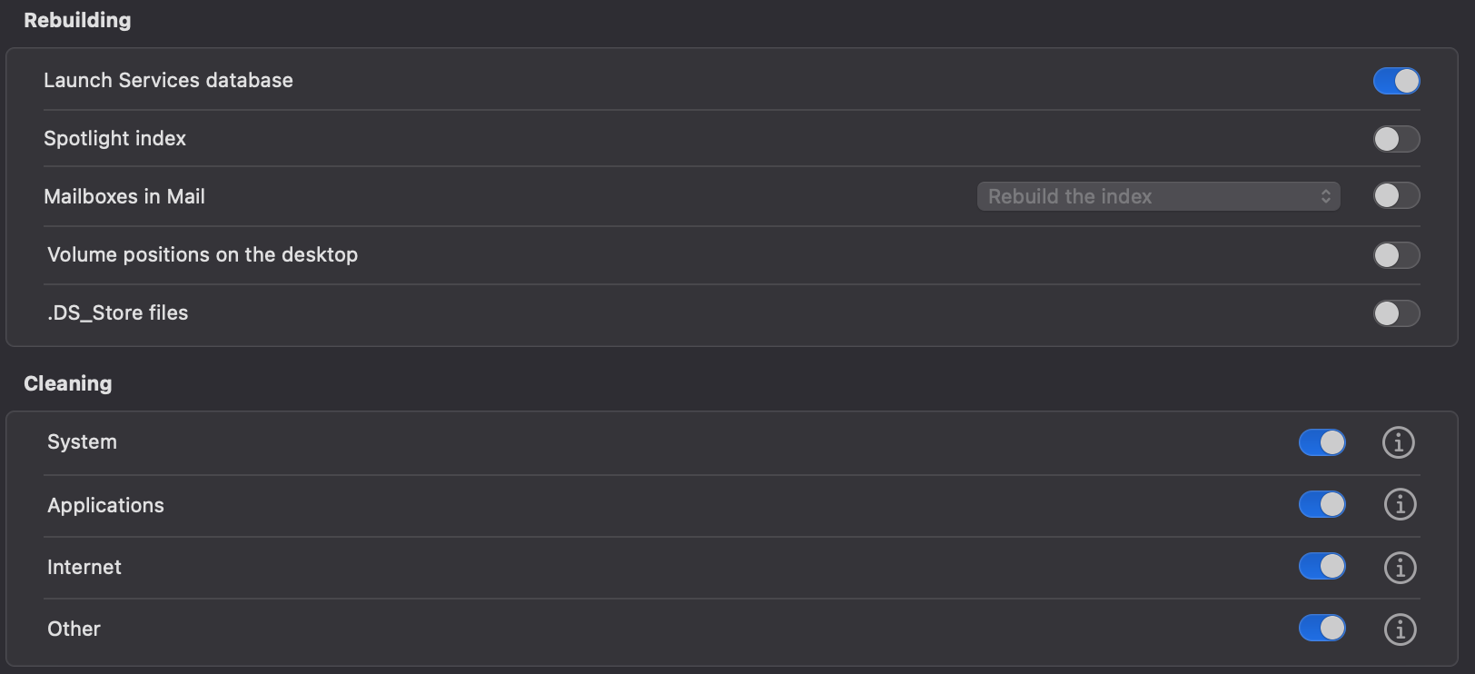

Not sure if this will help with stability, but I find that running Onyx (latest) maintenance helps clean out prior OS residue and things seem better at least for me (does reboot with the process) -

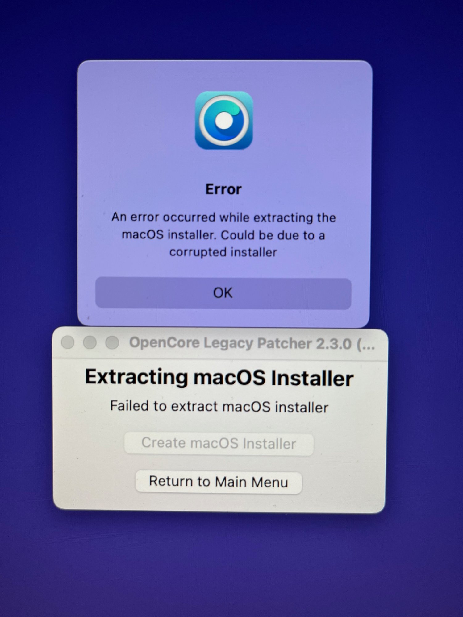

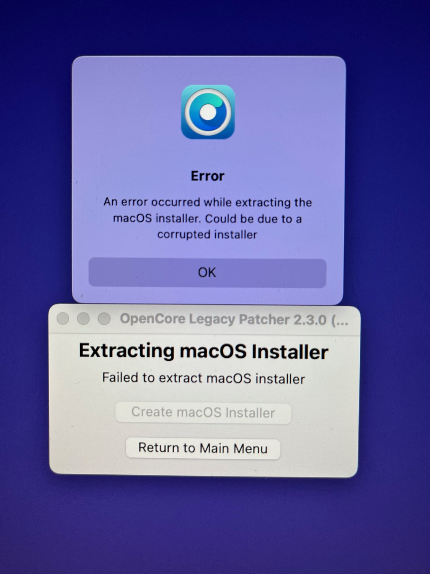

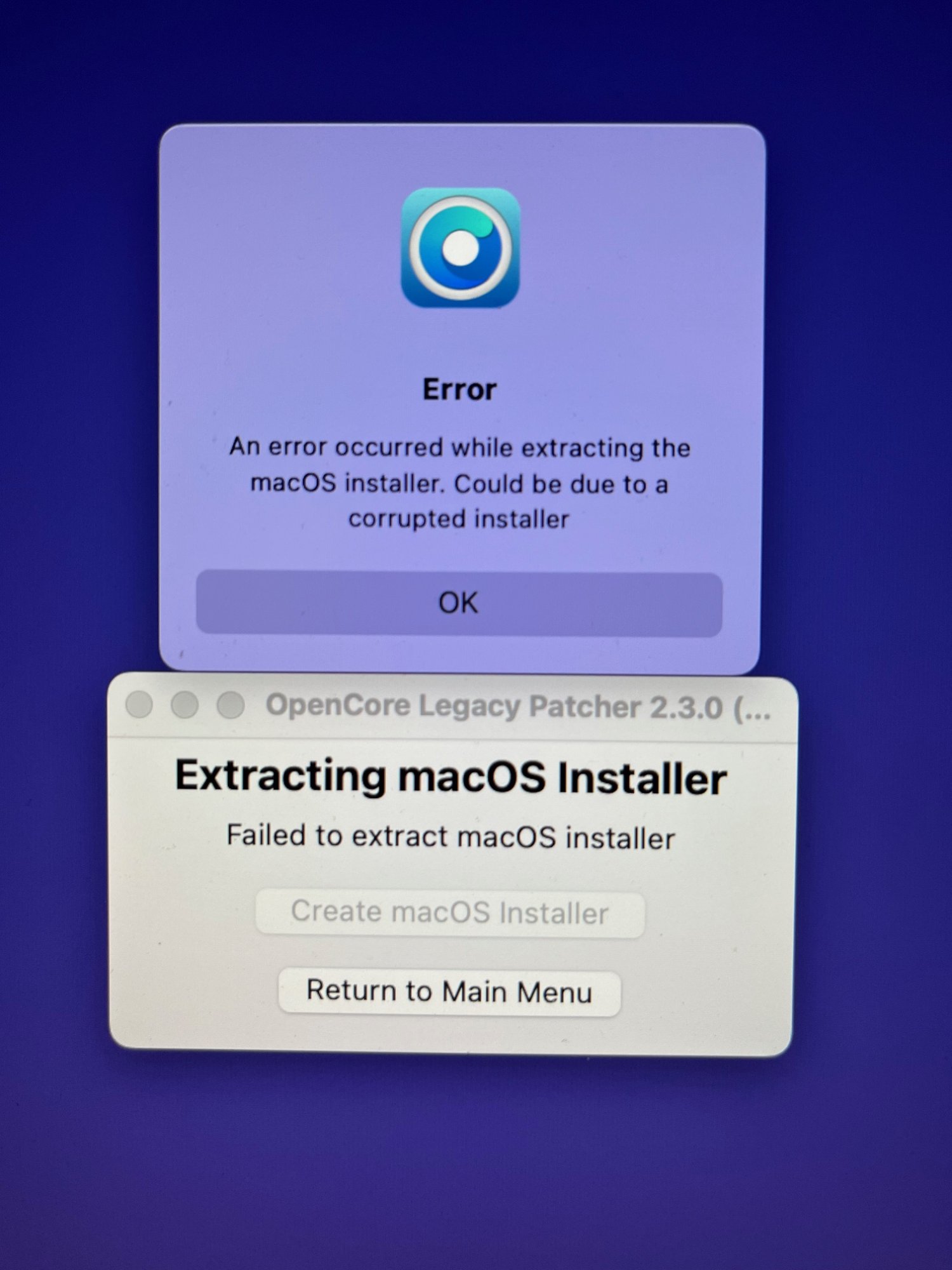

I want to create another USB for Seq with OCLP on the installer, using 2.3n OTA I have tried 3 times for 24D60 and once for 15.2. each time I get this error. can anyone explain why.
Has anyone else made a USB installer for 24D60 using OCLP/OTA.

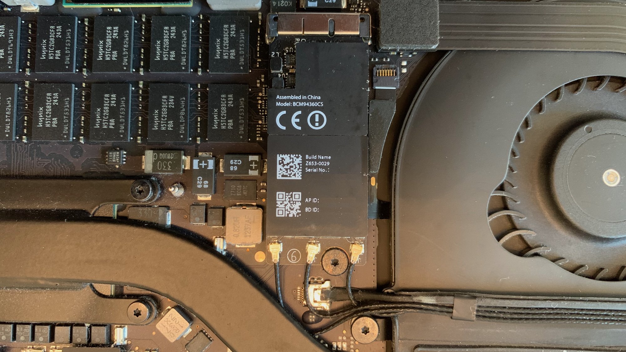

rMBP10,1 2012 running Sequoia 15.2.
System Setting offering me to upgrade to 15.3 but previous OTA have never worked for me on this rMBP (downloading just hangs).
Play A: Instead I have to download the Full installer (via OCLP) into /Applications and just run that.
I did the same this time with 15.3 but when running the Installer, I was asked to select the volume to upgrade but was not able to select my Sequoia volume.
Plan B: I have a small 16GB HFS partition that I use as an Installer partition. I use createinstallmedia command to create a Sequoia installer (instead of using a USB drive which is slow):
sudo /Applications/Install\ macOS\ Sequoia.app/Contents/Resources/createinstallmedia --volume "/Volumes/Install macOS Sequoia" /Applications/Install\ macOS\ Sequoia.app --nointeraction
where "/Volumes/Install macOS Sequoia" is my 16GB installer partition.
Then reboot and use OpenCore's boot picker to select the "Install macOS Sequoia" drive to boot which starts the Sequoia 15.3 Installer (technically, it's actually the Sequoia Recovery App from where you install macOS).
Strangely, this time 15.3 Recovery does not allow any WiFi connection. 15.2 had no problems with WiFi.
My rMBP was previously upgraded with the WiFi card BCM94360CS (one of the "Modern Wireless") and that was supported in the Recovery Apps previously.
It appears that 15.3 no longer supports the BCM94360CS WiFi module anymore (or OCLP's OpenCore WiFi kext is not compatible with 15.3).

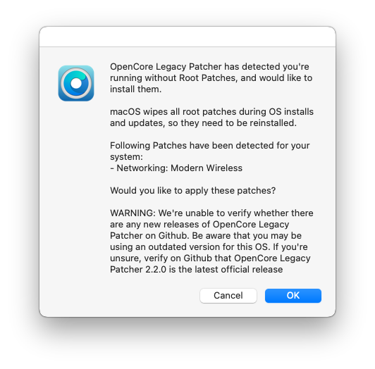

Anyway I managed to over install 15.3 and on reboot, OCLP ran automatically and prompted me to apply root patches for just "Modern Networking" but also there was a warning:
That's because I had no WiFi and OCLP could not verify itself. Never had this issue with previous Updates.

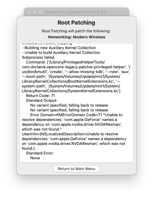

The attempt to apply root patches failed:
The issue was that OCLP could not download the MetallibSupportPkg for 15.3.
Plan C: Luckily I have an Apple Thunderbolt-to-Ethernet Adapter. I plugged that into the rMBP and started OCLP and this time Root Patching was successful. On reboot, WiFi works fine.
I was curious when I read your post so I tried building a bootable USB thumb drive for MacOS 15.3 beta 3 build 24D60 using OCLP 2.2.0 and was successful. I did this using my Early 2015 MBP 13 i7 today.
Thanks for responding: Today I downloaded 24D57 from OSXdaily their latest, to the applications folder, and OCLP 2.3 successfully created a usb installer. I then tried to download 24D60 with OCLP and again the extraction failed. Maybe it is because I have 2.3 instead of 2.2, doesn't seem likely.
