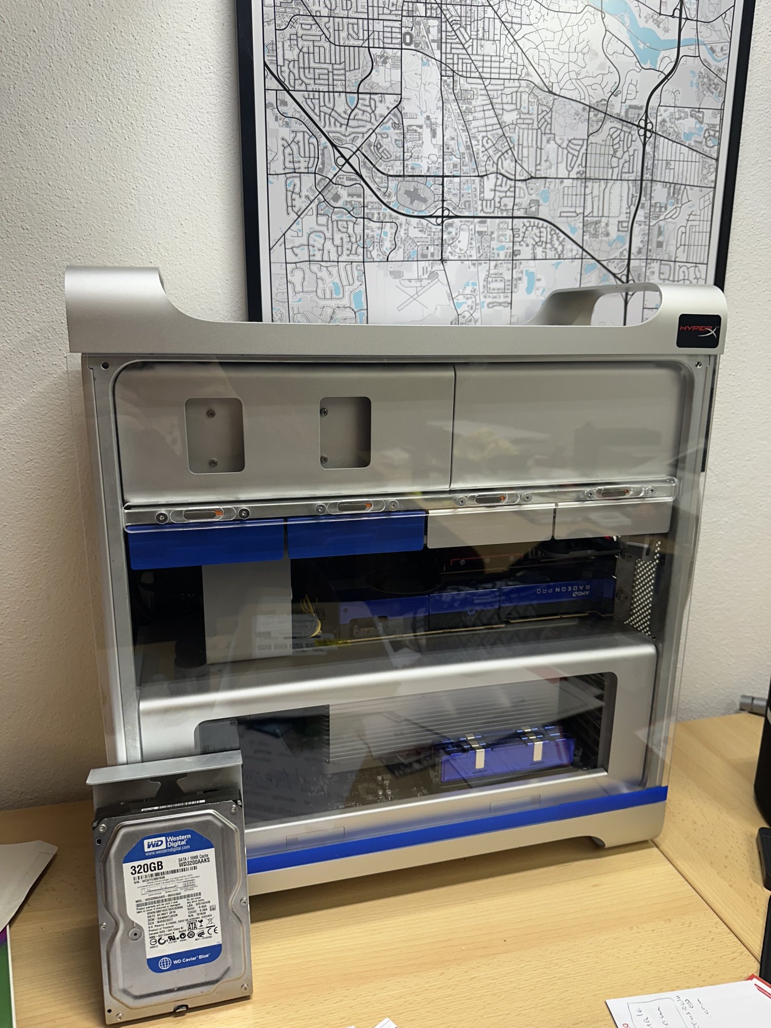

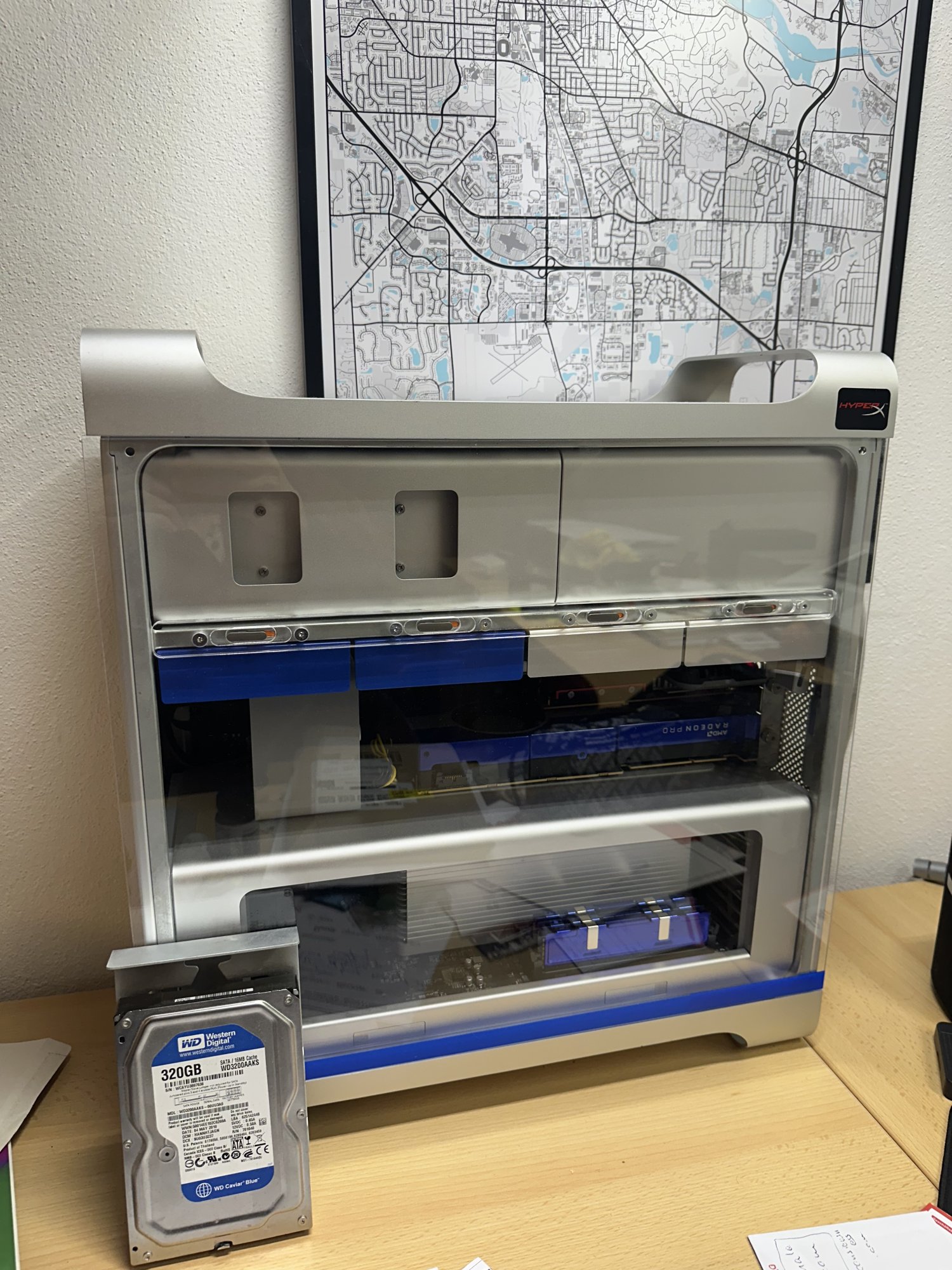

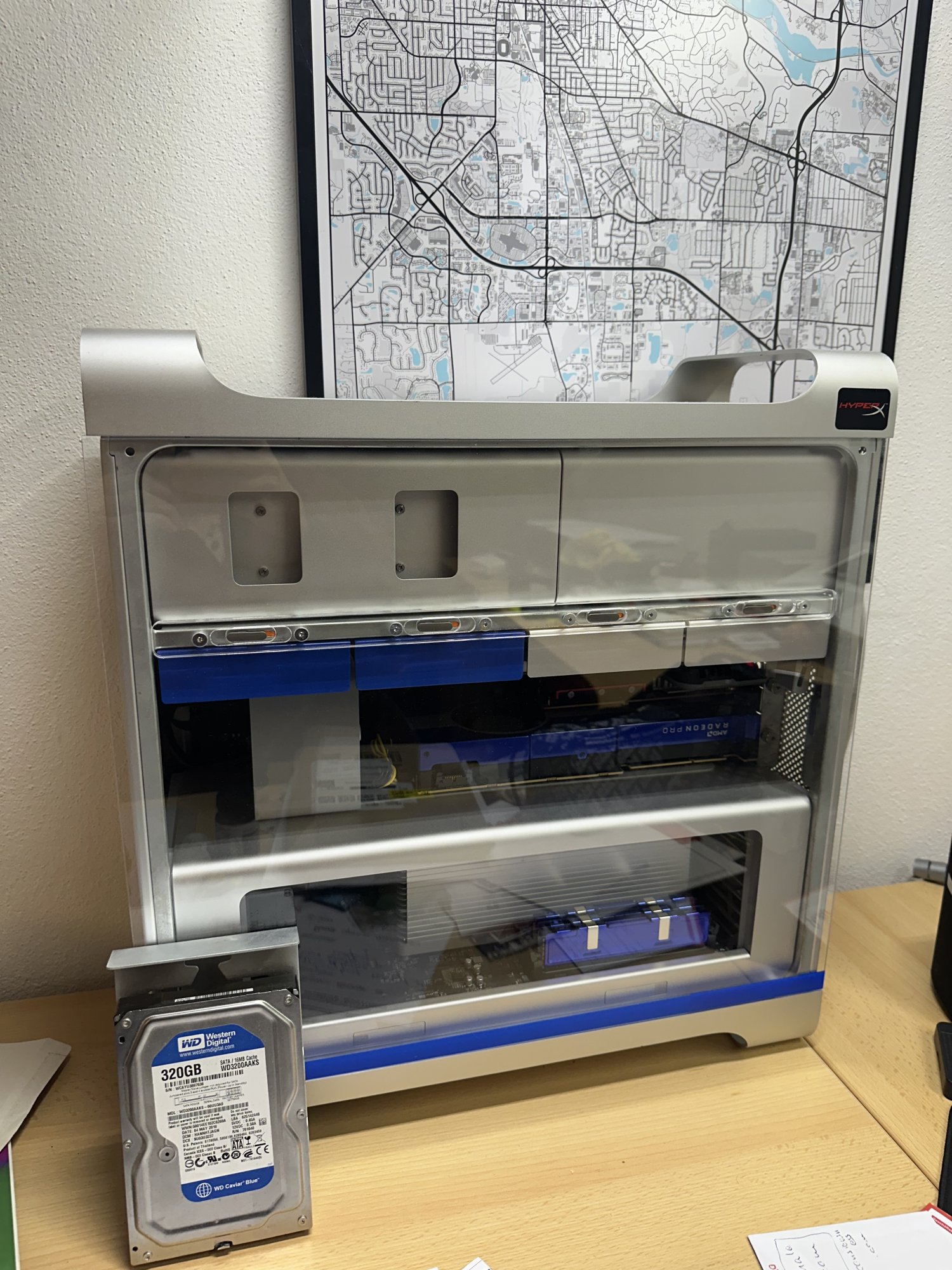

Busy with 2 5.1's , but going good so far.

I am still very happy with my pimped MacPro 5.1. It is on Sonoma right now and works absolutely flawless.
What I could research so far, Sequoia seems to work also very well, however not as flawless as Sonoma.
Could you elaborate on your experience with your two MP5.1 ?
Mine seems to be fine since I have most mods, including USB2.0 mod and updated Wifi & Bluetooth modules as well as Pixlas and a flashed new Vega Pro.
Which Sequoia version works best at the moment? Would you upgrade from Sonoma if you were in my shoes? I have heard the Photos App will make problems on Sequoia? Could you elaborate on your
experience ?
