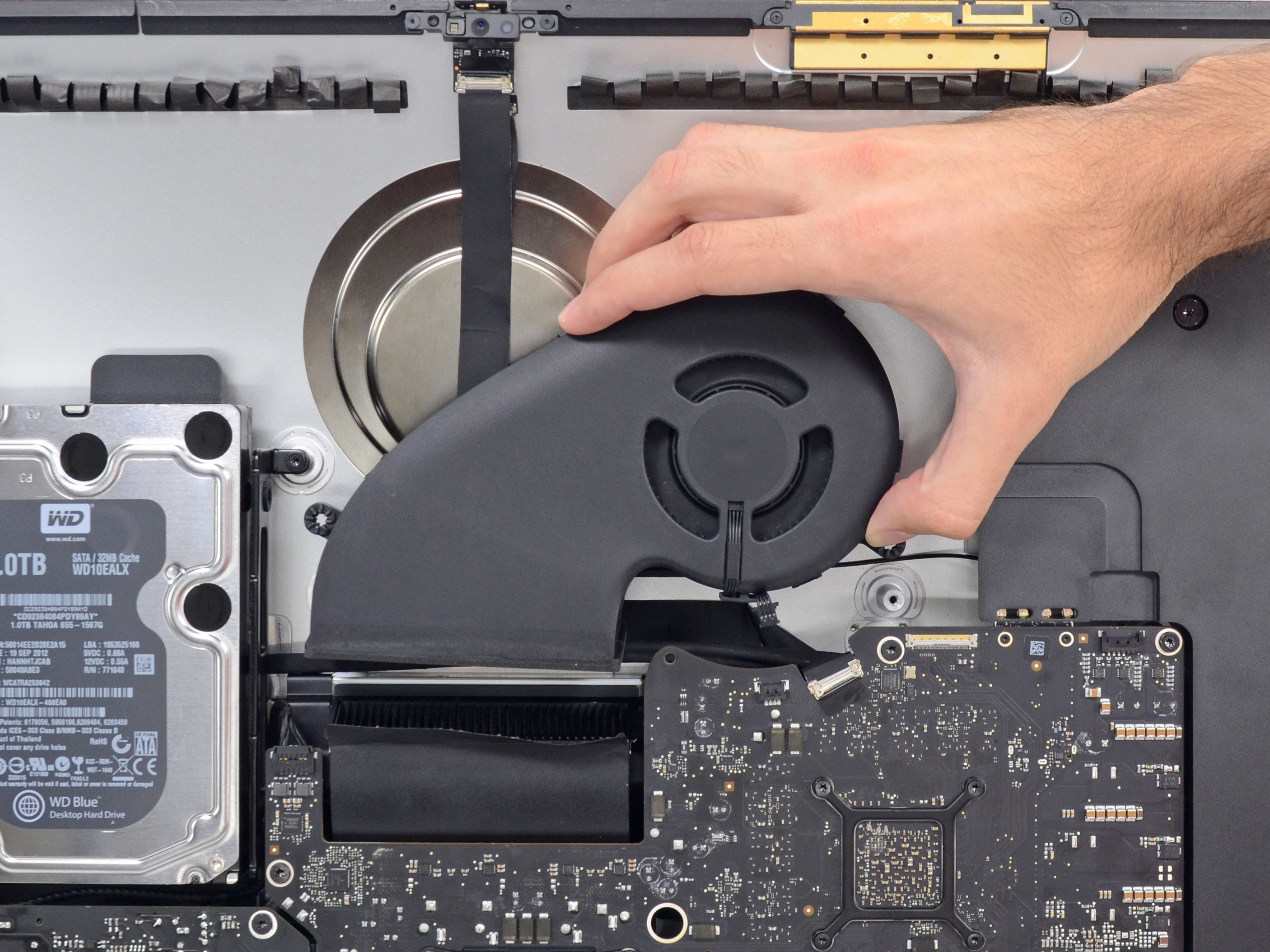

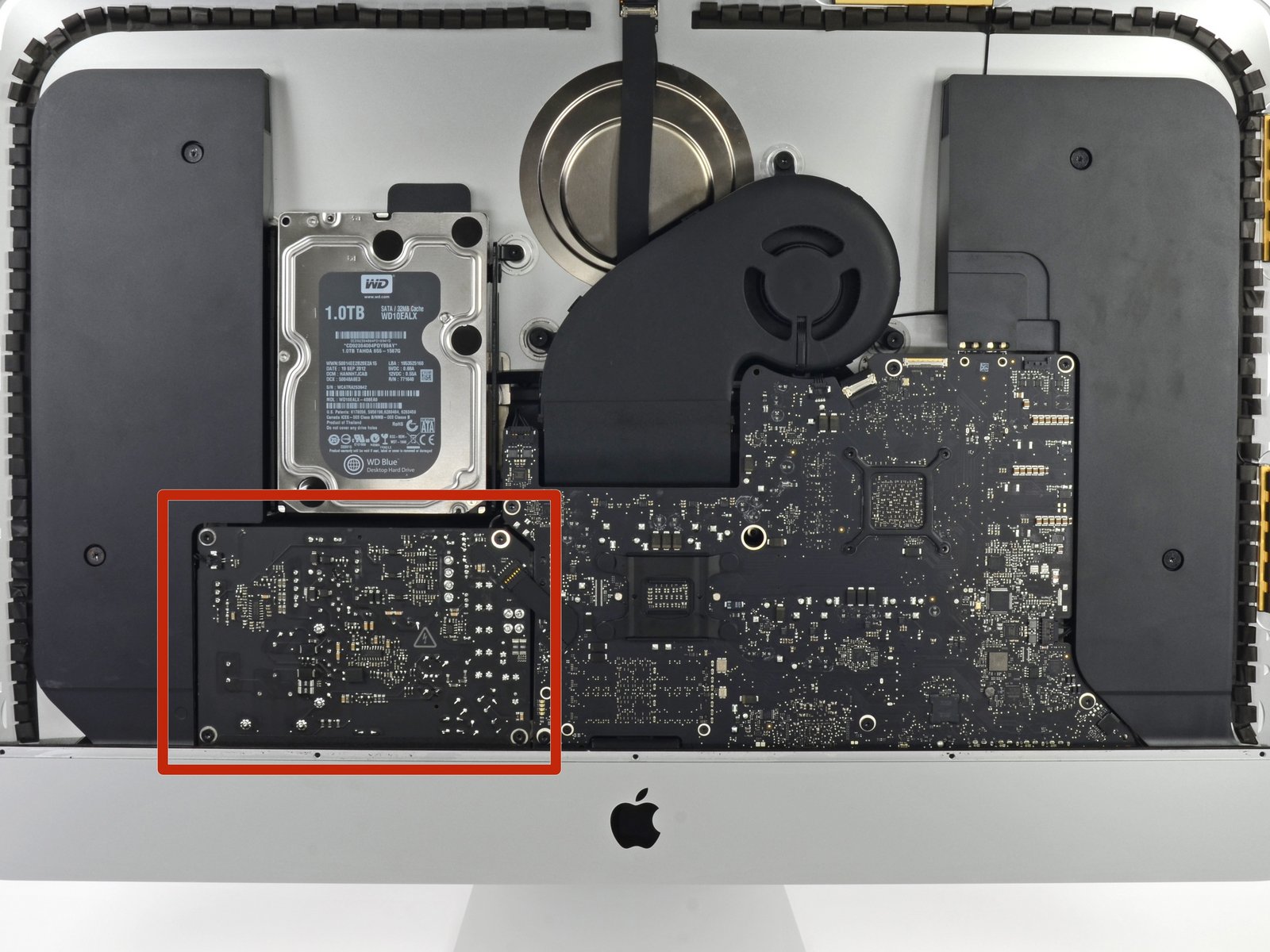

That is a good idea! So do i need to do anything special in order to turn a regular mac into a fusion drive? and I don't know if I can find the space nor an extra connector to fit in an aftermarket 2.5" SSD:
sPFd3RR2FTXWelPg.huge
This first link is just to show that there is very little space inside (I actually don't need to replace the fan):
Here is how to replace the HDD:
Sorry, that wasn't clear enough. Either you get hold of an iMac that was shipped with a fusion drive. With help of this list you can identify which model has an HDD or a Fusion Drive (which is a HDD with a small SSD inside to store the OS and the apps):
Alternatively you can open an HDD iMac as iFixit shows you and install any 2,5" SSD (!). Unfortunately you need to get hold of a set of adhesive tape to put the display back in place.
