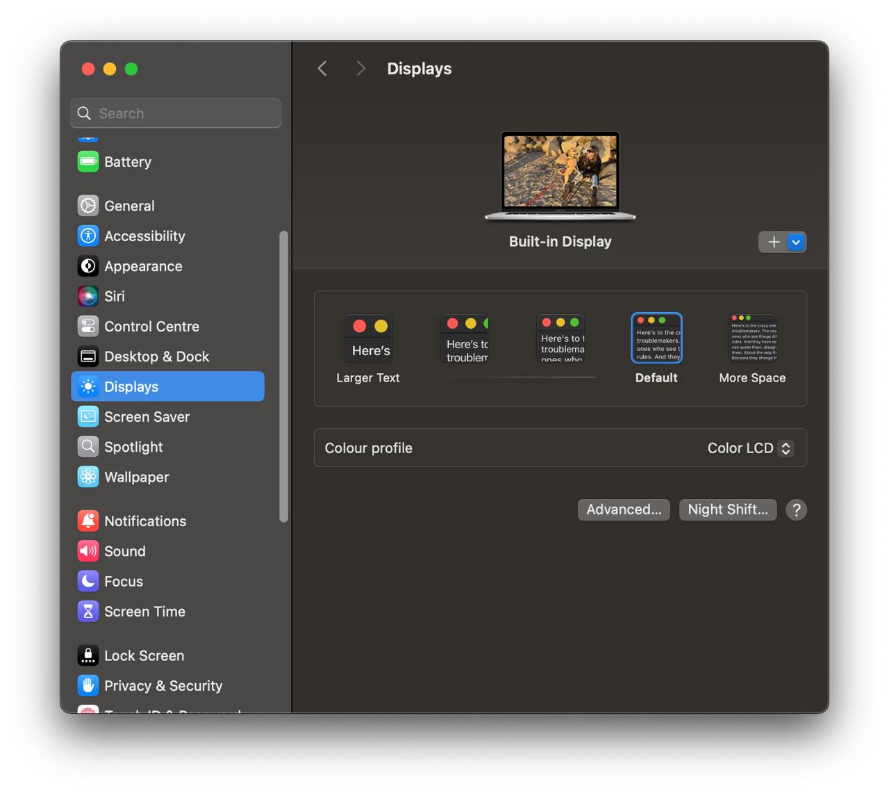

Hi everyone,
I'm setting up an OCLP on MacBookPro13,3 of my friend. It's a base model with Radeon Pro 450 and 16/256.
It was running Monterey. I've installed latest OCLP 2.4.0, ran an OTA upgrade to Sequoia 15.6, and applied root patches (for modern wireless; nothing else was offered).
Everything seems to work ok, but brightness control of internal display doesn't work. Any workarounds?
Thanks!
Update: solved. Had to install the root patches again; it didn't perform AMD graphics and Intel graphics patches during the first run

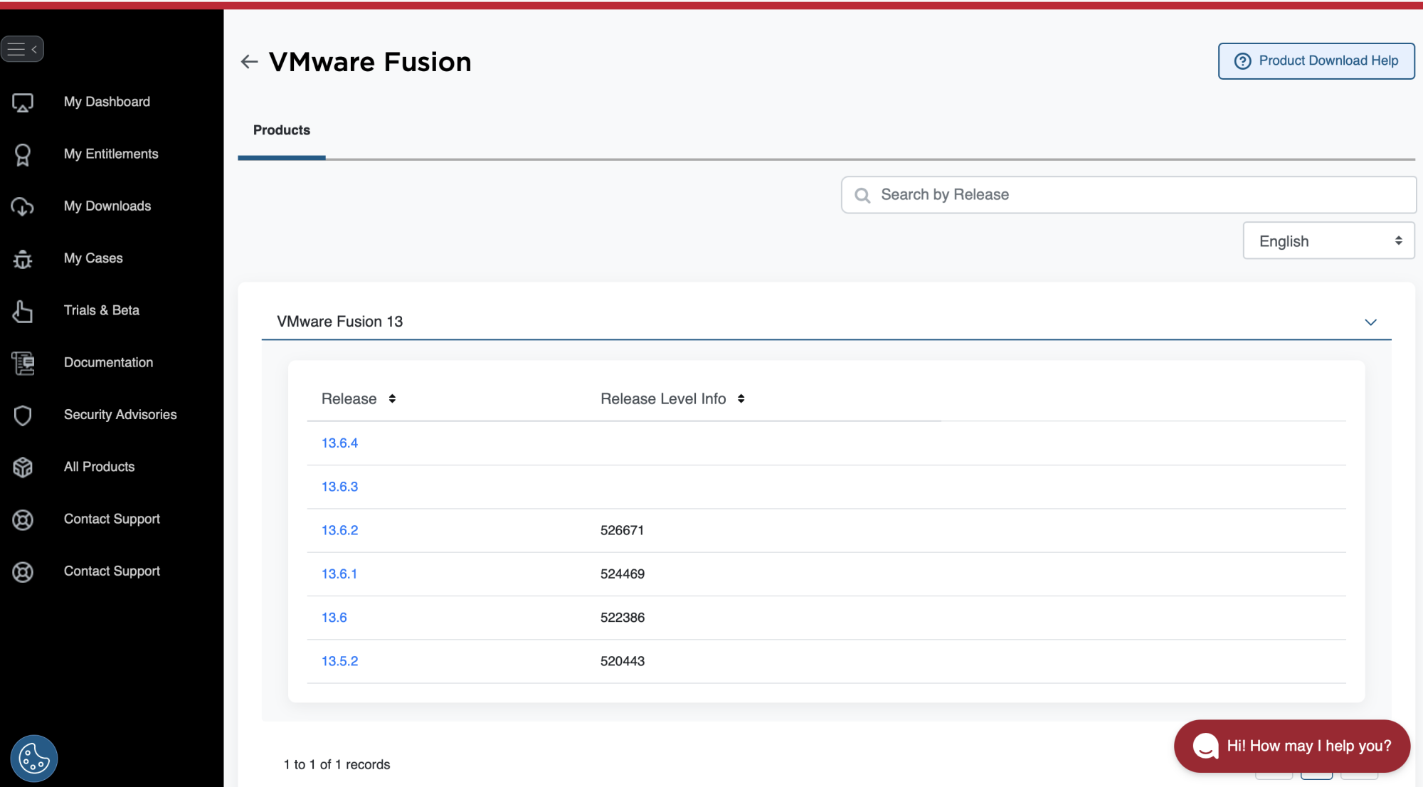

I have an issue I can't seem to find a solution for. Monterey's latest compatible of VMWare Fusion is 13.5.2. However there is a newer version for Ventura and newer. However, on going to Broadcom's site, the fusion download is no longer present. Did they pull it? I'd like to update if possible, but need help finding the download as it's not where it used to be.
Thanks
Nevermind, I missed it the first couple times due to their site layout. I found it and got it.
Thanks
You have to create a Broadcom account or unlock your current account in order to download VMWare Fusion versions.
I migrated my vmware account on the switch, I edited my post to mention I got it. I wasn't looking at the full page of products and forgot there was two columns of products. Sometimes using zoom to read small print blocks the view. So, initially it looked like they had removed fusion. That's why i was a bit confused at first.
Thanks again though 🙂
