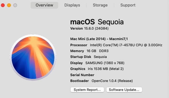

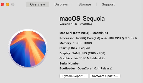

macOS 15.6b4(RC) installed atop 15.6b3 OTA, OCLP v.2.4.0, performs as expected.
b4.jpg:apple:👏

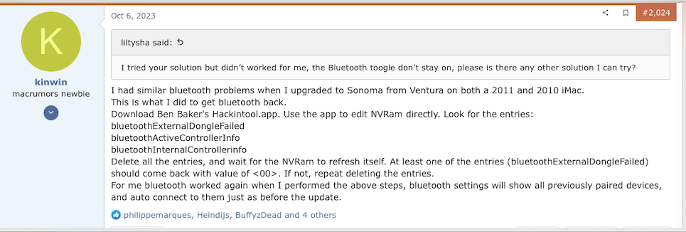

This is from the 'macOS 14 Sonoma on Unsupported Macs Thread', comment # 2024 on page 81. It worked for me in Sonoma.
