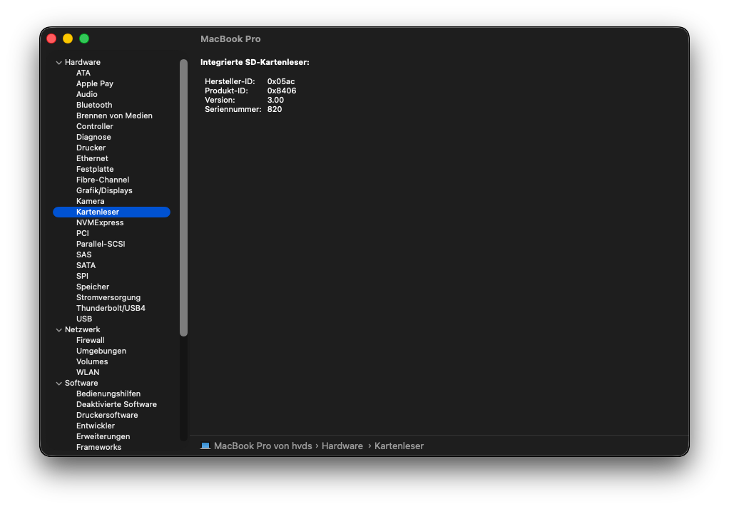

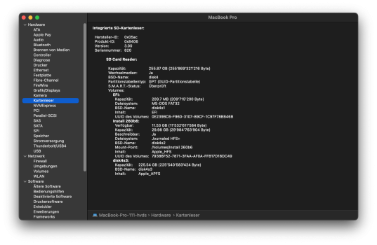

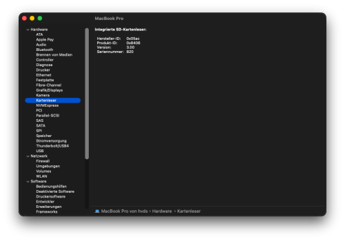

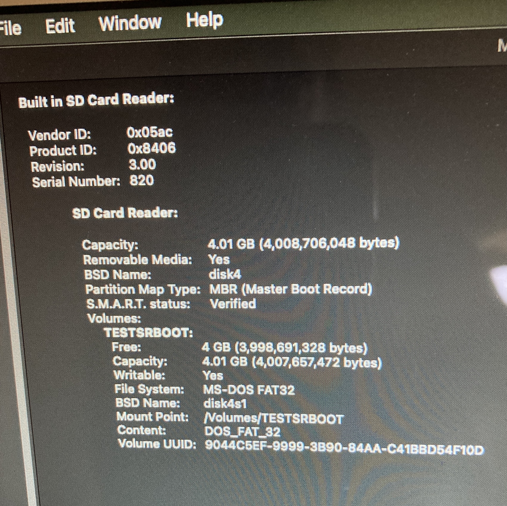

Yes but only as shown below with no Subsystem ID , no Revision, no Link Width and no Link Speed. Looks like a driver is missing.

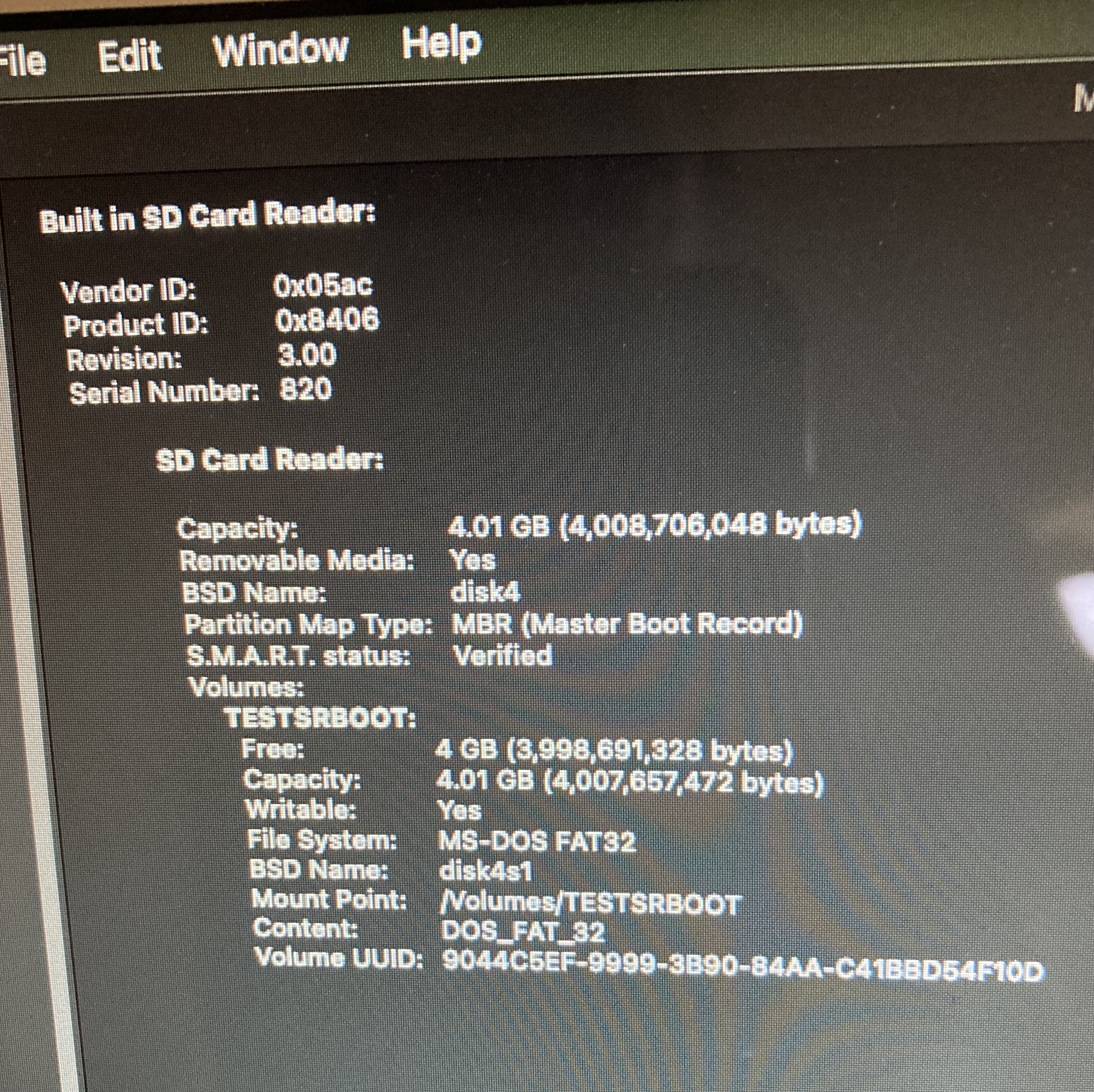

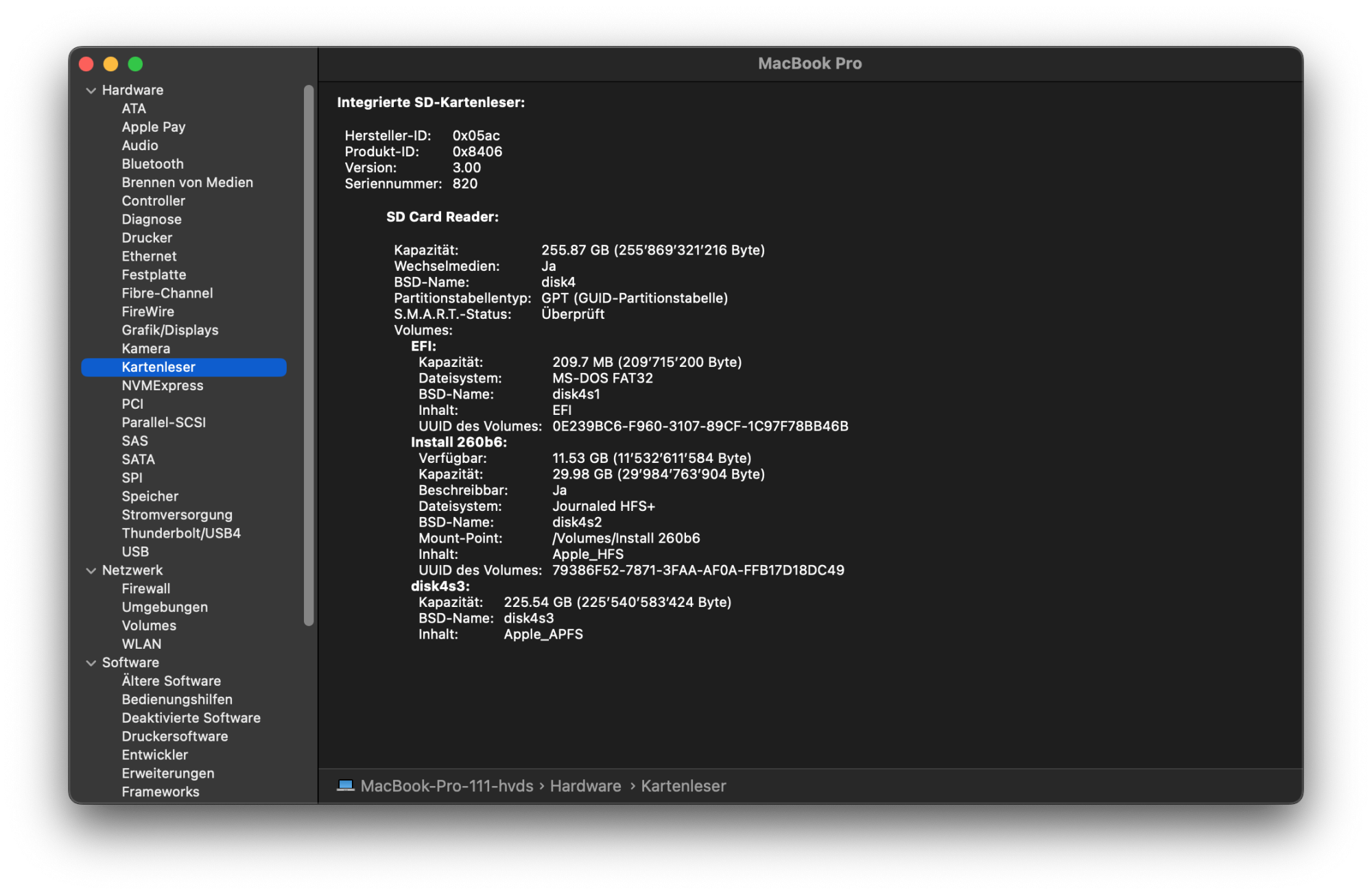

I have exactly the same thing as you in your screenshot. I tested a SanDisk, and it works very well on a MacBook Pro [15-inch, Mid 2014 - OCLP 2.4.0 / Sequoia 15.6].
I haven't tried 15.7 yet...

Could one of the devs look at this and see if some "drivers" have been missed in OCLP for certain models like the 2015 MBA 7,2 and MBP 12,1?

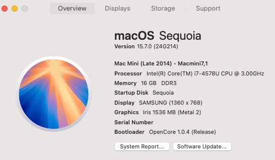

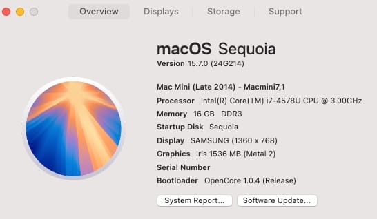

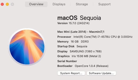

I can report that a Mac Mini 2014 spoofed to 8,1 with OCLP 2.4 and 15.7 DOES have a functioning SD card reader.

Have you tried the card reader under 15.7 with your MBP11,1?

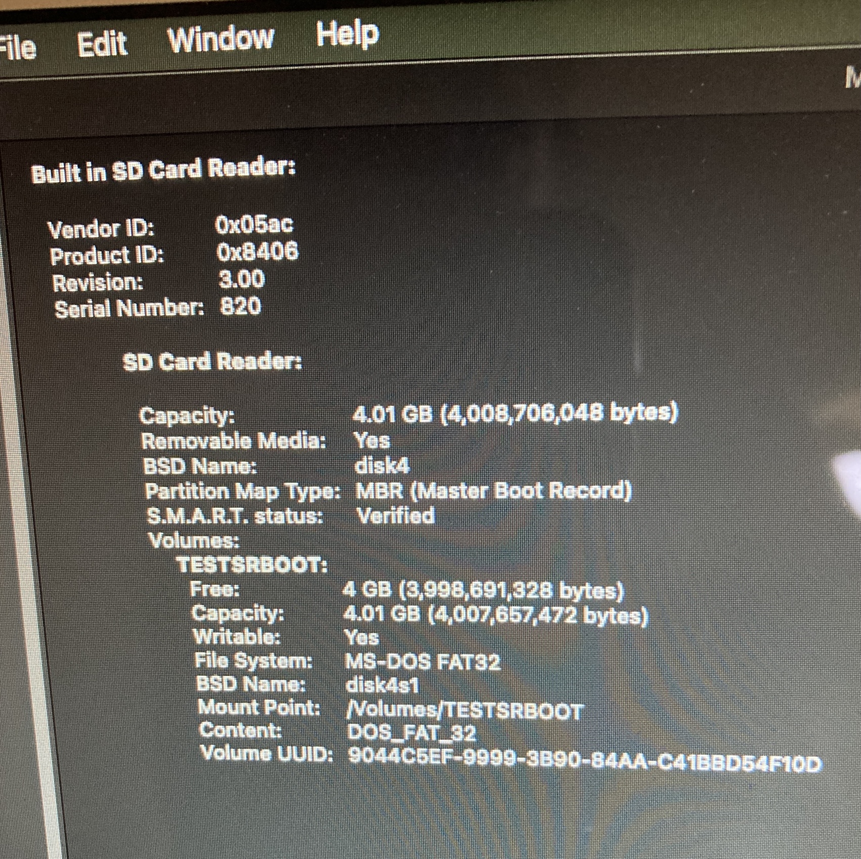

With 15.6, 15.7RC and 26.0b6 I get the same 4-line info from system information as nekton1 had...
I don't have a card with me so can't test further while traveling. Will do later.
Edit: can use the SIM card with 15.6 and 15.7rc, both showing this system info. 26.0b6 apparently can't recognise the card when inserted.

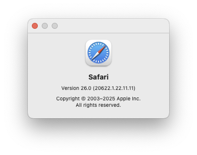

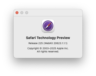

Safari 26 Beta 4:
Compact view bug hasn't been fixed. 😕
I think I read about it at first after Beta 3 in another thread. Was it even there in the first two Betas? I never use compact view.
When you have already installed 26 and rely on compact view, you can update to Beta 4 but you can use the Technology Preview in addition and set it as main browser.
It's the previous version, just a newer Webkit build. Must be 18.6 or was there an 18.7? I updated already in 15.6 to Safari 26 Beta 1 and never saw the original version number. And the TP doesn't show the version anymore, at least not in the about window.
