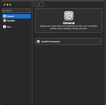

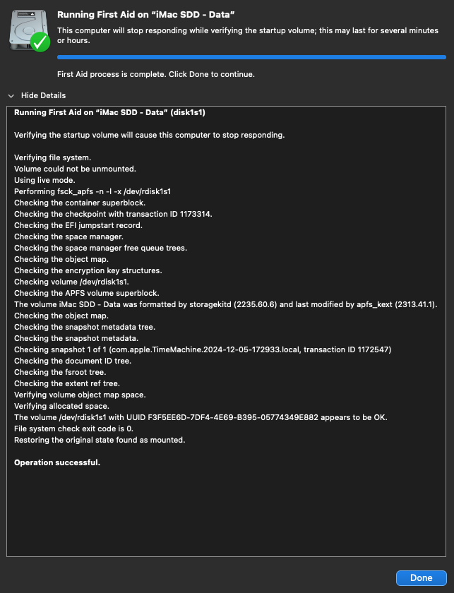

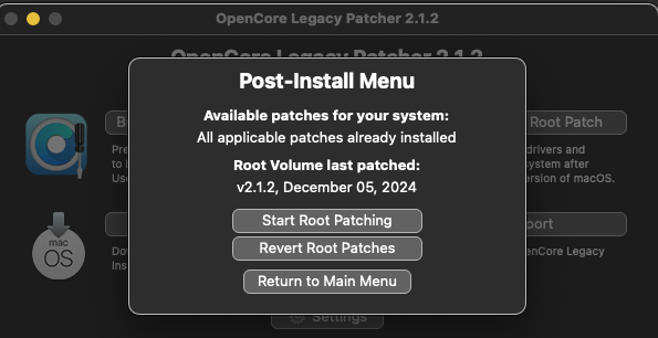

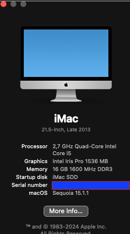

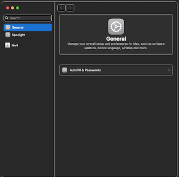

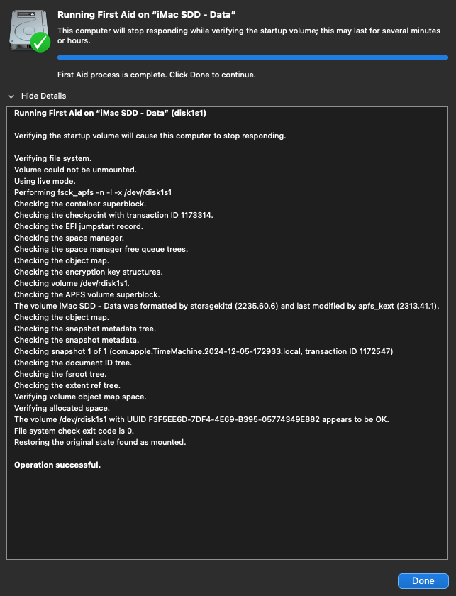

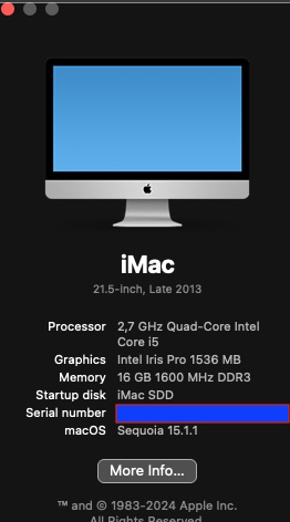

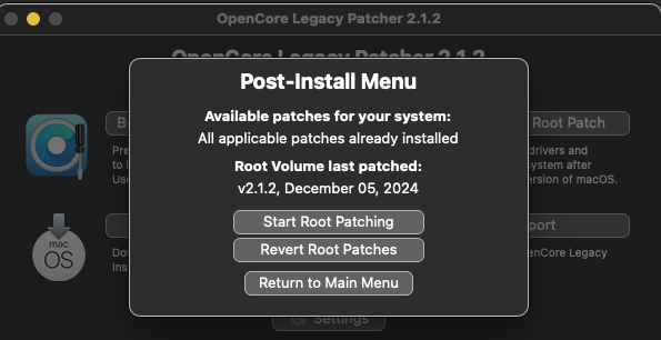

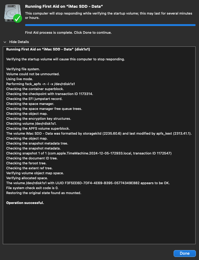

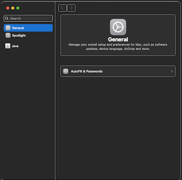

I initially had no issues with Sequoia on my iMac 14,1 (2013), but today, out of nowhere, the desktop icons began flickering. After a reboot, the wallpaper disappeared—along with all system settings. It was impossible to access any system settings whatsoever, and Disk Utility didn’t offer a solution either. Despite this, everything else seemed to work normally.
In the end, I had to reinstall Sequoia through recovery mode. Now, it’s a matter of waiting to see if the reinstallation resolves the issue or if I’ll need to downgrade back to Sonoma.
And it didn't help..... the wallpaper is still missing as well as the systemsettings...
Any ideas?
