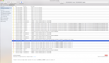

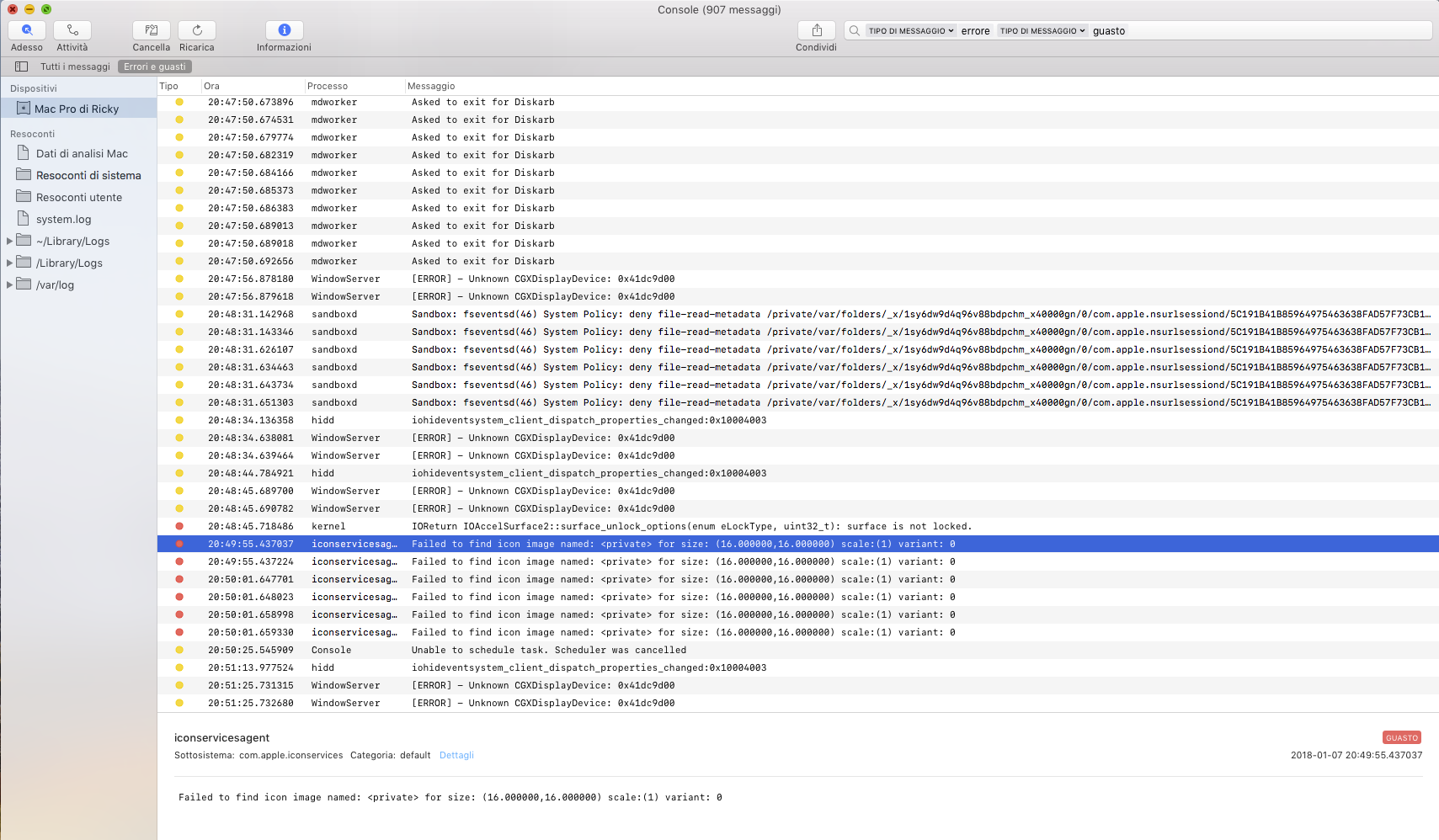

I've done what suggested... These are the steps until now:
1) removed from pci-e 4 caldigit FASTA-6GU3 Plus ---> Still issues
2) removed from pci-e 3 sonnet Allegro USB3 ---> Still issues
3) removed from pci-e 1&2 the 2 Nvidia 4000 and installed a Radeon HD4870 ---> Issues gone.
So I checked the console for errors and I've got a bunch (see image).
There are still problems, for example a simple Safari page is not working
and also if I install Firefox it doesn't work (installs but no browsing).
I tried to see what happened if I put again one by one the cards,
so I started with 1 Nvidia, then the other one...
The kicking out to the logging window was gone!!!
BUT... as soon as I connect again all my 3 monitors
(so adding the other 2 to the main one),
here it comes the kicking again...
Ideas?

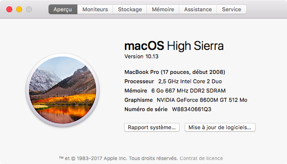

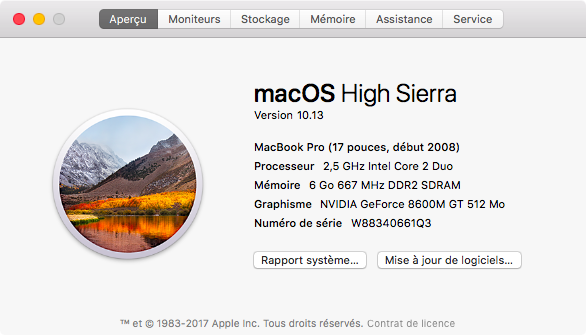

Hi guy's ! I have upgraded my MBP 17' Early 2008.
With an SSD and a macbook mid-2009 Airport card to make the Wifi work.
Now i was wondering :
is there a fix for the brightness control that doesn't work ?
Is that normal that the computer became very hot while doing basic things ?
Thanks you !
Thanks you !
Try to reapply the post-install script from @dosdude1 utility booting from the usb drive. That brought back the functionality on my MBP.
