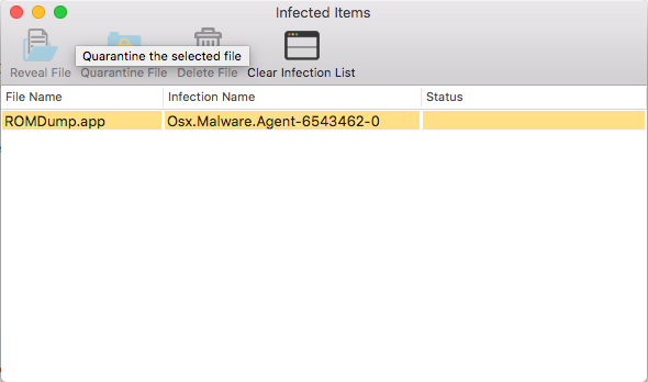

[doublepost=1527468565][/doublepost]Hi dosdude1,
When I downloaded the firmware dumper, I got this screen pop-up from ClamXav reporting that it is infected with malware. I hope it is a false positive!

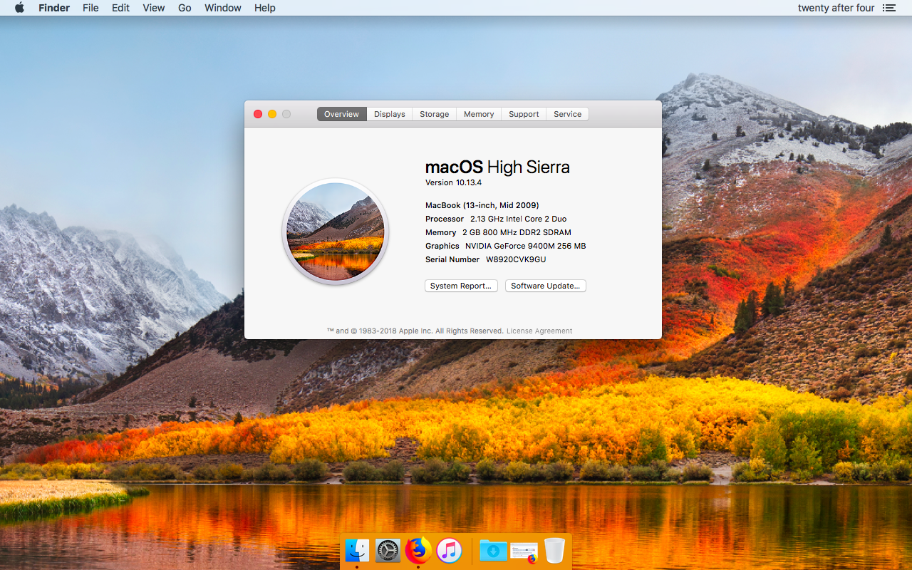

This will probably come across as yet another "me too" post, but I spent some time this weekend installing High Sierra on a freebie Mid-2009 Macbook. Mostly just to see if I could do it.
Not only was I impressed with how easy it was, I'm also blown away with how good the performance is. It lags a little while at startup, but it seems like the longer I use it, the faster it gets. Current versions of most apps seem to outperform their counterparts on my 5,2 iMac running older versions on Snow Leopard. And that's just with the stock hard drive and 2 gigs of RAM. It will be interesting to see how much of a boost it gets from an additional 2 gigs of ram and a nice new SSD.
So far, the only thing I can't get to work is the iSight. The keyboard function keys are all working fine. Brightnes, volumes, iTunes controls all work.
I sure wish I could get this kit running on my iMac. I always thought a 5,2 iMac and a 5,2 Macbook were virtually identical, but I guess not.
Cheers to all who expended efforts to make this work so well. (Donations forthcoming!)
