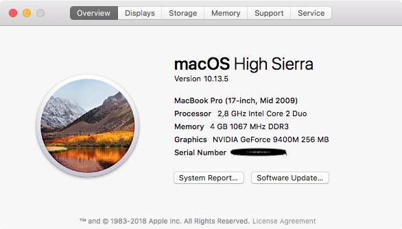

Hi, just upgraded my macbookpro 5,2 from 10.13.1 to 10.13.5 successfully
my steps :
1. clean install 10.13.1
2. upgrade from appstore

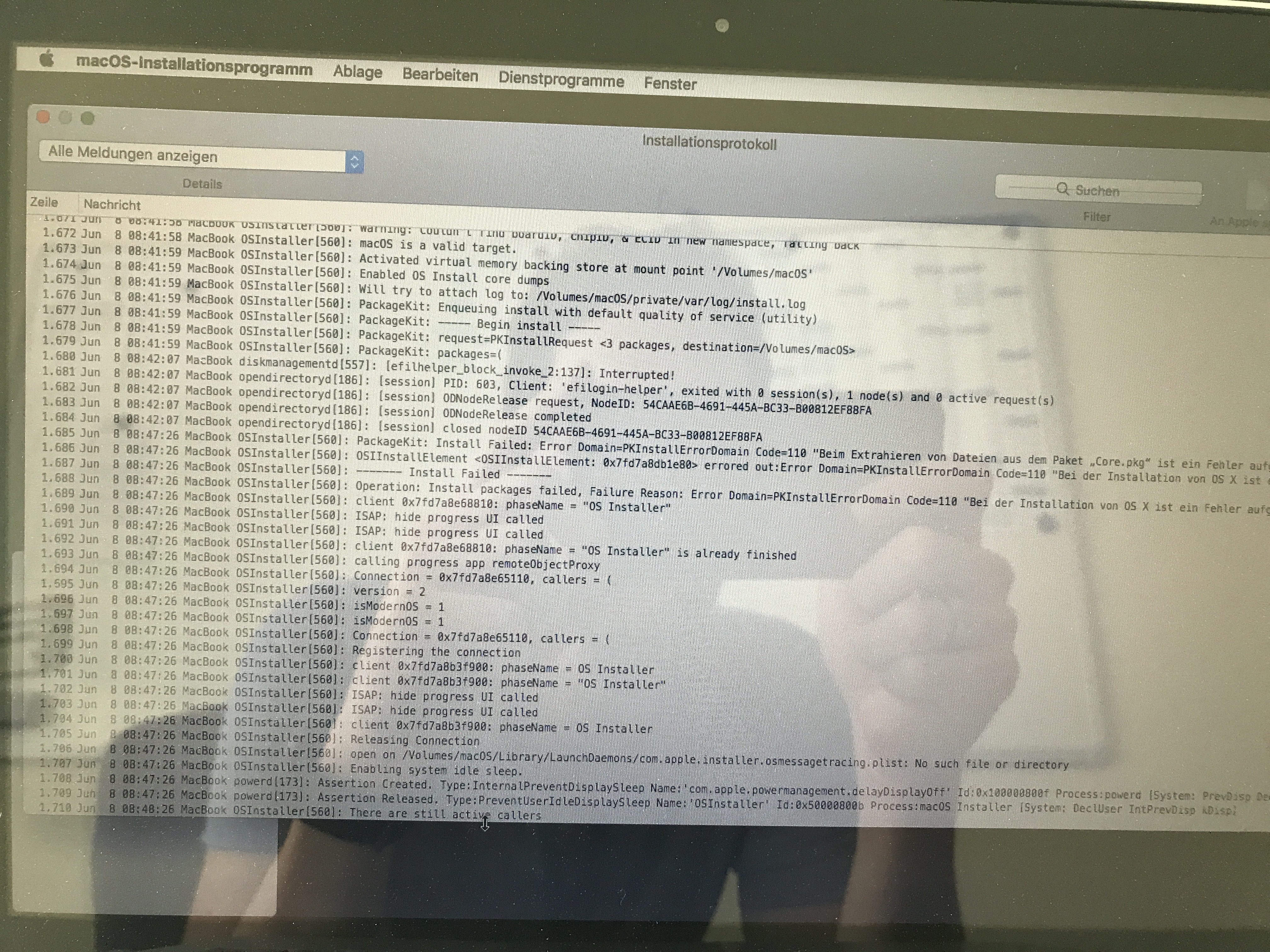

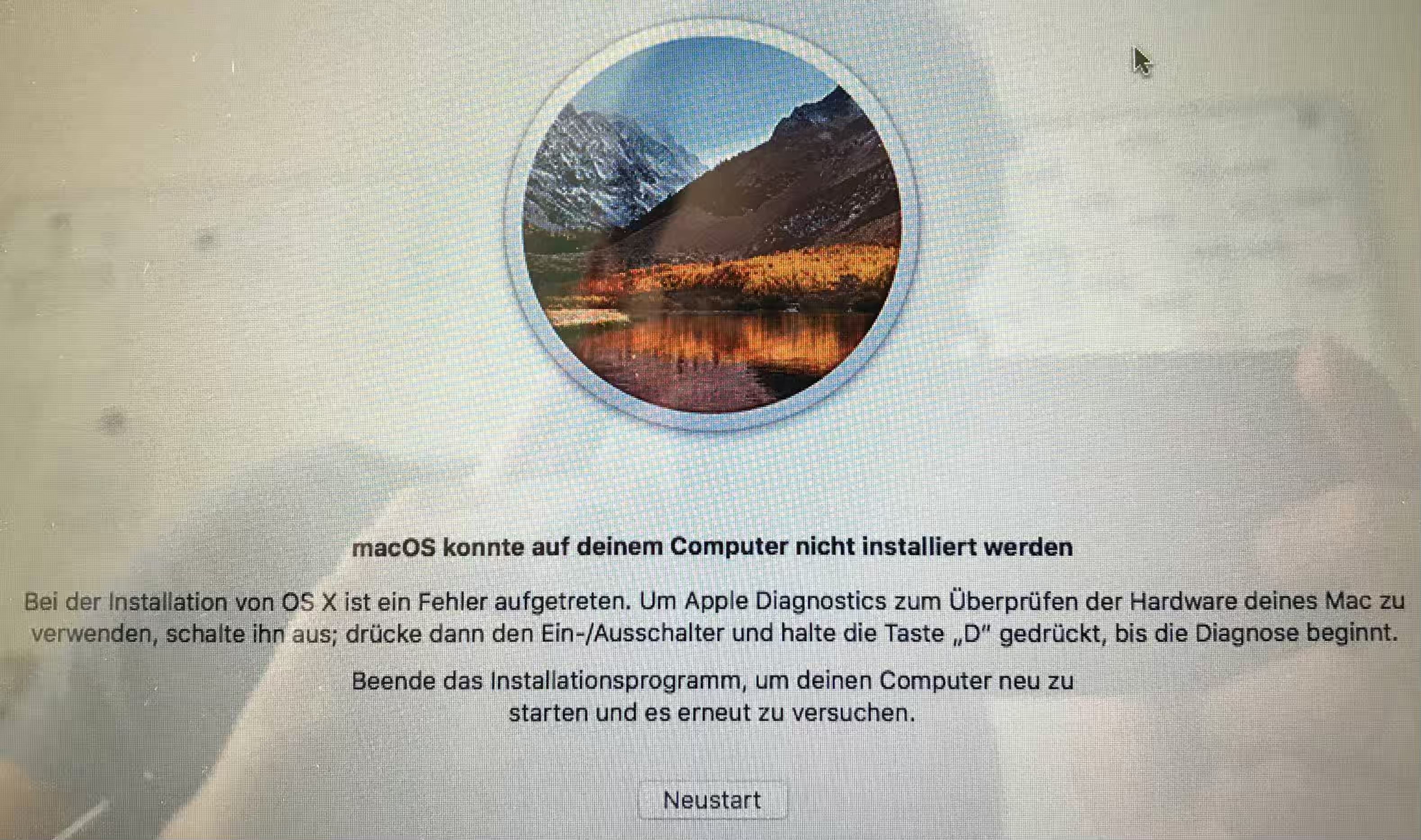

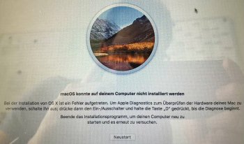

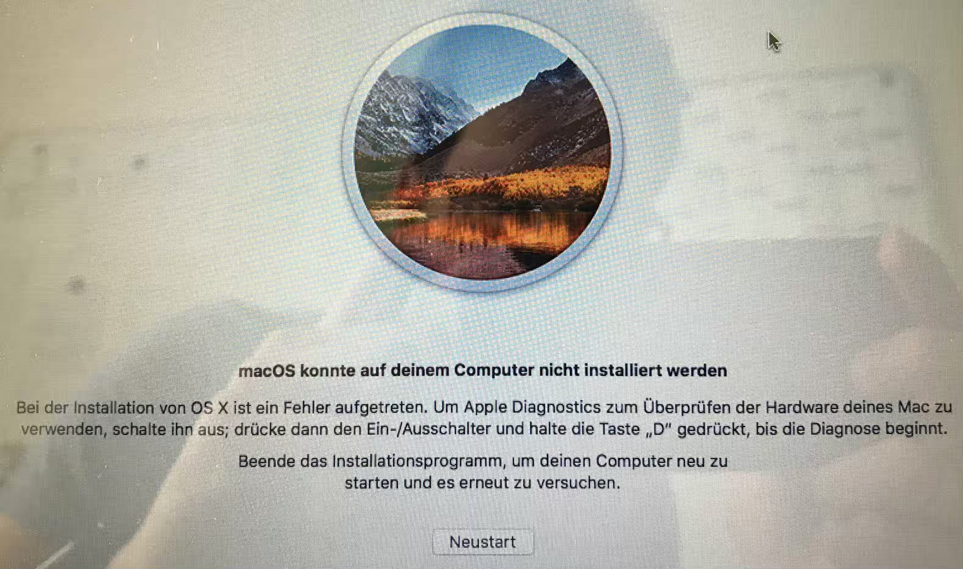

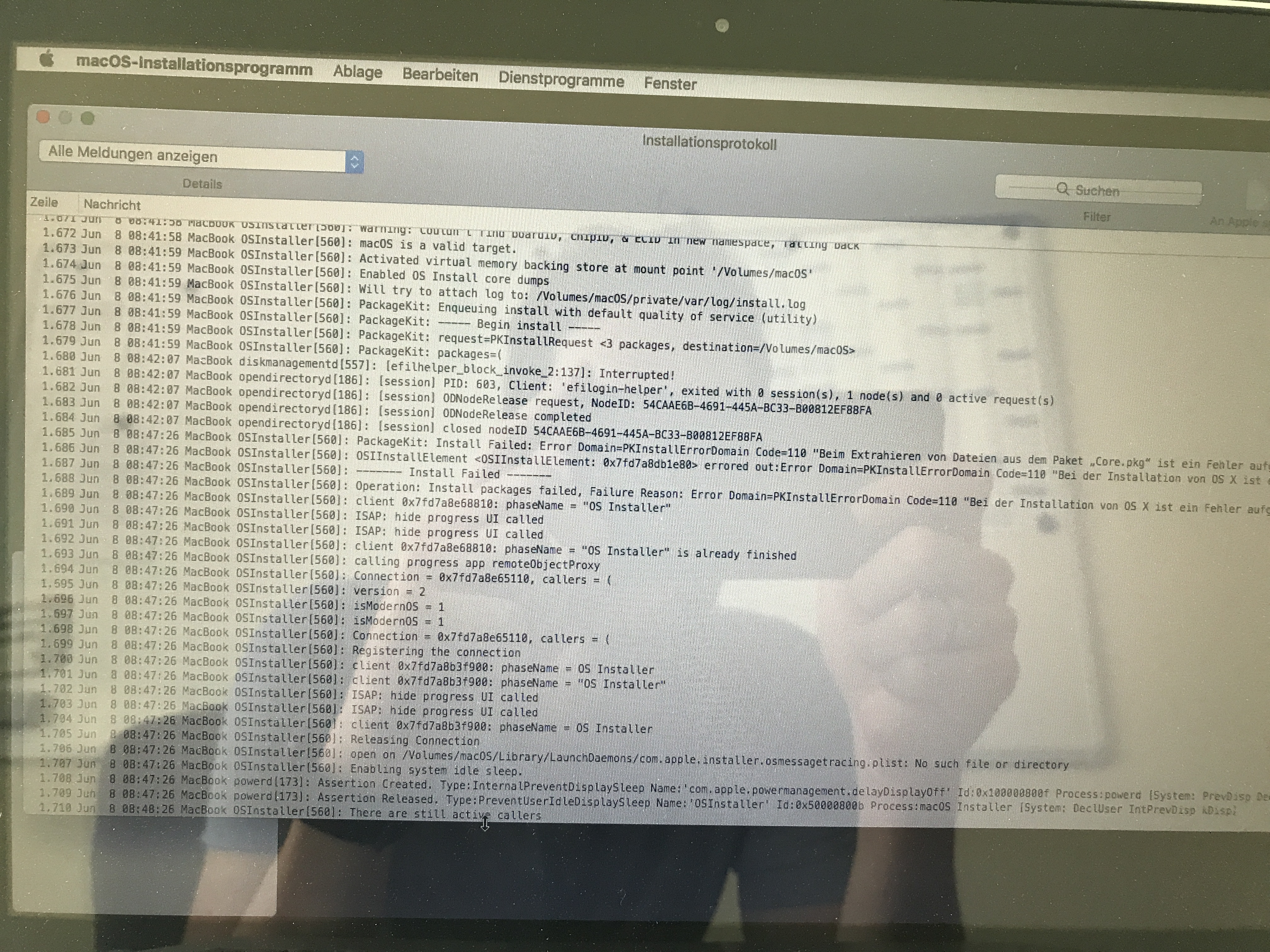

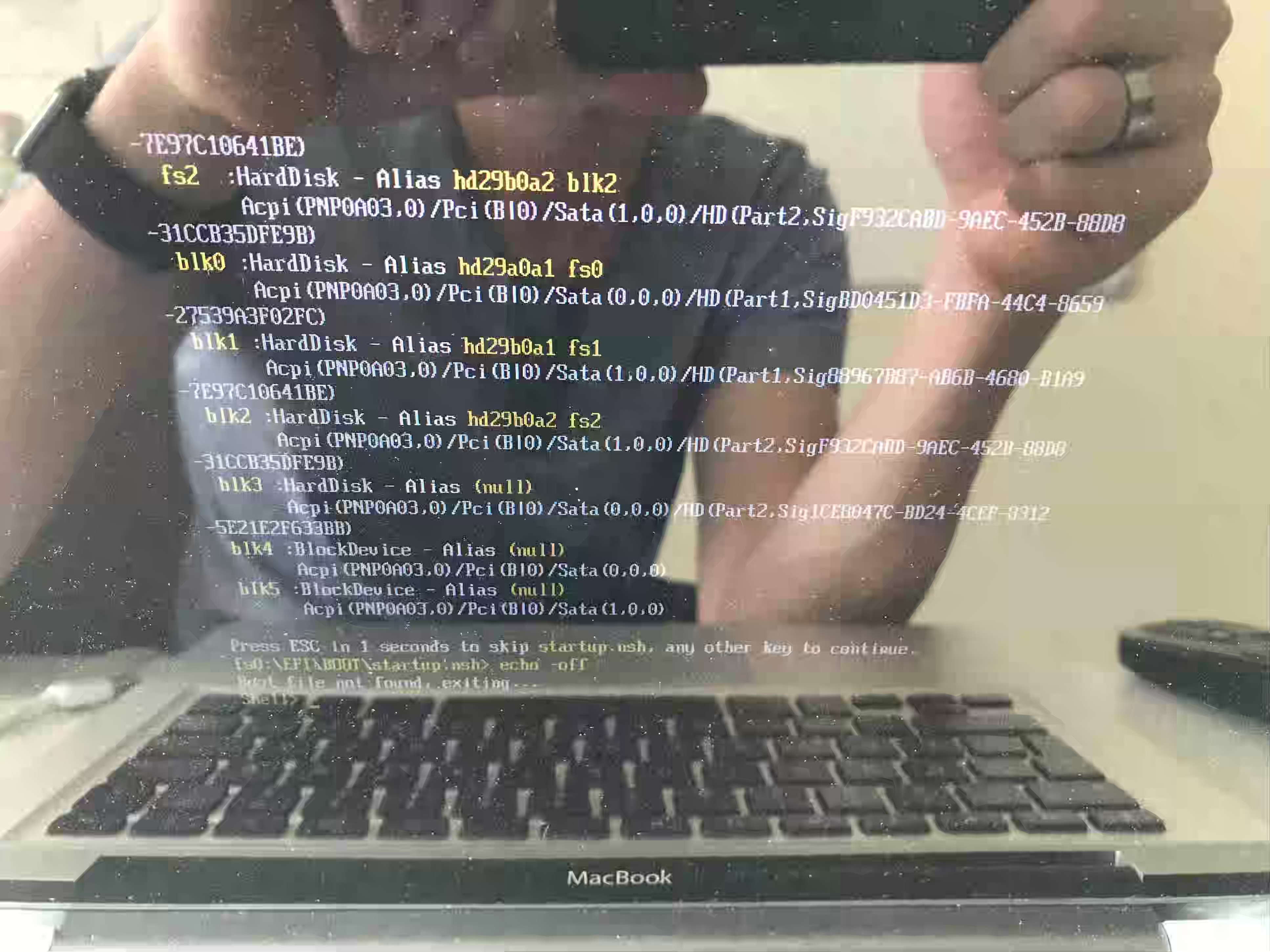

I loaded the latest version of the patcher. HS downloaded via the patcher. usb stick on formatted according to instructions. extented jornaled. patcher opened. install app verified, and copy to the stick. booted to the boot menu and ran "csrutil disable". then into the boot menu of the HS usb stick. Installation started but without success
I tried again. without success. the post install does not work, because he found on the ssd no installed macos version.
You'd better format SSD to APFS before installation
Thanks for the tip. I have, without success. (same error message)
[doublepost=1528447040][/doublepost]:-( fail
