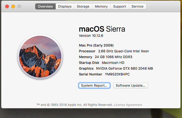

Oaky, I just grabbed a fresh copy of your tool and created a fresh thumbdrive for the HS install on my late 2009 macPro (4.1 flashed to 5.1 in mid-2017). So - when I get some time [prob Sunday afternoon] I'll try again.
I bought a flashed Geforce GTX680 earlier this week when I heard it was important for metal and mojave. Installed it around 2PM today - WOW, I can tell its a significant jump in system performance!
Thanks so much for your help - trust me - this is a pain - its been failing since I started trying back in the HS Beta era!
Oh - should I wipe the macOS Install data folder?? maybe its got some details from crashed installs that are hobbling this upgrade?
