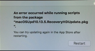

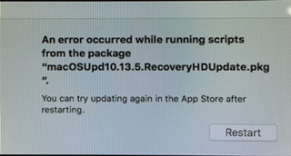

After about a week of indecision, the other day I made the update to 10.13.5 on my Mac mini (Late 2009) from the Mac App Store.
Same as for other users of this forum, it stopped when about 2 minutes were left and after a while the screen became completely black with only the mouse pointer active on the screen and nothing more and, after waiting a few more minutes, I was forced to reboot. (We hope that nothing happened to the hardware, my High Sierra is installed on external USB disk).
In the log file at the time the screen became all black, the message related to the failed update of Recovery HD appeared.
After a forced reboot (longer than usual) the system has resumed functioning, in the info is shown version 10.13.5 and in the Mac App Store there is no trace of the update. It seems to work normally, maybe it's just a little slower than usual.
Yet even in previous updates from 10.13.3 to 10.13.4 and the Security Update 2018-001 there was an update of the Recovery HD but they have been regularly performed and there was no blockage. (After the reboot following the update from 10.13.3 to 10.13.4, an error message related to the "Preboot" appeared)
Now I wonder who knows what will happen next update to 10.13.6?

So I tried updating to 10.13.5 on a MBP 5,4 using the App Store. Failed with a package script error (forgot to take a picture). It now hangs while trying to boot (progress bar shows halfway).
Downloading the patcher tool now to reinstall. Fingers crossed.
EDIT: Getting the following error message in /var/log/install.log
Code:
2018-06-09 13:48:50-07 MacBook-Pro softwareupdated[516]: Can't instantiate distribution from https://swdist.apple.com/content/downloads/01/30/031-12297/85qy2o6zqm59iottqp9qepht7wz0dvgc4z/031-12297.English.dist: Error Domain=NSXMLParserErrorDomain Code=76 "Line 390: Opening and ending tag mismatch: installer-gui-script line 2 and choice
    " UserInfo={NSLocalizedDescription=Line 390: Opening and ending tag mismatch: installer-gui-script line 2 and choice

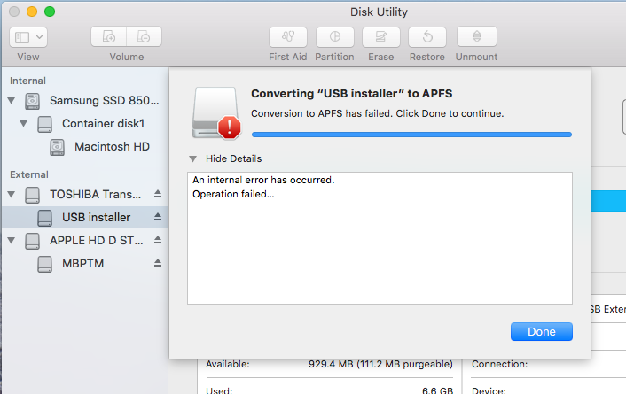

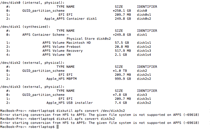

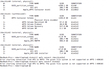

Humor me—when building the dosdude1 patched USB installer, is there some way to convert the USB HFS+ partition to APFS?
When I try using DU, I get this error but perhaps there is a command from the CL?
When I try from CL, I get this error.
