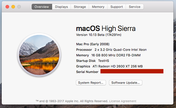

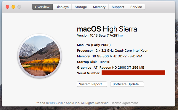

I've been trying dosdude's and foxlet's methods to boot a cMP3,1 with non-standard GPUs into HS beta 2 upgrade 1. In both cases with either an RX460 or a Mac rom flashed HD6870 (both of which work fine under Sierra), the boot process stalls as the GPU drivers load. I rooted out an old Mac HD2600 XT that came in a 2008 MP and put that in after removing the RX460 or HD6870. Result was HS booted up fine (see screen).
And as a final test, I tried using the HD2600 XT as a helper for the RX460 (straight PC card that boots in Sierra but with no efi screen) and got the same spinner towards the end of the boot progress bar. For completeness, I repeated over with the HD2600 XT and the Mac-rom-flashed HD6870 that also works fine in Sierra and saw the same spinner towards the end of the boot progress bar.
Conclusion, the HS GPU drivers are still immature for non-standard GPU cards in the cMP.
With only the HD2600XT installed, the MacPro 3,1 boots straight into HS no problem and everything (BT 4.0 from iMac, USB3, sound, etc.) seems fine.
This is not an APFS install—I'll wait for later betas before playing with that.View attachment 707306
Yep, I suspected that GPU driver could be the culprit by looking at verbose mode login messages, but I didn't have the stock GPU to test as you did.
Good to know that this probably will be fixed in future betas, though.
See ya

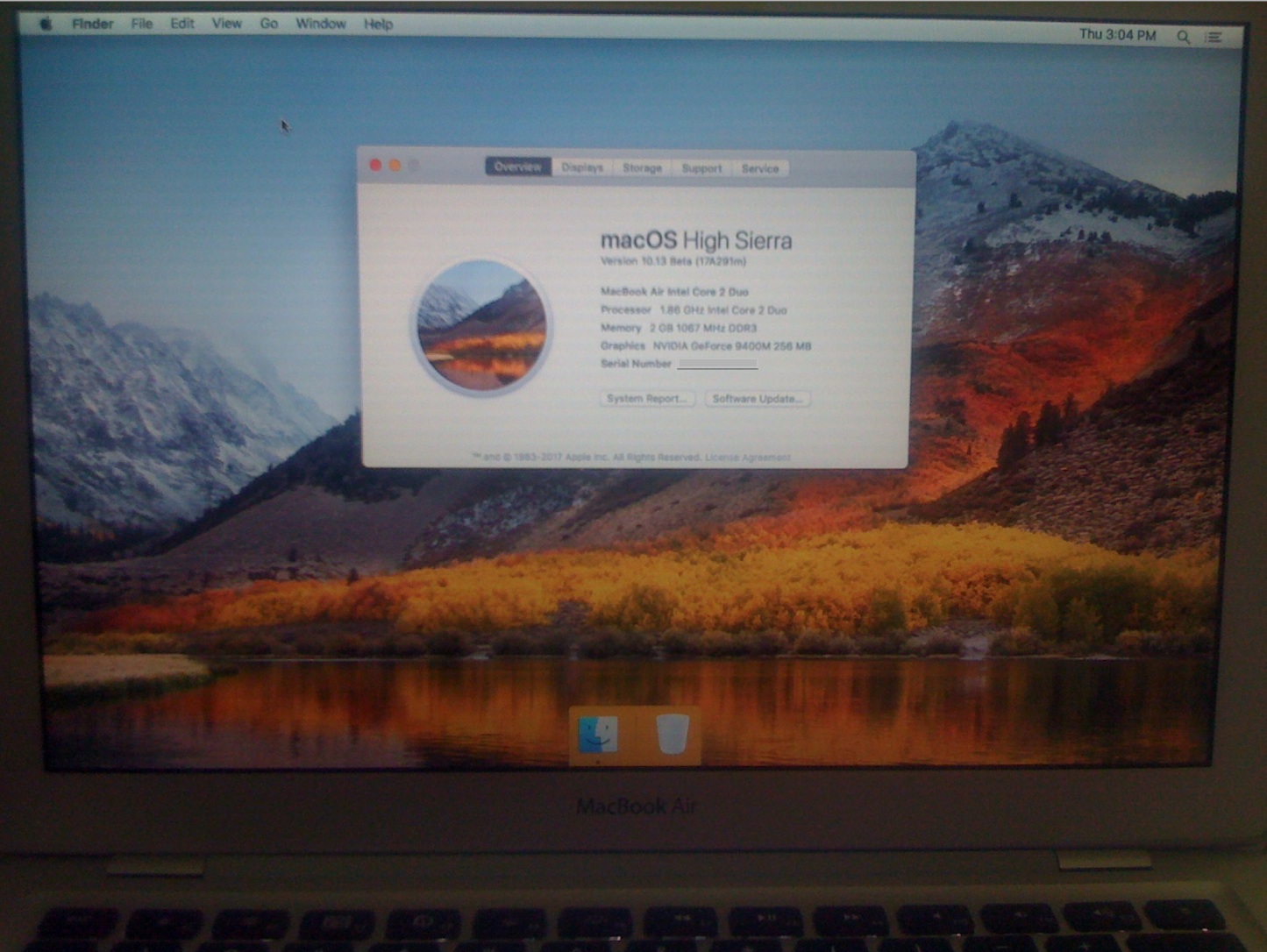

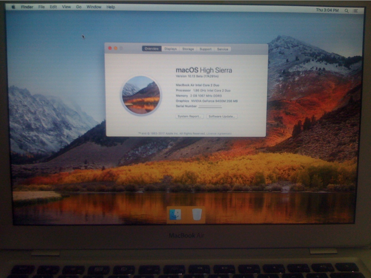

Build 17A291m (Public Beta 1) on a MacBookAir2,1
With news that Devoloper Beta 3 released today, and Public Beta 2 being suggested as soon to follow
, I reckoned I would document my experience with Public Beta 1 Build 17A291m, if only to warn off anybody else considering putting that beta-ish build on a low-powered MacBookAir.

The first install probably worked. I just didn't realize at the time that one of the hangs I thought it was experiencing was actually just super-slowness, and I powerbutton-forced a shut down.
Laggy Initial Setup
I did a clean install the second time. Many screens in the initial first-boot setup sequence were laggy.
Keyboard Bug
The keyboard worked fine to type in the username and password when on that particular setup screen. But several screens later, after all the setup screens were completed and it was time to finally login, the keyboard wouldn't work to type inside the password text box. I jimmied it loose by clicking on the "Carriage Return" arrow, and
was able to click back in the text box and actually type stuff in.
More Lagging
Once logged in, just about every mouse click involved a lag - many of them very long lags - before action completion. Talking simple stuff like:
- Opening up System Profiler
- Clicking on the Spotlight icon
- Popping open a new Finder window
Wonky Mounting?
When I inserted a USB thumbdrive, I could see its presence in the USB section of the System Profiler, but Desktop/Sidebar would not show it mounted. Even /Volumes did not show it. Another time after another boot, it did appear in the Desktop/Sidebar.
Maybe Next Time
The app compatibility testing I hoped to do will have to wait for a future release. This build on this machine is unusable.

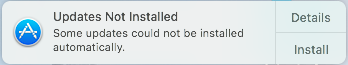

I tried to Install the macOS High Sierra Public Beta 2 update, and I get this error.
Yes, the software update currently is not functional on non supported machines. Only manual installation works (yet). You can download the update files (prehaps, is alredy done), with the productbuild command, you can convert it to isntallable package and install it with the installer command from terminal.
