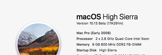

Just this morning installed the High Sierra public beta on my MacPro3,1.
The installation was painless, albeit slowww!
Used dosdudes patching system, and many thanks to the author.
So far after several hours it appears to behaving very nicely.
Time will tell...
What GPU in the MacPro 3,1?
Also, what version of 10.13—this morning's beta 4 release or something earlier?

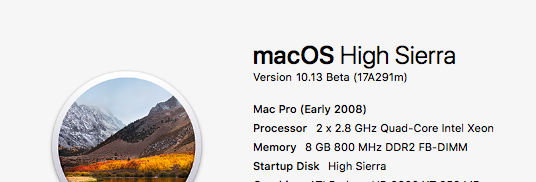

Time will tell...
dosdudes system patch which is still at public beta1, I and I'm sure there are others are looking forward
to anything newer that dosdude is working on.

What GPU—cannot see it in that screenshot.
[doublepost=1500958973][/doublepost]FYI, the beta 4 update killed my beta 3 on a MacPro 3,1 this morning. Got to 18 minutes remaining before the end, where it stuck for an hour. I gave up waiting and restarted and the install was borked. Had to reformat and start over.
Right now just the stock ATI Radeon HD 2600 XT, I also use an ATI Radeon HD 5770 but pulled it this morning while doing some comparative tests.
