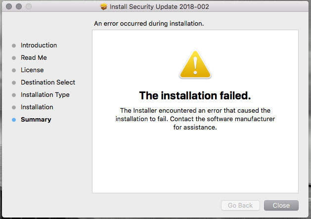

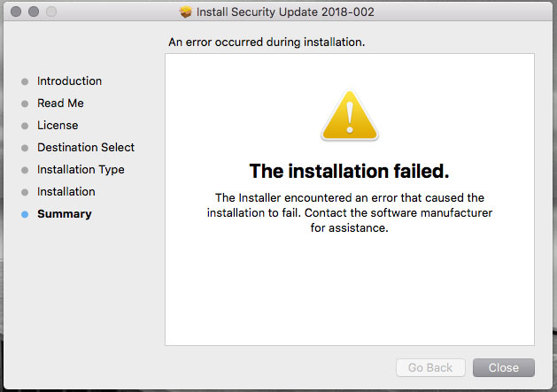

Following the described procedure, on a MacPro3,1 running 10.13.6, the stand alone installation starts out fine but ends with an "installation failed" message. There are a number of separate updates in this package, but it's unclear which one fails.
L Caputo, I restored from backup again back to 17G65. I then did the manual update instead of the automatic one from the App Store. Unfortunately, there was an error with this method also(See below). I checked the installation log and it doesn't show there.
MacPro 3,1
Yes this has been covered a lot in these pages it is the Recovery HD update that fails, all other aspects of the update should have been installed though. To check it has been installed About This Mac> System Report> Software > Installations, click Install Update twice to see the list as most recent first.
MacPro 3,1
See above.

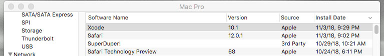

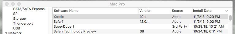

The update does not show up in the Installations(see below).

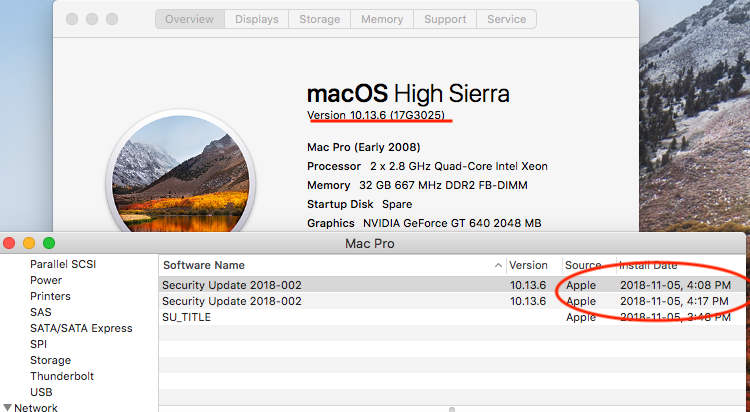

Yep you are right, okay so if the Security Update does not show up in the App Store Updates page then it means it has (probably) installed.
Also check the build number of your OS, click on About This Mac and Control-click on the text 'Version 10.13.6'
the build number should show up in brackets, if it has updated it should read (17G3025).
Alternatively you can read your Install log, whilst in Finder click on Go , then Go To Folder and type in
/private/var/log scroll down to install.log, you can view this in quicklook but be prepared it is a lot of reading unless you know the approximate time you ran the installation.

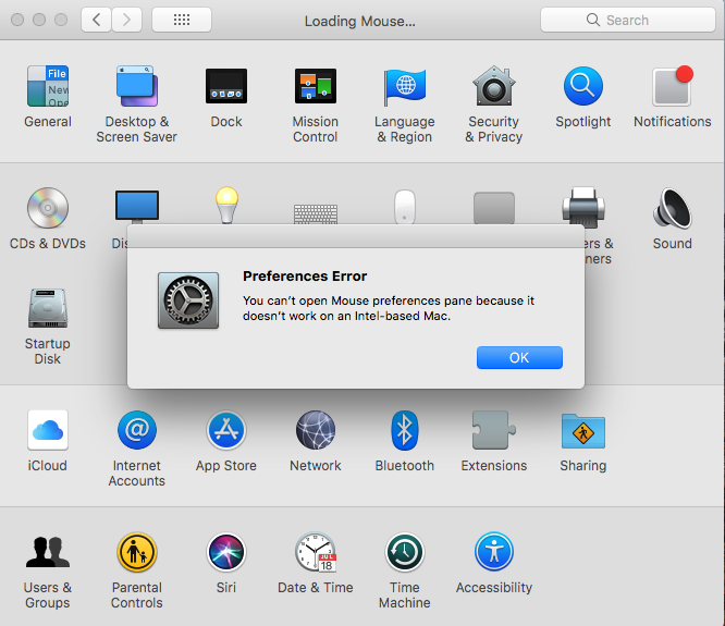

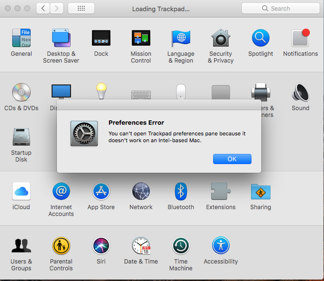

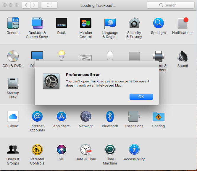

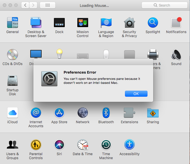

Finally got the 2018-002 security update to complete the install on my MacPro 3,1, it even shows up in "About This Mac" -> installations.
But it came at a price, now I have to figure out how to deal with these 2 issues...
It's times like this I'm really glad that Mac Pro's are just a hobby for me.😉
Screen Shot 2018-11-05 at 5.13.23 PM.png Screen Shot 2018-11-05 at 5.13.50 PM.png
View attachment 801690 View attachment 801691

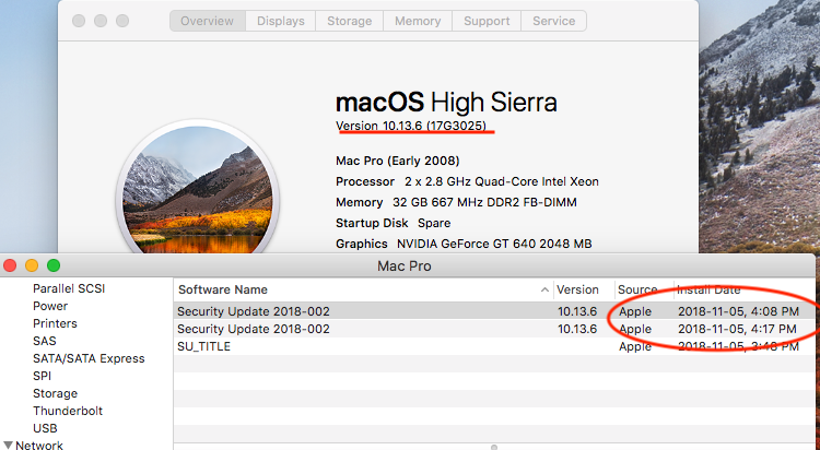

1: Did a fresh install of High Sierra onto a USB external SSD on a supported mac.
2: Applied the security update (2018-002) to this fresh install while running from the supported mac.
3: Mounted the external SSD on my MP3,1 and applied the post install patches.
4: Copied over the 2 faulty pref panes with good ones from a working High Sierra system, this fixed the errors.
The only odd thing is the 2 security update entries, appears this would be roughly start and competed time of the update.
Took awhile but it got the job done.

Forget about everything in my previous post.
For a short while I thought I'd solved my problems, but not so.
Those Pref Pane errors returned after a few restarts and I cannot figure out why.
There are 3 panels that error out, (Trackpad, mouse and keyboard) all the rest are fine.
These 3 do have something in common (Bluetooth), but I'm still at a loss.

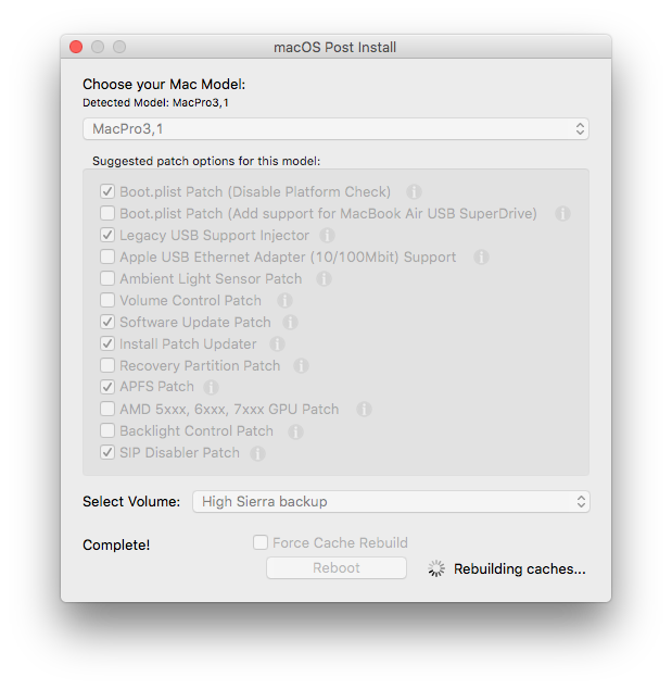

Hi, did face the same problem with my MacPro3,1
Found out that the problem keyboard, mouse, trackpad and accessibility pref panes give error, is because of Nightshift patcher.
1.Did the secupdate by editing the .pkg as per instructions in page 1 of this thread and installed it.
It lasts with the known error.
2.Booted with the USB boot/installation of the HS patcher and run the post install. Whithout post install, i get, when i boot in safe mode and recovery mode, a restriction sign.
3.Booted normally. All is fine, only the night shift is not working.
If run the night shift patch (re-install) then the problem with the pref panes keyboard, mouse, trackpad, accessibility is back again.
Reactions: f329
I think you nailed it, thanks for posting your results.
I just installed the nightshift patch on a fresh High Sierra install and just like you said, it broke the pref panels.
Glad I make numerous Cloned backups.😀
I can live without the nighshift feature, actually I think F.lux does the job much nicer anyhow.

Installed 10.13.6 APFS, updated to SecUpd2018-002 re installed NightShift, can confirm Keyboard. Mouse and Trackpad come up with the unable to load due to Intel Mac, and Accesibility is just a general failure to load.
Any response by dosdude1 would be nice.
I still have the problem where if the APFS SSD disk is the only one in the MP 3.1 it will boot to APFS disk, but if my other HFS+ disks are in place the Mac always shows the APFS verbose start but then just switches over to Sierra, if I pull out the Sierra disk it will default to the El Capitan disk, but interestingly if I leave in my Lion disk, it will boot to the APFS SSD.
Crikey I am going bananas most of my Mac time is installing, uninstalling, trying different methods to get daily functionality out of this old slugger. bought new graphics card and SSD so I can install Mojave, but this booting problem negates me moving to Mojave on the SSD, I have a copy of Mojave on an HFS+ spinner
and it woks fine.
and it woks fine.
Same problem here, the more I try to correct these issues the worse it seems to get, soon as I think I've solved the problem another issue rears it's ugly head.
Right now I'm starting with a fresh install of High Sierra and staying away from the nightshift patch.😡

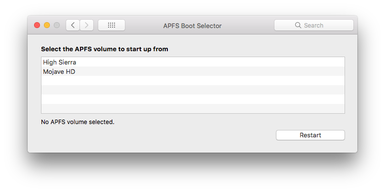

Hi! I have a succesfull High Sierra installation on my MacPro3,1 using dosdude1's patcher. However, I added a second HDD and cloned my HS partition onto a new drive hoping I could boot it from there.
Unfortunately, no matter which one I select in "Startup disk" preferences pane my Mac boots into first one. Also, in "APFS boot selector" preferences pane I don't even see the new partition/drive.
I ran dosdude1's "macOS Post Install" and patched HS volume on second drive, without sucess. No matter what I do I cannot boot from new HDD/volume.

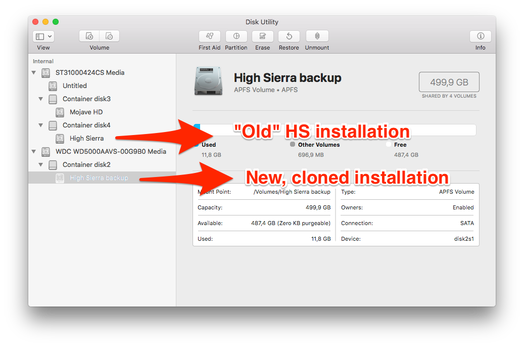

How do you guys clone your patched HS installations on unsupported machines?
EDIT: SOLVED running dosdude1's patched installation again and patching new volume from there. Boots OK. But still can't figure out how to boot switch between drives.
Thanks 🙂
I clone my High Sierra drives using Carbon Copy Cloner, I use a mix of PCIe blade, SSD's and spinners and have no problem whatsoever picking or switching boot drives either from the Startup pref panel or using cmd+alt boot selector on startup.
But then I also use the conventional HFS+ format file system on my MacPro 3,1.
