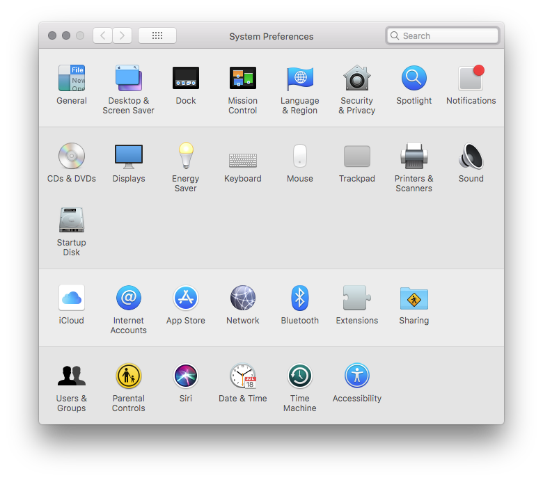

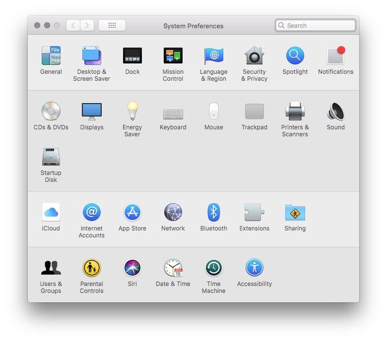

Does anyone else's 'System Preferences' look like this?
MacPro4,1
10.13.4
It's all normal as far as I can tell. What did you expect to find here?
The layout of the icons isn't like 'System Preferences' on my other mac with High Sierra (not running the unsupported version)
Not a big problem just interested to know if it's normal, thanks anyway.

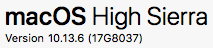

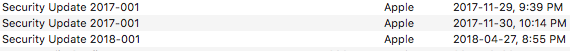

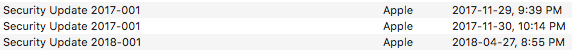

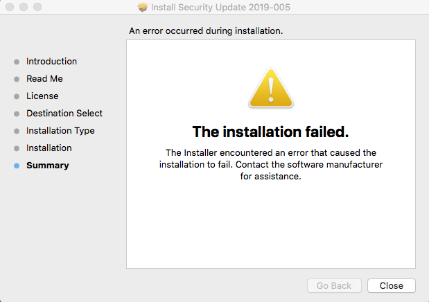

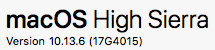

However, no such luck on my MacBookPro5,5. I tried the Software Update method and it failed, although the macOS build number did change. However, the list of installed Security Updates did not change.
Before:
After:
This is the same build number as my MacBook5,1, which had the successful Security Update, but unfortunately, as mentioned the Security Update doesn't show up in the installed software list.

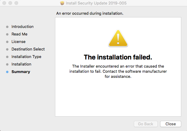

So, I tried downloading the 2019-005 update for High Sierra and installing it manually. It said it was not compatible with this machine so I edited the Distribution file as instructed in post #1. That allowed me to begin installing it, but it failed. I tried again and failed again, at the validation phase.
Anything else I can do?
