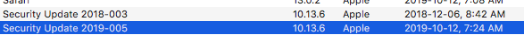

Interesting. I just did a regular software update via the App Store for Security Update 2019-005 and it appears to have installed just fine. No errors.
So I currently only have 2018-003 and 2019-005 installed. So, does that mean I have tons of missing security updates, or is 2019-005 cumulative?
It's cumulative. You don't need to install any of the older ones.
Reactions: EugW
Each new security update includes all the previous updates. Say you did a fresh install of HS... only 005 would show up in the App Store.

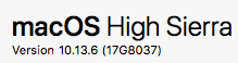

The successful Security Update install above was on the MacBook5,1.
However, no such luck on my MacBookPro5,5. I tried the Software Update method and it failed, although the macOS build number did change. However, the list of installed Security Updates did not change.
Before:
After:
This is the same build number as my MacBook5,1, which had the successful Security Update, but unfortunately, as mentioned the Security Update doesn't show up in the installed software list.
So, I tried downloading the 2019-005 update for High Sierra and installing it manually. It said it was not compatible with this machine so I edited the Distribution file as instructed in post #1. That allowed me to begin installing it, but it failed. I tried again and failed again, at the validation phase.

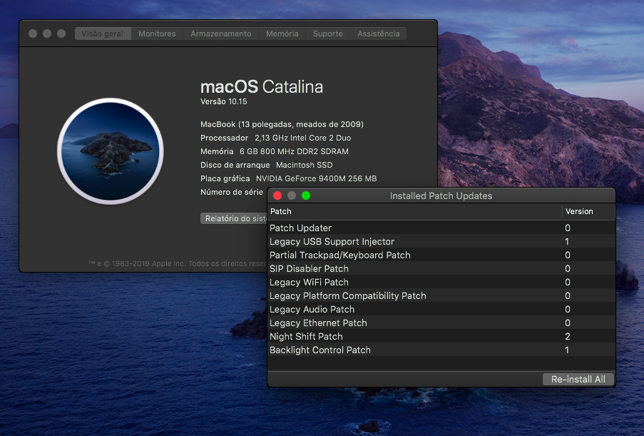

Last versions of @dosdude1 patches for Catalina and Mojave have working backlight patches. They work, at least in my iMac 7,1 and macbook 5,2
MacOS Mojave Patcher 1.3.3 does not include backlight patch.
Patch updater 1.2.0 does not show backlight patch it's never installed through MacOS Mojave Patcher, ergo, has nothing to update.
SORRY, I meant Catalina although I think Mojave Patcher has it too.
It was updated last weak if I remember well

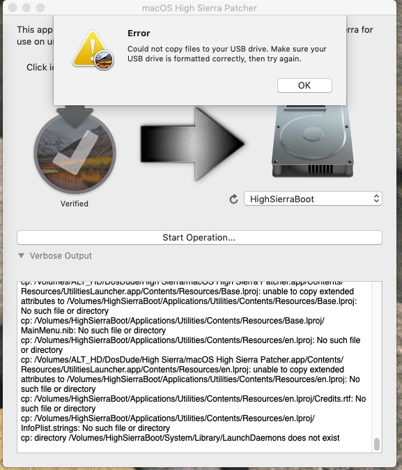

Help!
I am on a 3,1 MacPro and been running @dosdude1 's patch for a while now before I took everything down recently while trying to install the software update.
I have managed to get it back up and running on Mojave using the dosdude patch from another machine running Yosemite but I need to go back to High Sierra as I have an NVidia Card that is not supported on Mojave.
However, I couldn't reinstall using my USB drive and all efforts to create a new drive keeps failing with the error message in the image below:
I have tried several different drives with the same result.
Help!
Format the USB drive, APFS if possible, reboot and then try to create the macOS patcher without opening Disk Utility.

BTW is it normal for the patcher to rename my USB disk as "OS X Base System"?
This wasn't the case when I first installed the patched version but by the time it crashes, the USB has that name although I chose "HighSierraBoot" to start with.
Never format a USB drive for a macOS installer in APFS, it MUST be formatted HFS+ journaled
I figured that out. Thanks
Any idea why the patcher is failing?
I noticed from the log that virtually all the files it tries to copy fails or are not found.
Can't say for sure but it seems that the download isn't complete. Try to delete all macOS dmgs you may have in the download folder and try again. Sometimes it has to do with specific brands os usb sticks. I had some difficulties last time I tried to create a install usb patcher and ended having to create it in a machine with El Capitan (non patched). maybe you gantry create the usb installer inside a virtual machine with different version of macOS? USB drive must be 16 GB or higher capacity
Well, clearing my trash seems to have allowed the installer to be created. Thanks for the tip!

Finally managed to reinstall High Sierra using the @dosdude1 patch.
For anyone having similar issues, there were two problems in my case:
1. The Patcher could not be created on the USB Stick
I had named my USB Drive as "HighSierraBoot" but I noticed that the creation process for the Patcher was unmounting this and changing the name to "OS X Base System". Presumably it would change this back to my chosen name later but while it was under that name, the process was failing. On a hunch, I reformatted the disk and called in "OS X Base System" and the process went through. I then renamed it back to "HighSierraBoot" afterwards using Disk Utility.
2. After getting the Patcher created and booting into this, the High Sierra Installer would fail with an error message saying "No packages were eligible for install. Contact the software manufacturer for assistance."
A web search showed that similar errors were linked to errors in the system date. My system date was correct (29 Oct 2019) and knowing I had previously installed this OS, I decided to change the date to 29 Oct 2018 on a hunch and voila, the installation worked fine.
To change the date, before Step 7, "Install macOS normally onto the desired volume", in dosdude's instructions, open Terminal from the Utilities menu of the Patcher and change the system date. The date string that worked for me was "date -u 102904022018".
