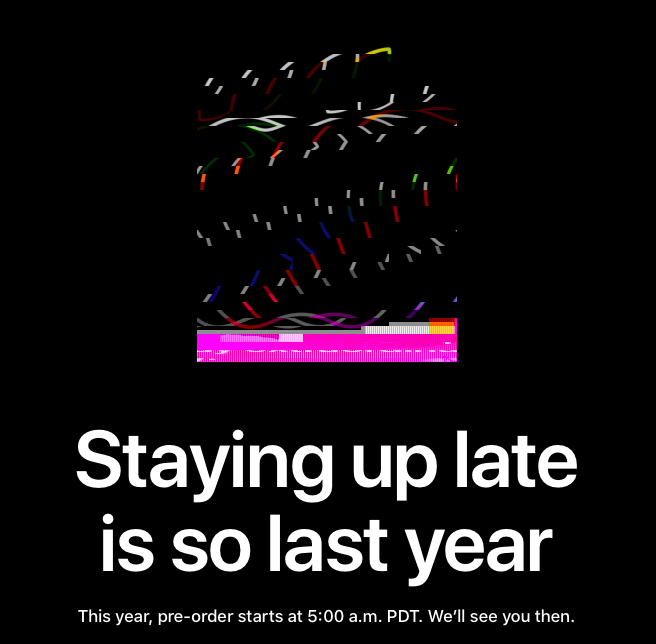

I have a MacPro 3.1 with an AMD 7950. Unfortunately the graphic performance in the UI is almost unusable. Is there anything I can do? Did I do something wrong?
Apple moved AMD drivers for anything newer than Northern Islands (HD 7xxx and beyond) to SSE4.2. They never intended to support Mac Pro 3,1 beyond El Capitan, so it's not a problem of, like you said, shoddy driver integration. It's just using the resources provided by the supported processors.
To use a HD7xxx with MP3,1 and 10.13, you have to use Sierra patched drivers. The loss of sleep/hibernation is the victim of this. If you tolerate the problems of the hacked Sierra drivers with AMD GPUs newer than HD6xxx, fine by me.
Nvidia didn't yet updated her drivers to use SSE4.2 instruction set, so you still have full support for Nvidia GPUs using High Sierra/Mojave with a MP3,1. If we want to use High Sierra with a 2008 Mac Pro and want full GPU support, working sleep and a almost clean install, you have to use Nvidia GPUs, period. But even that has a expiration date.
Btw, Mojave don't even load Sierra drivers and you can't use HD7xxx and newer cards with 10.14 on a 2008 Mac Pro.
Where can I find these hacked drivers? I have a MacPro 3.1 with a 7950 and performance is terrible. Unusable in fact.
I did apply the patches for MacPro3.1 after installation but it made no difference.
Thanks!
Thanks!
Forget AMD GPUs with MP3,1. Hacked drivers from Sierra included in the patcher have abysmal performance. Swap for a GTX 640/680/740/780.
This "video bug" has been long fixed. Use AppleGVA.framework from the Low Sierra. Enjoy!
Thx. Is that in the latest patcher or is it manual? What about the AppleGVA.framework patcher people are using for Mojave?
Does the swap cause any other issues?
In Mojave patcher people use High Sierra's AppleGVA.framework for a smoother HD playback. The problem is that the High Sierra's "video bug" carry on to Mojave with this framework so I came up with the idea to use the Low Sierra's one as I really wanted to get it fixed. I kept quiet about it as almost nobody complained about it. You have to do it manually at this stage.
P.S. I believe it is only limited to the 9400M GPU's so it is not useful for everybody.

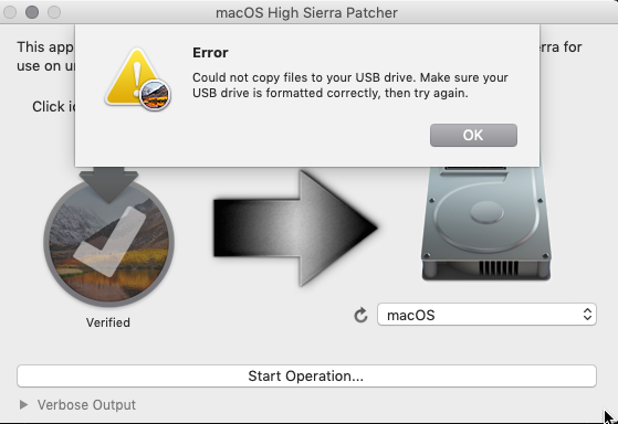

hi guys, sorry if this has been asked already. i'm just really stumped.
i'm on an early 2008 Mac Pro [ 3,1 ] trying to install High Sierra.
I'm stuck here:
i've tried different USB sticks / internal drives and i'm formatting it journaled + GUID
i also downloaded different versions of the patcher and High Sierra.
still nothing. can someone please help me figure this out ?
