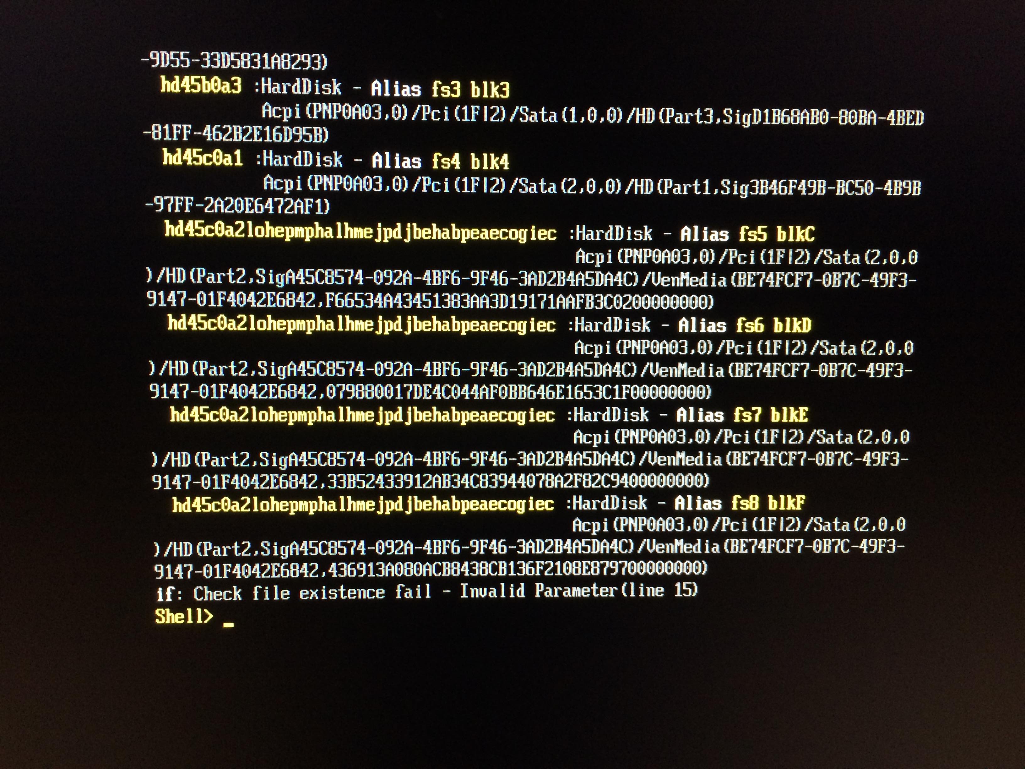

Alright, just got the implementation done and uploaded! Give it a try and let me know how it works!
OK, will do this evening when back from work. Does the patch need to be applied to each bootable SSD installed in the Mac. I guess it must!
Yes, it does.
The first section of startup.nsh works correctly as apfs.efi is loaded and the mapping for the APFS volume is displayed but there is an error message immediately following...
Executing...
fs5:\System\Library\CoreServices\boot.efi
...boots the APFS HS volume as expected.
I was just building a new USB installer but will stop until this glitch is fixed. I'm planning to start over fresh with three SSDs with beta 8 and formatted APFS and the new post install patch and will then load them in MP 3,1 and see what happens.

So it is barfing on...
if exist "fs%m:\%apfsBootUUIDdir%\%targetUUID%" then
Perhaps just drop trying to use so many variable substitutions and just repeat an explicit hard coding of the UUID

Hmm, it says the error is in the if statement on line 15... Maybe try removing the quotes around "fs%m:\%apfsBootUUIDdir%\%targetUUID%" and see if that works?
The startup.nsh installed has...
I see the error now. You are erroneously assuming that the / partitions reside on fs# A-Z. That isn't the case here. While they might extend out to the alphabetical letters if you had enough drives and partitions, they start from where the EFI boot partitions left off. So on my machine, each AppleRAID-1 slice drive has both an EFI partition and an Apple_Boot partition while the third drive with the APFS volume only has the single EFI partition. This maps out to fs0 through fs4. After loading afps.efi, the mapping continues from fs5 through fs8 (where the boot.efi for the APFS / partition actually resides on fs5).
