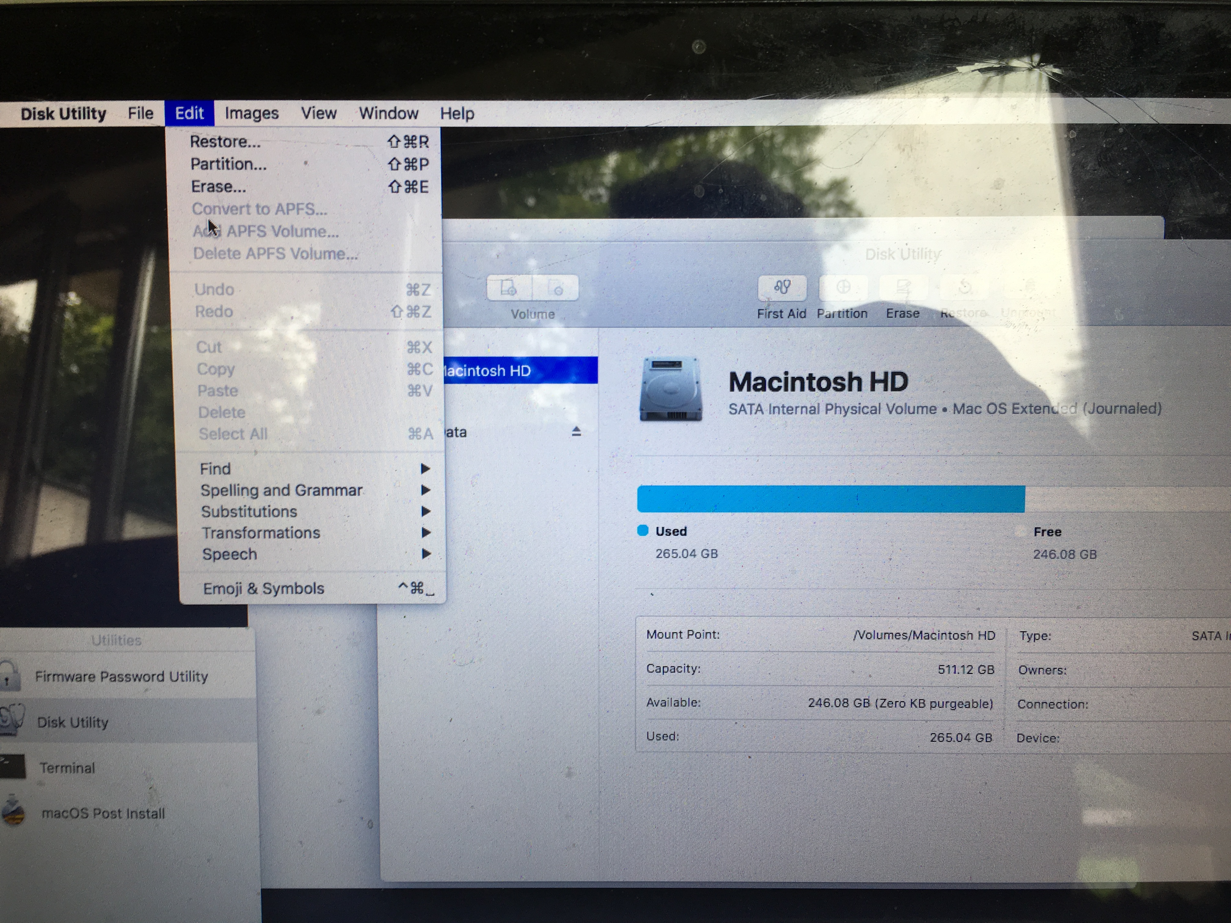

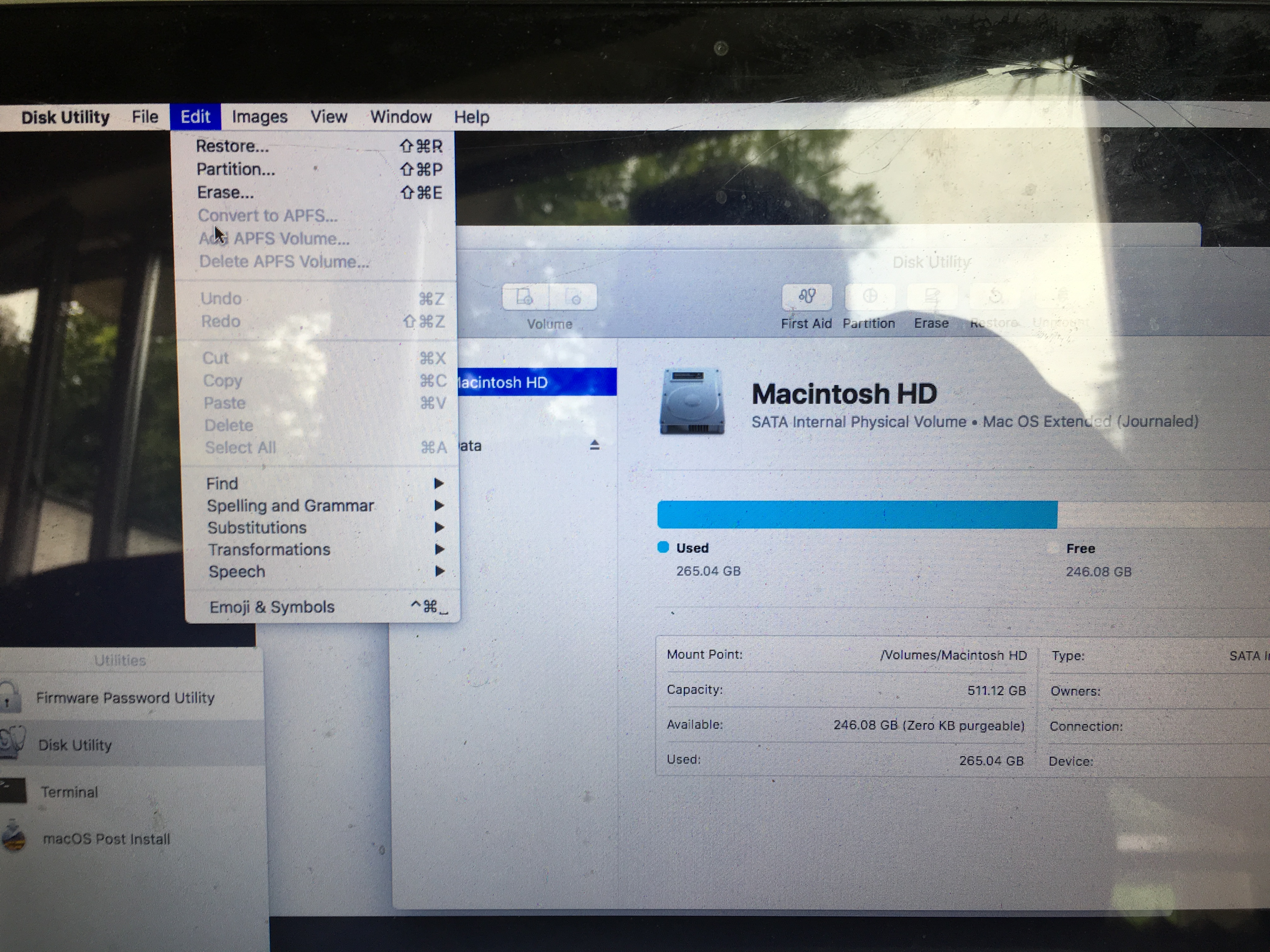

Unable to convert my existing install into APFS. Option is greyed out both when booted via USB stick or via the recovery partition.
MBP 13” Mid 2009 (MBP5,5)
Seems others have the issue :/
https://forums.developer.apple.com/thread/84692
That's strange, but why don't you do a clean APFS install of High Sierra? Would be easier.
IMHO, the 'diskutil apfs convert' option is too buggy to use, at least on HDD but I don't see why that would be different from SSD in this regard. I would suiggest, assuming that you have an existing JHFS patched High Sierra volume to clone...
1) Format a drive as extended HFS with journaling.
2) From the macOS patched High Sierra installer key, execute 'sudo apfs convert' on that empty JHFS volume.
3) Use Carbon Copy Cloner 5.0 to clone your current JHFS High Sierra volume onto the newly converted empty APFS one and then apply the patches from the macOS High Sierra Patcher installer.
