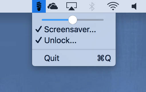

For those of us still having issues with the backlight not working, I put together a small app which will set the backlight whenever the screen is unlocked.
This works for my specific use-case whereby the screensaver comes on and locks before the screen turns off.
I've tested this on my iMac 2009 (iMac 9,1), and it seems to work fine. The screen immediately brightens when you unlock.
This should also do the same thing when the screensaver is disabled (although I've not tested this).
I have a test version that should do the same thing on 'Wake', but it doesn't seem to always work, which is annoying.
When you first launch, it will set the screen brightness to 50%.
Please bear in mind that I'm not a Mac or iOS developer, so Objective-C is not my forte.
Edit 1:
* Updated to change brightness when the slider is slid, not just when you release the mouse.
* Updated to not allow a brightness of 0 (minimum is 10%, maximum is 95% as above or below that turn my backlight off).
cool!
1) can you post the code?
2) can you make 0% on slider not be 0 because then you can't see anything to change it
3) can you make it change when you MOVE the slider not just let go of the mouse?

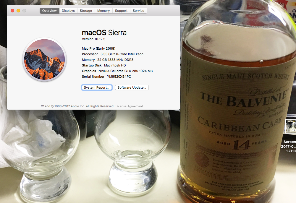

My system is an Unsupported (Early 2009) MacPro patched to 5,1 and upgraded last year with faster processors, more memory, Video card upgrade, etc.
But no room to spare on my current "boot drive" ...
so I've ordered a larger SSD and will clone my system onto that
before doing the upgrade to High Sierra beta.
I'll keep reading - and, thanks for all you do here!

cool!
1) Yes. Note: I'm not a Mac or iOS developer and before last night, I haven't used Xcode for 5+ years
2) Sure. On my iMac '0' just turns off the backlight, but not the actual display. Regardless, minimum is now 10%
3) Yes. Done.
Edit: I updated the original post with an updated version and the source code. You can see the bit for capturing sleep notifications which is currently commented out.
