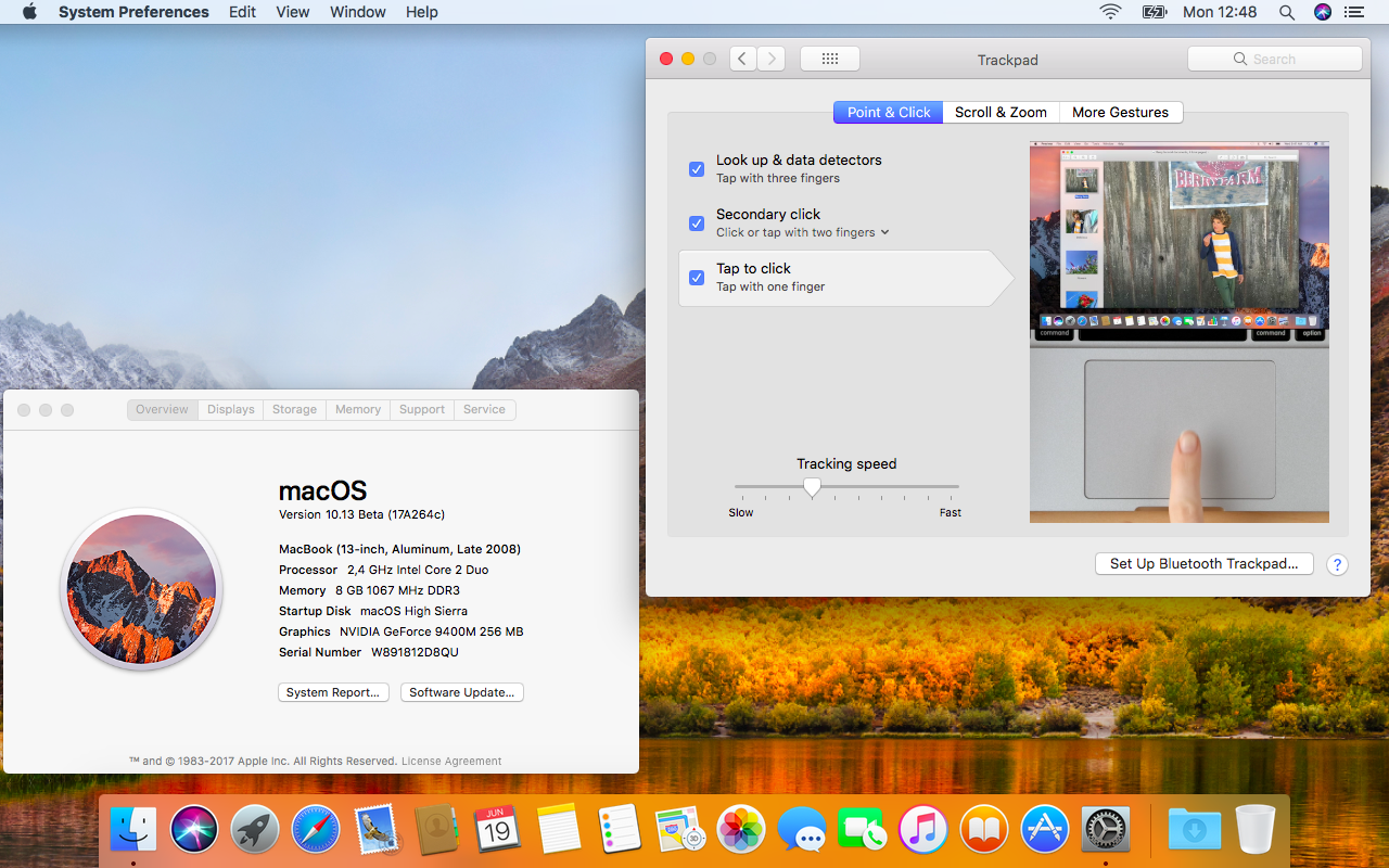

I just installed High Sierra on my 2.4GHz Late 2008 MacBook (5,1) and had no issues thus far.
I heard some people having issues with the trackpad not being recognised correctly but mine works perfectly fine. I used NewCore 0.1 to install High Sierra and then had to install the LegacyUSBInjector.kext with a patched Sierra restore Disk as USB wasn't working on first boot.
Interesting. It's the MacBook 2009 5,2 that has the issue with the trackpad (and brightness control) persisting from Sierra. The MacBook Pro 17" 4,1 2008 also lost its trackpad support with HS DP1.

Interesting. It's the MacBook 2009 5,2 that has the issue with the trackpad (and brightness control) persisting from Sierra. The MacBook Pro 17" 4,2 2008 also lost its trackpad support with HS DP1.
It looks like the MacBook 5,1 is having issues as well:
Installed it onto my MacBook 5,1 (8GB DDR3 1333MHz | 128GB SSD)
Everyting works as it did in Sierra apart from not having any Trackpad Options.
No settings to make Tap to click to work or any of the multi finger gestures.

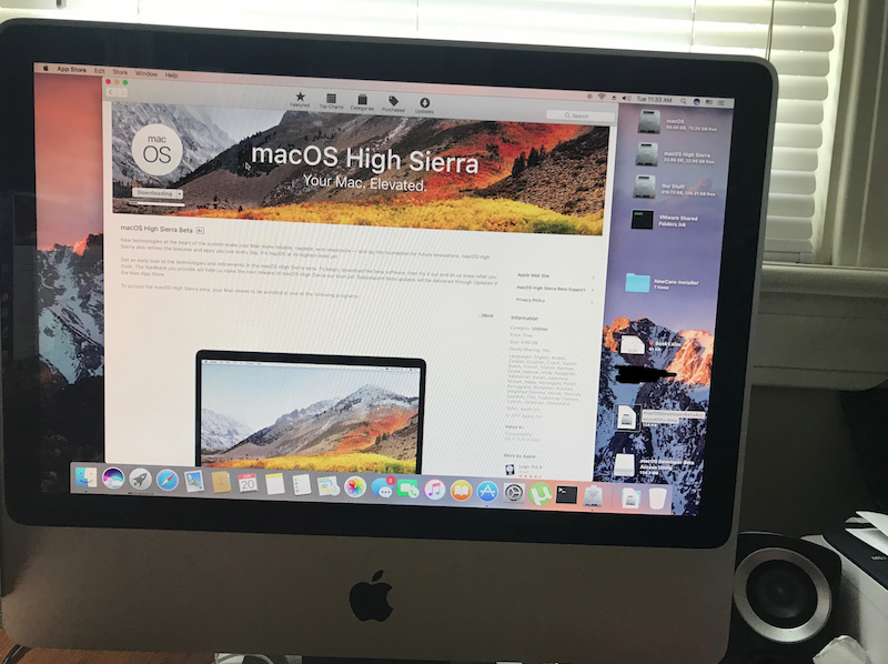

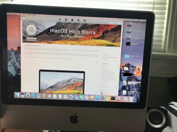

Here I am downloading it onto a 2008 iMac

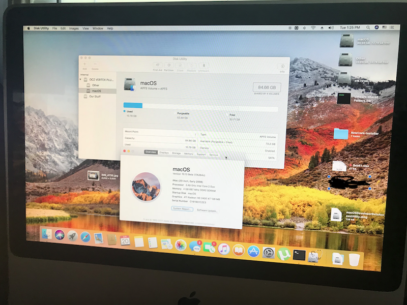

And here I am with a 2008 iMac that is booting into macOS High Sierra with APFS

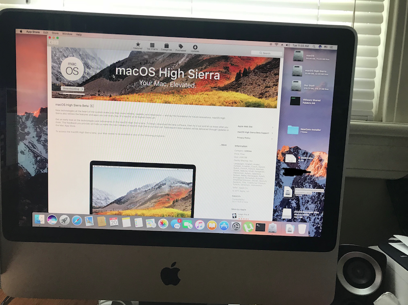

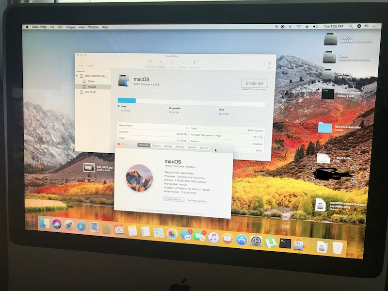

.View attachment 704926
