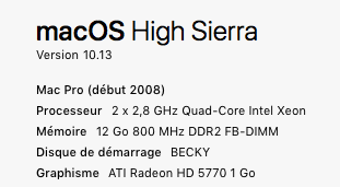

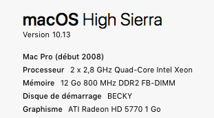

Success with a MacPro 3,1 and a Radeon 5770 GPU.
Big thanks to Dosdude1. Everything was smooth as "advertised" !!!!!!!!!!!!!
