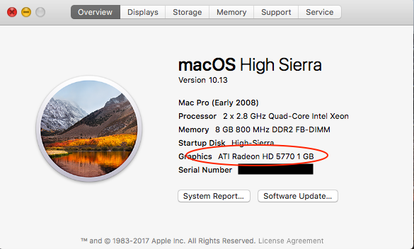

I have successfully updated my Mac Pro 3,1 (Early 2008 8-core 2.8, ATI Radeon 5770) to High Sierra. My first attempt using APFS on a 3rd party SSD didn't work, but with HFS+ it went smoothly. The only issue I have noticed so far is that if I switch apps to full screen, the desktop goes bright red before it is obscured, and it does the same as apps come out of full screen, only returning to the desktop image once the process is complete. It doesn't go red with minimise or any other screen movement. Other than this small anomaly, all seems well.
Reactions: rosuna

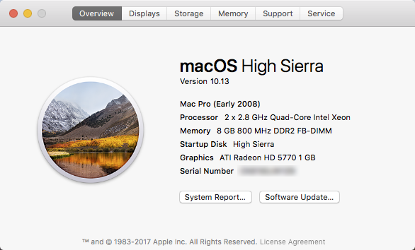

I have successfully updated my Mac Pro 3,1 (Early 2008 8-core 2.8, ATI Radeon 5770) to High Sierra. My first attempt using APFS on a 3rd party SSD didn't work, but with HFS+ it went smoothly. The only issue I have noticed so far is that if I switch apps to full screen, the desktop goes bright red before it is obscured, and it does the same as apps come out of full screen, only returning to the desktop image once the process is complete. It doesn't go red with minimise or any other screen movement. Other than this small anomaly, all seems well.View attachment 721401
Any problems getting the ATI 5770 up and running?
Mine doesn't like either Sierra or High Sierra.
Edit:
Finally got my ATI 5770 up and running, and ditto on the red flash screens when going to full screen windows. This does not bother me as "fullscreeen" is not something I normally ever use.
The red makes an appearance again when you enter the Time Machine history window.

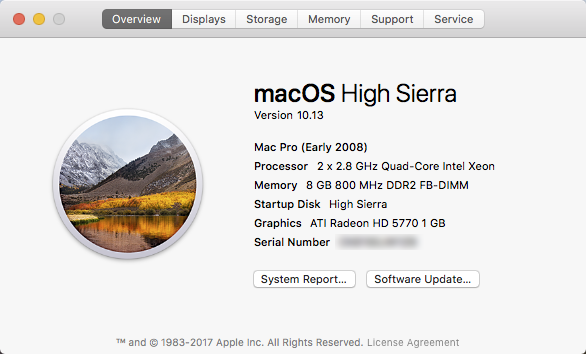

Edit:
