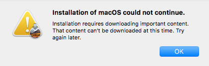

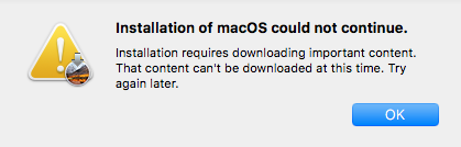

First time poster, but long time reader here. I have a MacPro 3,1 with four HDD in the bays and an Apricorn PCI card for my boot Samsung 850. It runs Sierra very well, but is recognized as an external drive. Will I be able to go to HS in APFS, or will I need to use HFS instead? I don’t want to have to put the SSD in one of the bays. Thanks. Oh, and I still have the original graphics card in there so that won’t pose an issue with HS.
Okay, I searched the thread but couldn’t find a reference to this error. Is it a current problem with Apple’s servers, or did I somehow make the install drive incorrectly?

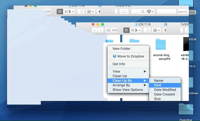

the graphic corruption on the 9400m is still there for the large video on the iPhone X page https://images.apple.com/media/us/i...0c34a926a7/overview/primary/hero/large_2x.mp4
Confirmed.
And I still have not seen anyone post the results from MacBook6,1 for comparison.

I wonder if the Safari garbled colour glitches with nVidia GeForce 9400M are a Metal 2 problem. Ars states that there have been a fair number of windowserver glitches related to this, in videos, webpages, and 3D graphics.
https://arstechnica.com/gadgets/2017/09/macos-10-13-high-sierra-the-ars-technica-review/7/#h1
For example, this:
Furthermore, he mentions that some older nVidia machines had been getting kernel panics from Metal 2 in the betas, just from basic but specific OS actions.
https://twitter.com/stroughtonsmith/status/877664628775538692
Thus, I am optimistic this will get fixed on Apple's side with a point update to High Sierra.
