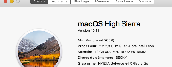

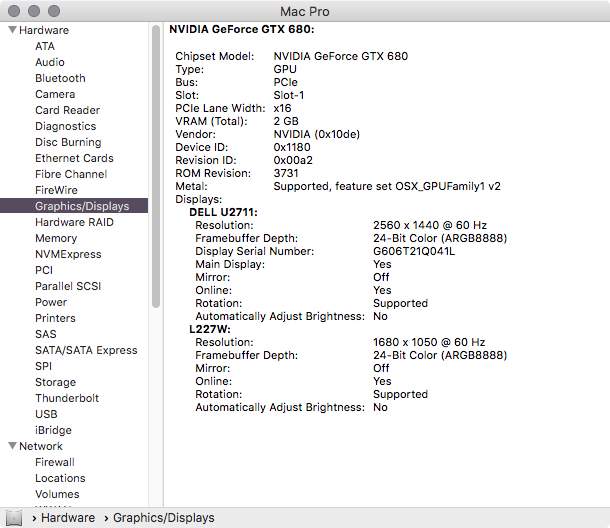

I just installed the GTX 680 on my MacPro 3,1.
No sleep problems or red patch in Preview but one important problem : FinalCut Pro last version which was perfectly working with the Radeon 5770 under HS 10.13 is crashing with "no acceleration" message. I also didn't get the Metal support in the System Report here enclosed compared with what Dandoe obtained with a close configuration to mine ?????
VLC is not working either (only sound no video) but videos can be read by QuickTime.
I tried to install the Nvidia web drivers recently released for High Sierra 378.10.10.10.15.114 but they refused to be installed with message "can't be install on High Sierra" !!!!!!
Very strange as everything was perfect under the Radeon card which is much less powerful...........

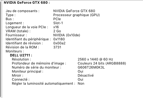

On my MacPro 3,1, i just switched the ATI HD 5770 for a Nvidia GTX 680 (2Go).
Clean install with Dosdude patch (last release).
Everything OK : no red flag or sleep/wake problems.
All is running smoothly and fast !
Merci mille fois for this amazing work
PJN
