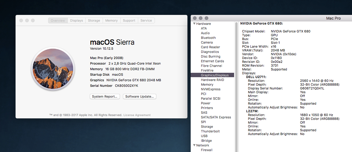

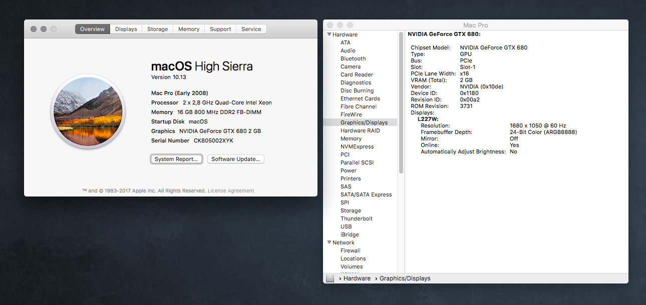

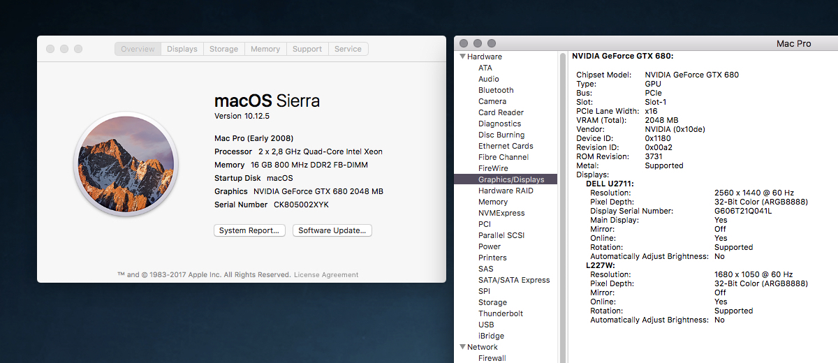

I received my GTX680 today! (was having issues with my Radeon 6870)
After installing the GTX680, no red graphic issues anymore, and wake from sleeps works too now.
But now i have other problems with the new GTX680 (using the built-in drivers):
- boot takes way longer now
- flickering boot screen (name/pswd text input)
- very (!) slow/choppy/wobbling animations (macOS Finder, Safari, Videos)
- System Information->Graphics/Display does not recognise/show my first/main display (27" DELL @2560x1440), only the second display (22" LG @1680x1050), also no info about Metal-support.
After booting from my macOS Sierra-backup – no problems at all! (so the GTX680 works fine with Sierra)
I will try a High Sierra clean-install tomorrow.
If the clean-install of HS doesn't help, i will have to drop HS and return to Sierra. :(
UPDATE: Bluetooth is gone now too after my last reboot! Very strange.

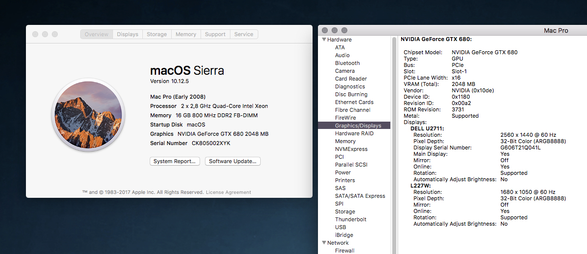

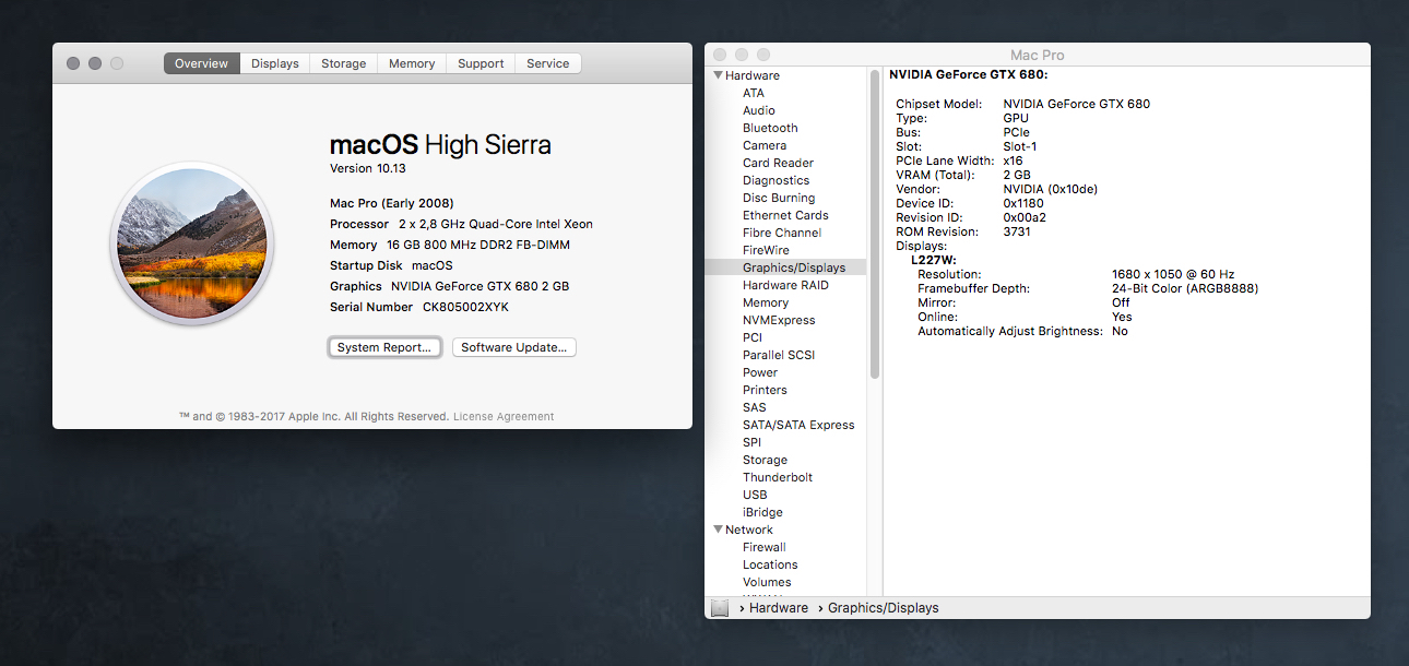

You need to clean install... The GPU patch for AMD cards causes issues with other cards. I'm currently working on an implementation to uninstall patches, but until then I'd just recommend you re-install.

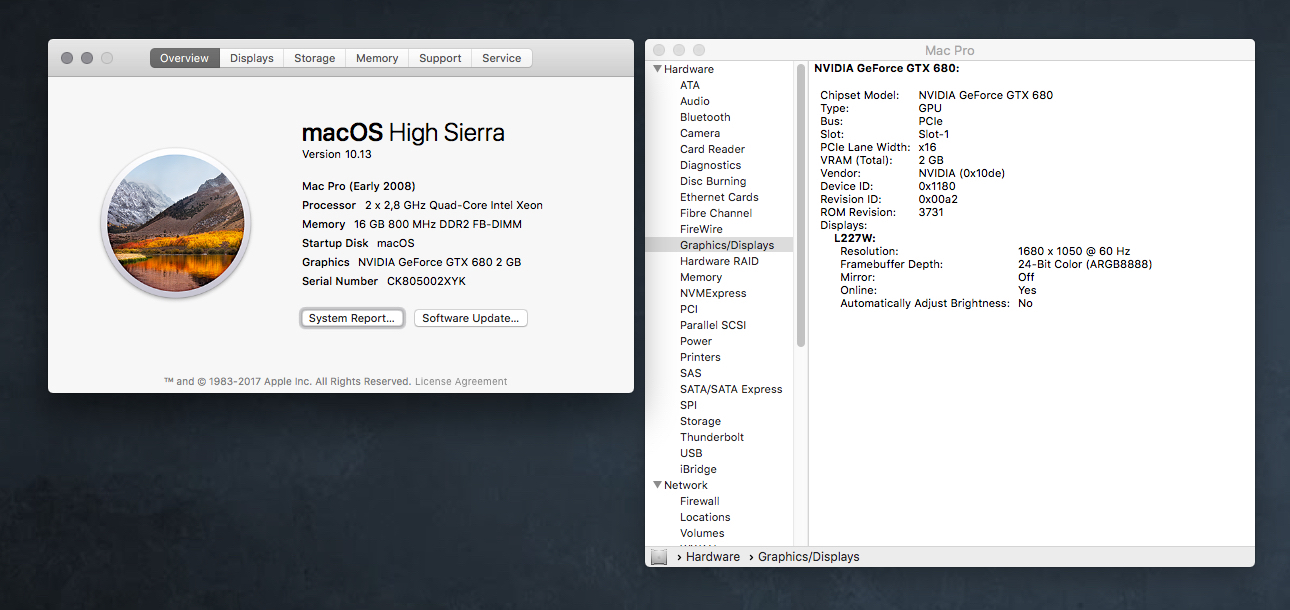

I'll be in this (or similar) boat soon too. (Flakey 5770 and switching to a gtx 680.) Can I just re-run the High Sierra installer on my current 10.13.0 install and not apply the GPU patch or do I need to start from scratch? If I can install a clean OS on another volume and copy the right files back to my current install will that work?
Hi!
Systems works fine except for the red-square-bug.
I am using an AMD Radeon 7950 in a MacPro 3.1
Is there a way that this can be fixed in the future, dosdude1? Or is there no way no get rid of it. In that case I would go back to Sierra. :(
Thanks for the quick reply dosdude1!
Would it fix the problem if i just copy the related files from my working Sierra backup? (craigtheguru had a similar idea using unpatched HS files)
Which kext files would i need to copy from my working Sierra system to HS? (i also downloaded your 10.12AMDKexts.zip mentioned in a previous comment, are those the only files patched or are more files involved?)
