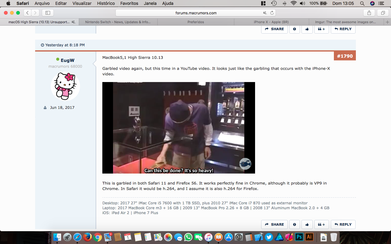

MacBook5,1 High Sierra 10.13

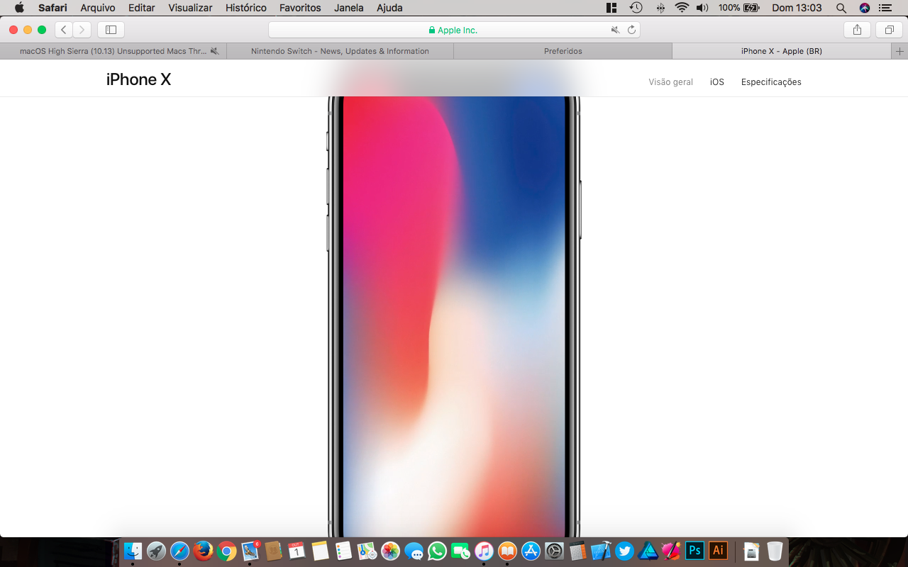

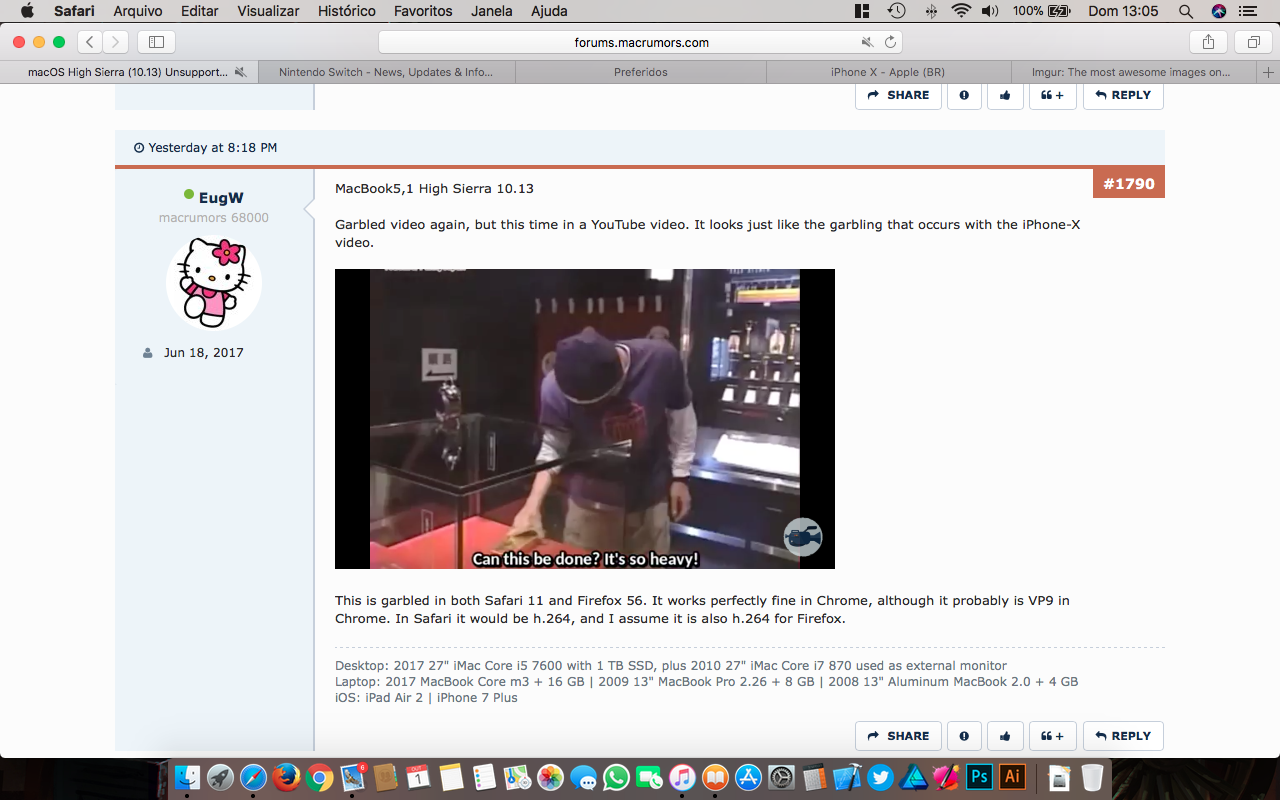

Garbled video again, but this time in a YouTube video. It looks just like the garbling that occurs with the iPhone-X video.
This is garbled in both Safari 11 and Firefox 56. It works perfectly fine in Chrome, although it probably is VP9 in Chrome. In Safari it would be h.264, and I assume it is also h.264 for Firefox.

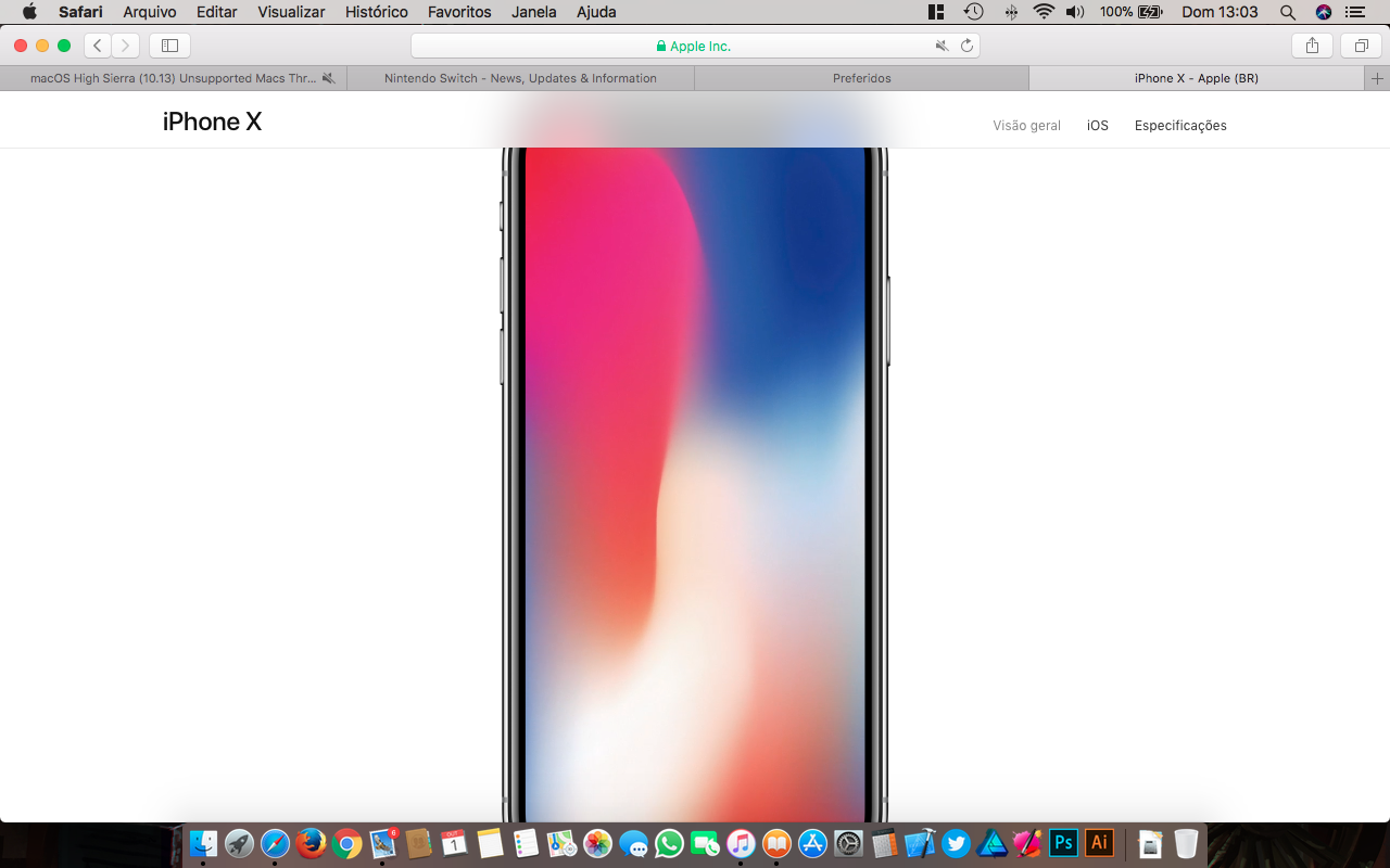

MacbookPro 5,5 works fine here. Also I just visited iPhone X website and it worked too! LOL The issue occurred before too but now it may just have fixed itself o_O
Captura de Tela 2017-10-01 às 13.03.16.png Captura de Tela 2017-10-01 às 13.05.30.png
Edit:
I just closed safari and opened again and the issue appeared. Weird bug.

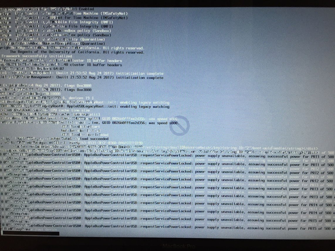

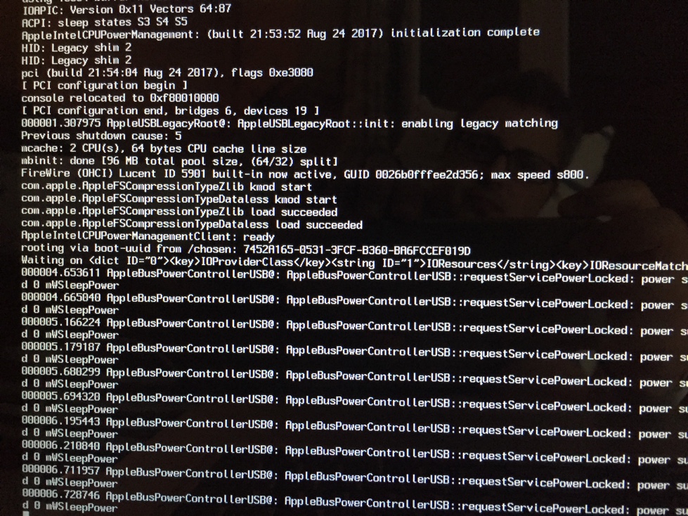

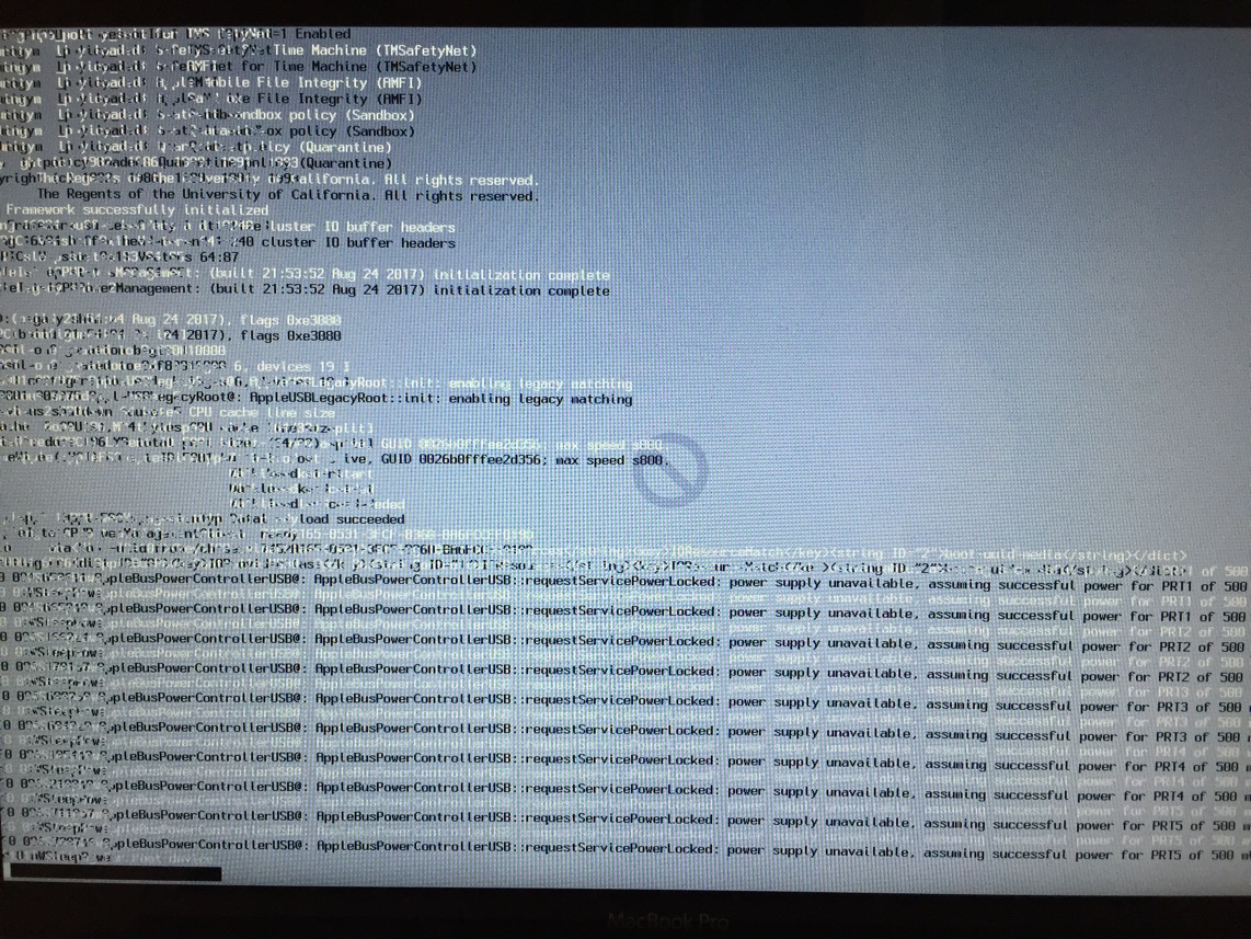

@dosdude1 First of all thanks for your time and efforts! Also kudos to all those creating the kexts and misc utilities.

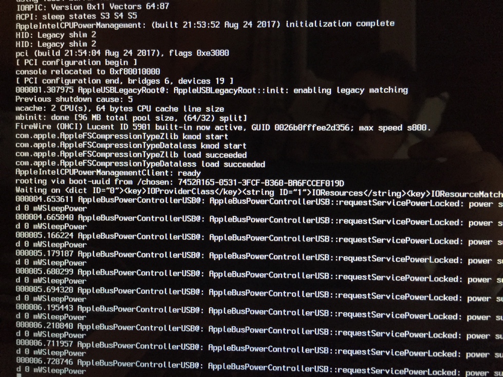

I'm on a MacBook Pro, Mid 2009 (5,3). Sierra was OK with this machine, no issues at all.
I used your tool to get to High Sierra and I tried installing it to en external USB stick first.
I followed the steps as usual, but when it tries to boot it freezes on the entries for "AppleBusPowerControllerUSB".
Then I get a grey screen with superimposed characters and the "forbidden" symbol.
Tried re-running the patch, creating another USB stick 3 times, tried a few more options in the Post-Install-Tool, but nothing changed.
Does it help you understand?

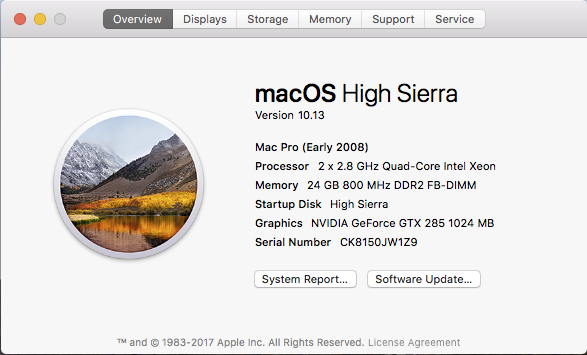

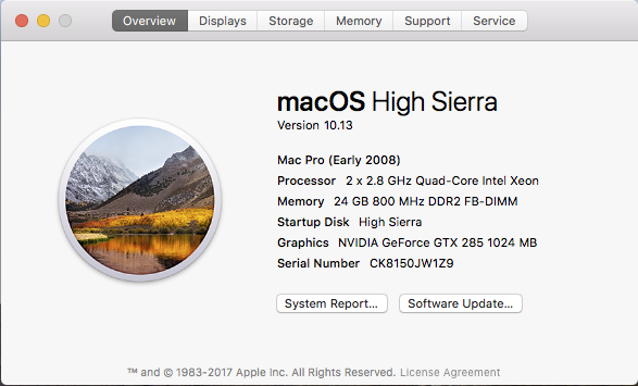

As one of the users having issues with the ATI Radeon HD 5770 card - i.e. red artefacts during certain screen activity, and the major issue with waking from sleep, I ordered a refurbished nVidia GTX 285 from eBay which arrived this morning.
Having removed the 5770 and installed the nVidia GTX 285, it would seem that High Sierra is working smoothly so far. There are no red flashes on the switch to full screen or when scrolling PDFs in preview; I visited the iPhone X website, and that all displayed correctly; videos play correctly in preview, Quicktime and within Safari. The Mac wakes from sleep with no issues so far.
Reactions: rosuna
