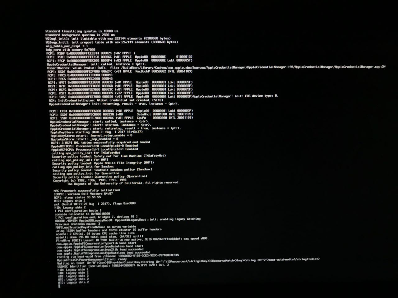

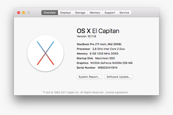

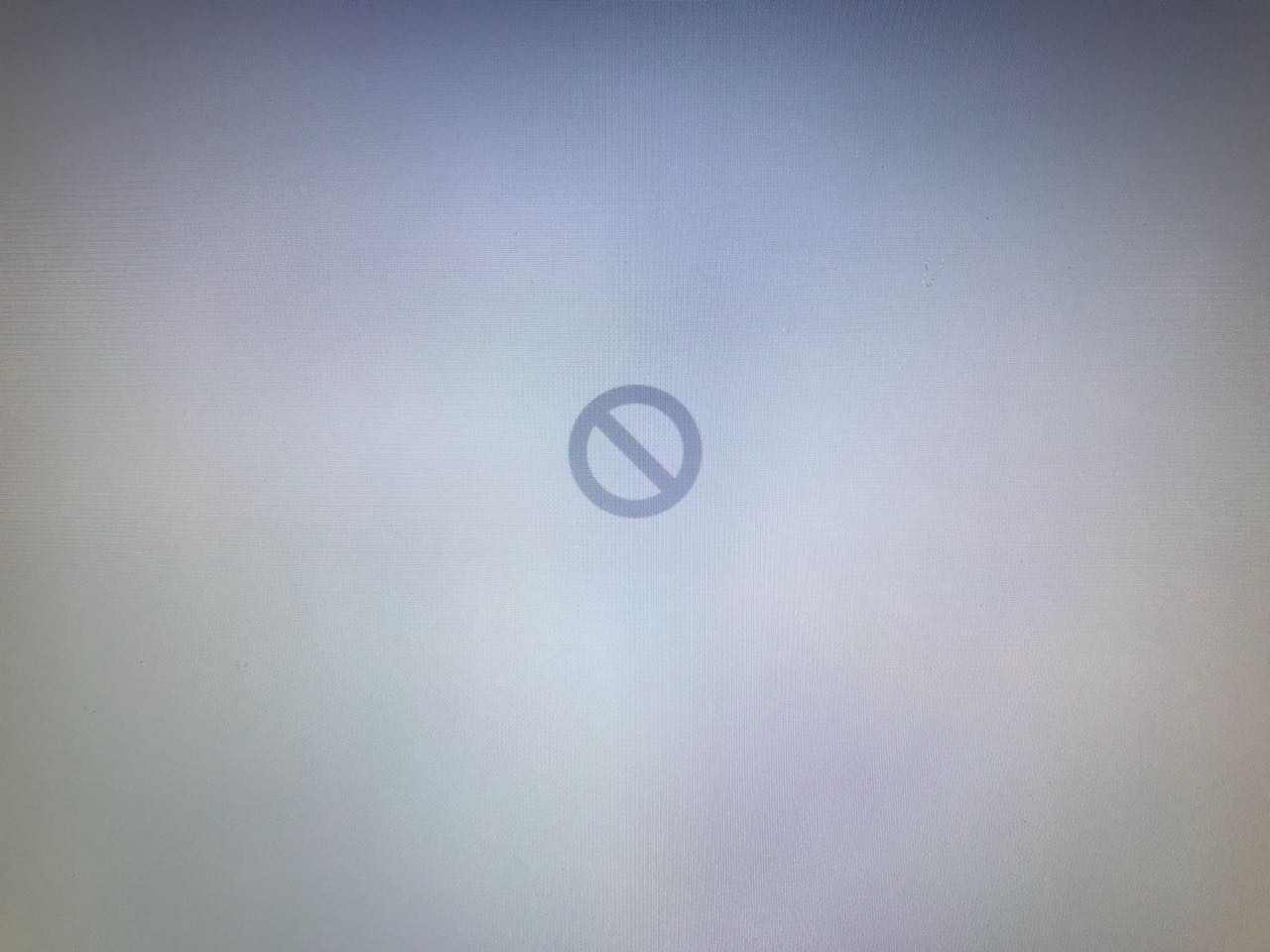

Cant install 10.13 on my MacBookPro 17" mid 2009 tried everything USB Installer is 100% correct when booting from it it ...always this sign..
Is there anything I did wrong.... used the Installer downloaded direct from the Patcher and newest patcher run the Patcher as an Admin tried different USB's....
Current OS is 10.11. SIP is disabled

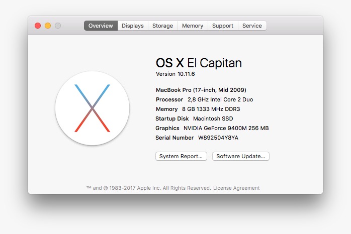

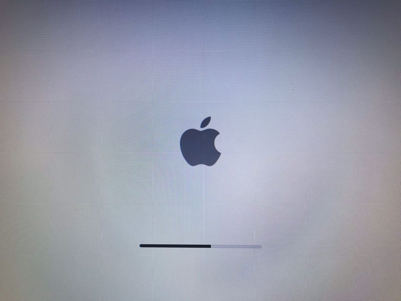

@dosdude1
View attachment 722377 View attachment 722378

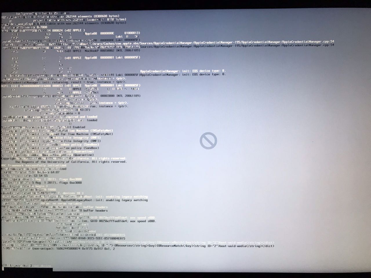

Can you boot while holding Command + V, and send a pic of when it hangs?

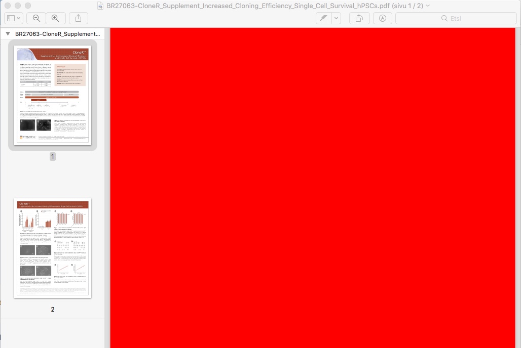

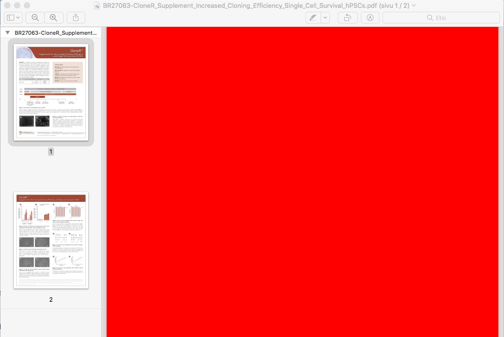

I also got the red login window on my Mac Pro 3,1 + HD 5770. Interestingly, when I log in remotely the screen is red too. This lead me to think this actually a file or an attibute that could be changed and not a driver arctifact.
Turns out my
/Library/Caches/com.apple.desktop.admin.png
was a single pane red image!
I deleted the image and it solved the red login window. Just resetting your background wallpaper probably also does the trick.
Ok, this work for me also!
So now there is sleep problem and preview (PDF pages turns red!!).
Hope that is general bug and Apple fix that soon.

I have new "red" bugs with Mac Pro 3.1 (Radeon 6870) :
- when I try to use fullscreen app (like mail) I have a "flashing" red full screen. Not very annoying but a bit strange.
- in Preview app with pdf file, when I scroll, some parts of the file are red.
Anyone with this kind of bugs ?
Yes, i have the same problem with red flashing screen in some apps, running High Sierra on a Mac Pro 3.1 and a XFX Radeon HD 6870 (plain PC-version/un-flashed).
I could fix the red login screen thanks to KvR's comment/hint, tho! (thanks a lot KvR)
I also have a flashing red when going to full screen. I'm convinced this is also a file or attribute somewhere, because I have the same thing when logged in remotely. I haven't been able to locate the file though. Suggestions are welcome. Just an easier color would be nice.

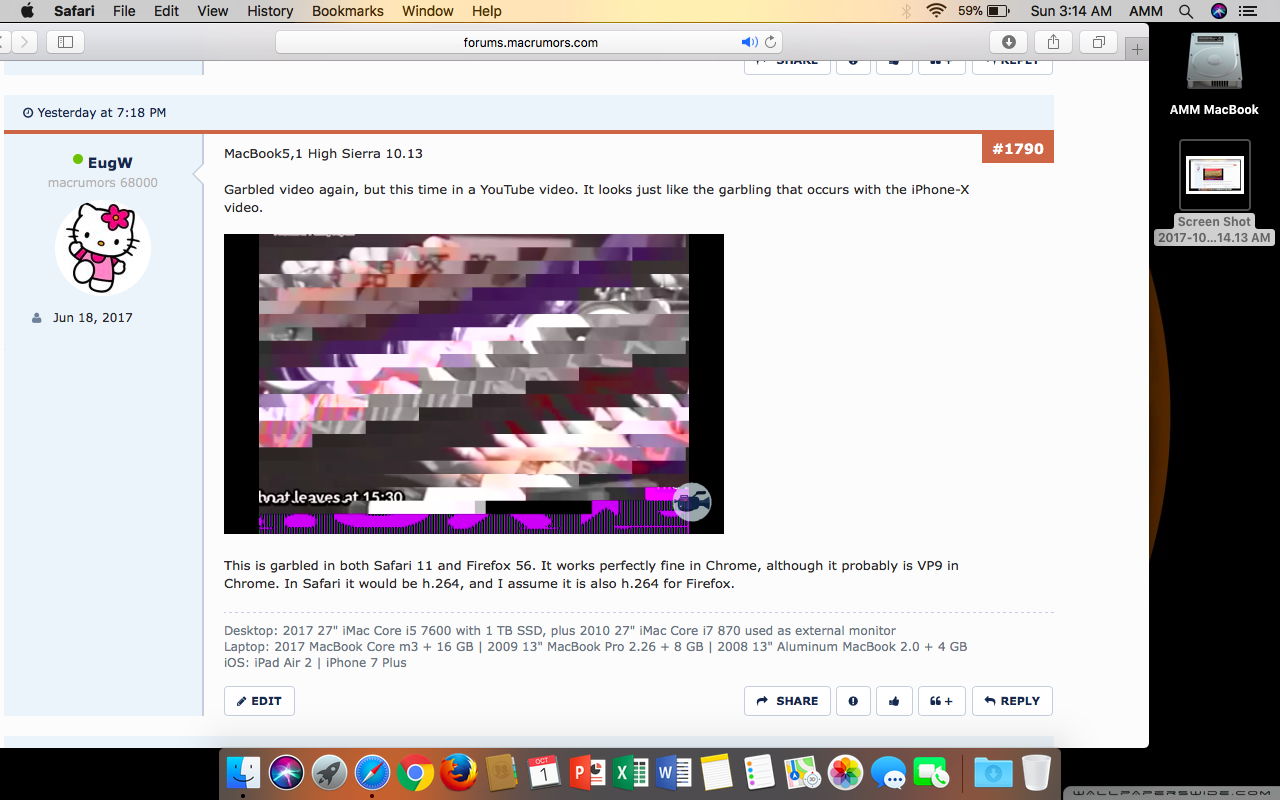

MacBook5,1 High Sierra 10.13
Garbled video again, but this time in a YouTube video. It looks just like the garbling that occurs with the iPhone-X video.
This is garbled in both Safari 11 and Firefox 56. It works perfectly fine in Chrome, although it probably is VP9 in Chrome. In Safari it would be h.264, and I assume it is also h.264 for Firefox.

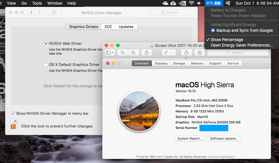

Thank you very much to you Mr. Dosdude1 and all other contributor's that help to make this possible.....
Works Great on my Macbook Pro 5,5..
I am seeing the same thing...mid 2009 Macbook Pro Nvidia 9600 GT 256mb.

I can confirm the "red" bug, red flashing when opening preview or going into full screen
Also the sleep mode doesn't work anymore :-(
