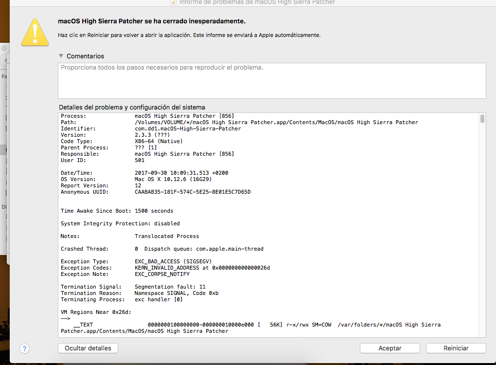

Hello,
I'm trying to create the installer USB but it crashes everytime, it gives me this message:
I tried with two different usb sticks and gave me the same error.
¿Can you help me please?
Thanks!
