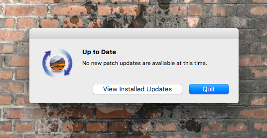

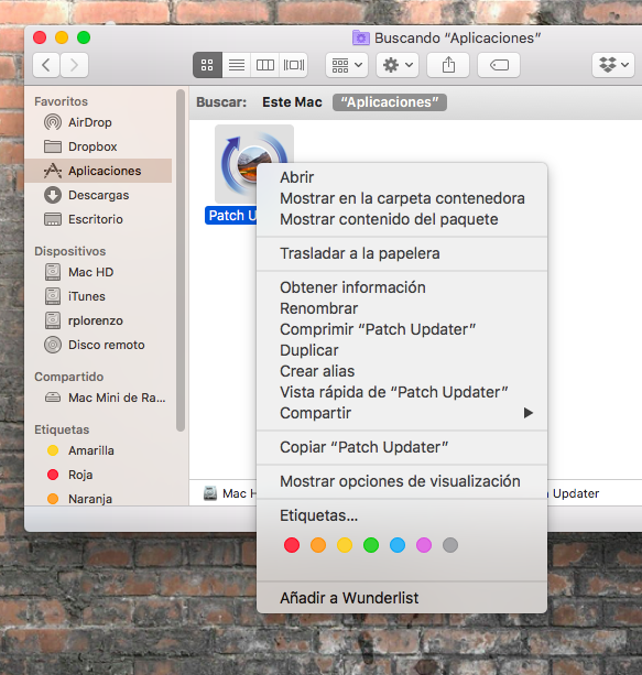

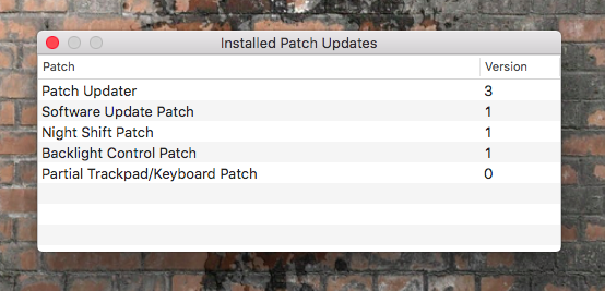

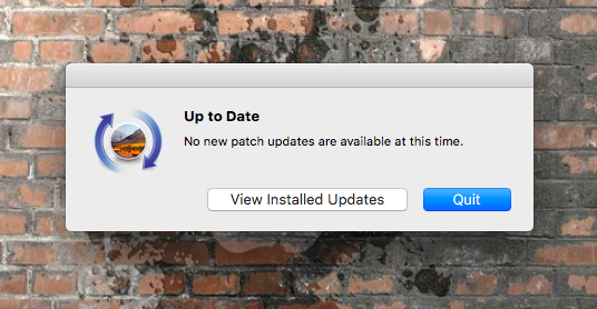

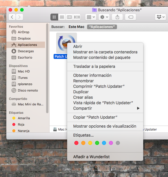

Captura de pantalla 2017-11-06 a las 18.01.06.png Captura de pantalla 2017-11-06 a las 18.01.18.png
It should be installed already in your /Applications/Utilities folder. If not, you can install it using the script found here.
Yeahhh is installed, sorry. But how can I Re-install patches??? Thanks and sorry.

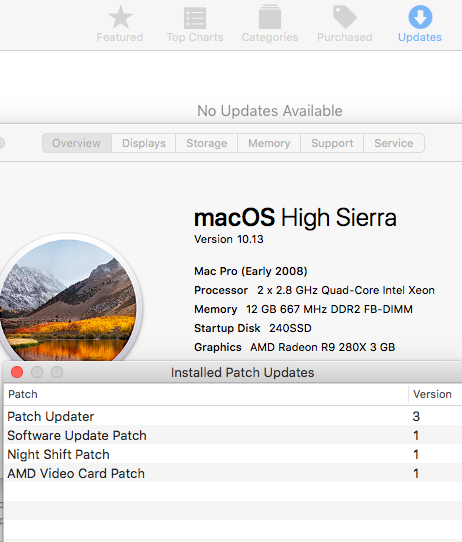

3,1 with r9 280x (flashed to Mac), Apricorn PCIe card w/SSD, fresh install. Been running this rock solid since the week the tool was released. Software update not available (tried re-applying this patch). I do see red flashes occasionally when resizing some apps etc, but that is the only issue I've experienced other than not seeing the update to 10.13.1.
Thank you, @dosdude1!
Try resetting software update catalog URL by running "sudo softwareupdate --clear-catalog" in Terminal, and see if the update shows then.
