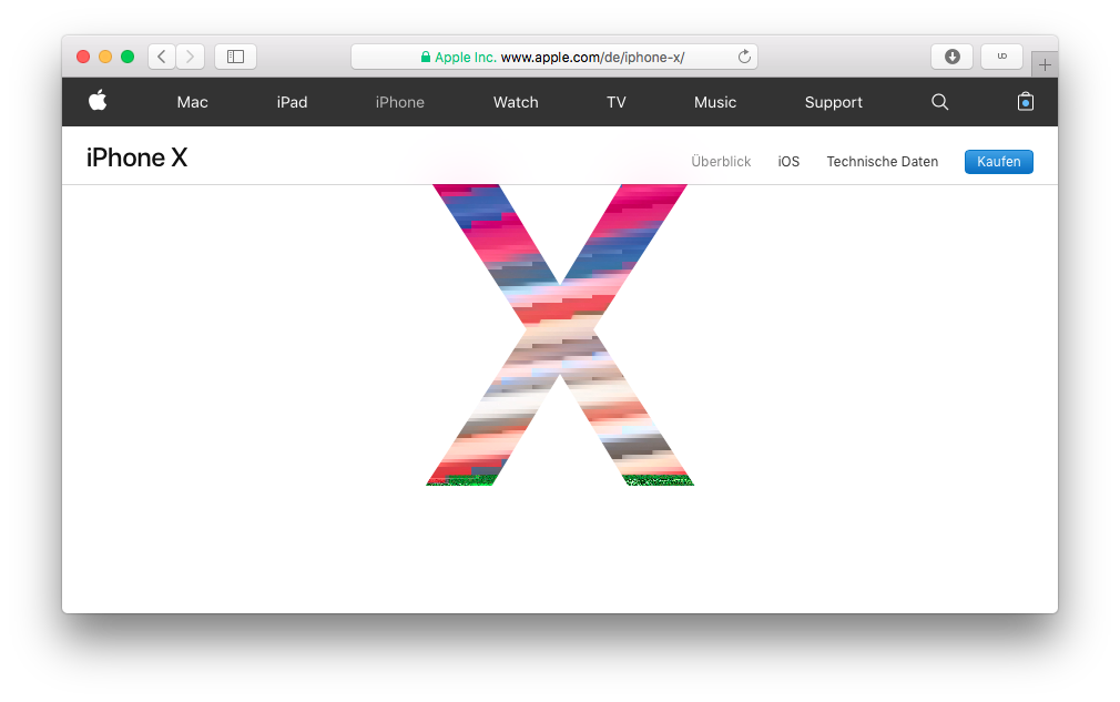

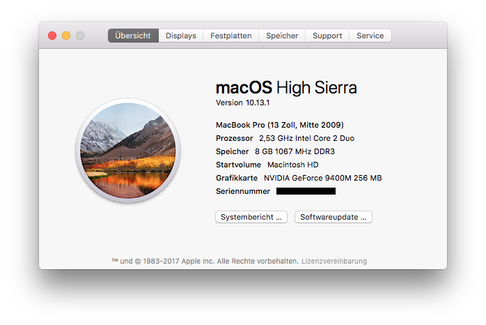

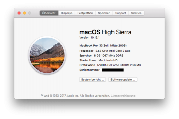

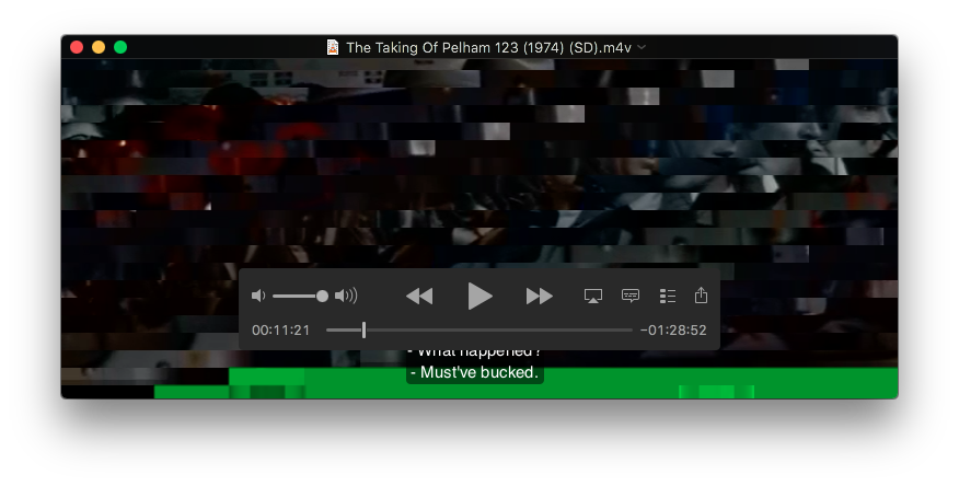

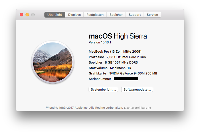

Upgraded MacBook Pro 5,5 (13", Mid 2009) from macOS Sierra directly to macOS HS using dosdude1's tool (version 2.4.0). Everything went smoothly so far:

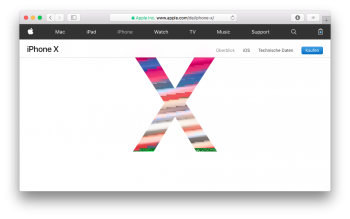

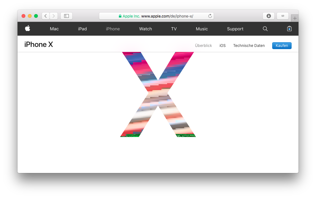

I am, however, also experiencing that weird graphics bug. It is, as usual, visible on Apple's iPhone-X-site:

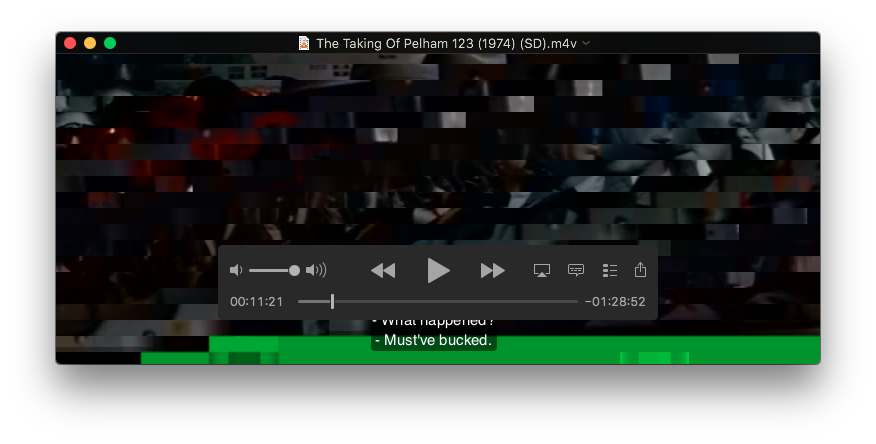

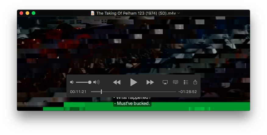

But it doesn't stop there: QuickTime Player is also affected. This is a screenshot of an attempt to view a h.264-encoded video file (MPEG-4 AVC part10 avc1, freshly encoded with handbrake 1.0.7) in QuickTime Player (VLC 2.2.6 plays the file just fine, though):
Weirdly, this seems to only affect videos encoded in macOS High Sierra. Video files I encoded earlier this week (when still running macOS Sierra) play fine in macOS High Sierra's QuickTime Player.
Any ideas how to solve this?
Aside from all this: Thanks a lot, dosdude1, for your wonderful work! Have been running macOS Sierra with your previous patcher software all along - my MacBook Pro still continues to soldier on even after eight years thanks to your amazing help!
We’re waiting on a patch from Apple. It’s a big even on newer systems too.

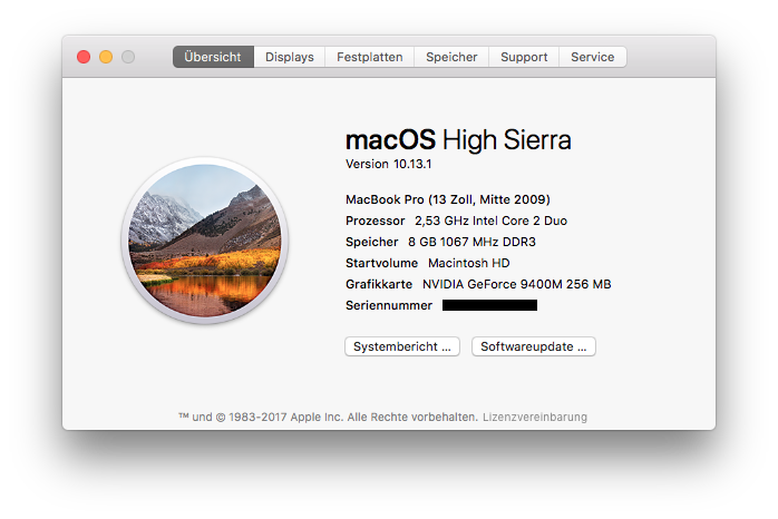

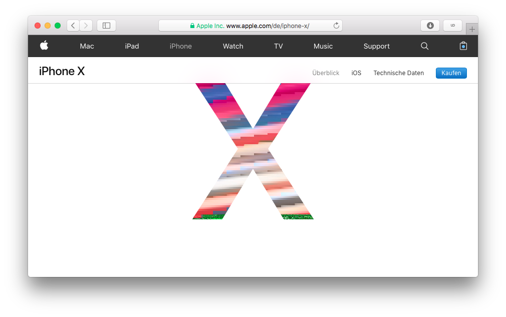

Same problem with the fully supported MacBook6,1, which has the same GPU.
So it’s probably a graphics driver issue which Apple needs to fix.
Any idea if it's going to be fixed in 10.13.2? And do you know if it's safe to continue converting media like I did using handbrake with the file mentioned above? I don't want to create lots of files that are not playable properly on future systems ...
I haven’t tried handbrake, but I would use a video format that you can view like mkv or that. May need VLC or IINA to play them
What settings are you using? They few Handbrake files I’ve encoded are fine.
I use the "Apple 1080p30 Surround" preset with the following modifications:
* Video > Encoder Options > Preset: > "veryfast" (instead of "medium")
* Audio > no AC3 passthrough
* Subtitles > "none" from source, adding an external .srt-file
As far as I know, handbrake 1.0.7 for Mac does not use the GPU for file conversion - at least not on Macs as old as mine. So any graphics driver issue for my GeForce 9400M shouldn't affect the conversion. But why does QuickTime only have trouble playing files converted using macOS High Sierra while it does play the files converted using macOS Sierra (and the very same handbrake version!) just fine?
If you'd like to test it, I uploaded a 10 seconds excerpt from the file converted in macOS High Sierra (620 KB) here:
https://www.dropbox.com/s/8ww0rz1g7hwg62z/test.mp4?dl=0
Yes, sure, but my media archive is h.264 m4v/mp4, I'd rather not switch from that just because of some weird bug on my current OS. And VLC can play all files just fine, regardless of whether they were created using macOS Sierra or High Sierra. But that's not the point - the question is if there's some permanent damage in files created using macOS High Sierra that may cause (unexpected) problems at some point in the future ...
@dosdude1, any ideas?
