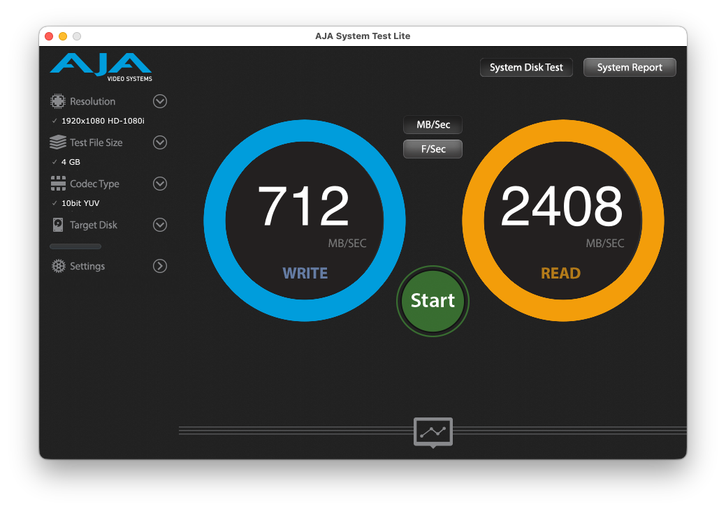

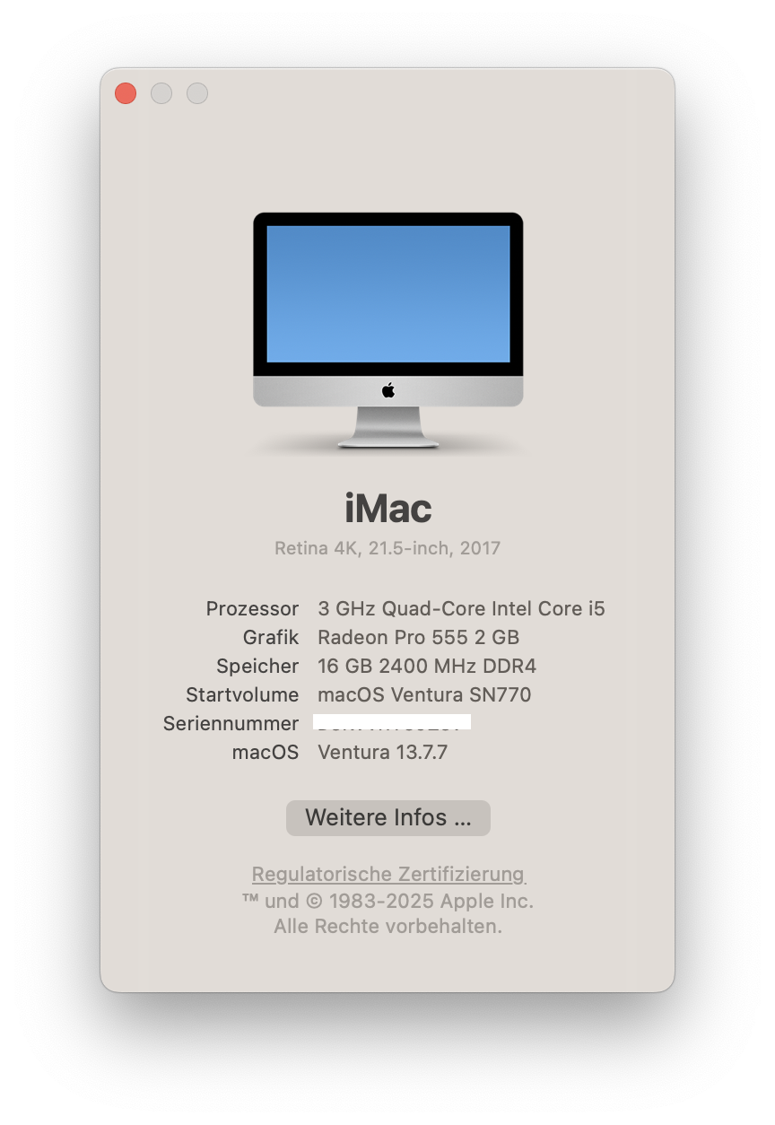

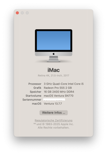

an external Thunderbolt SSD will must give about 3000 Mb/s, while an internal NVMe SSD will give half that.
I don't think so. PCI Express 3.0 x4 Lanes determines the speed.
Too it depends on the M.2-NVMe-SSD that's installed.
A WD Black SN850X in my upgraded iMac 18.3 achieves about 3,000 MB/s, while a WD Black SN770 in my upgraded iMac 18.2 achieves 2,500 MB/s.

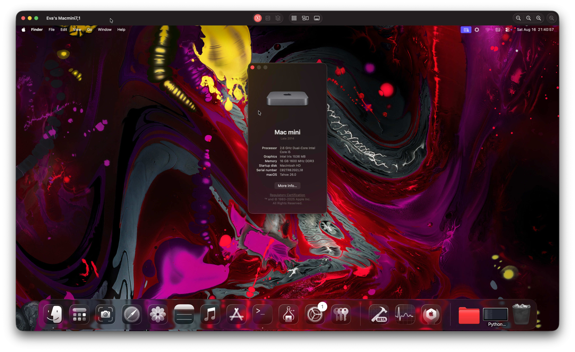

Hello Lucky, how's your iMac 14,3 working with Tahoe?
Are USB, Ethernet, and sound working for you?
Everything's working fine on my 14.2 iMac.

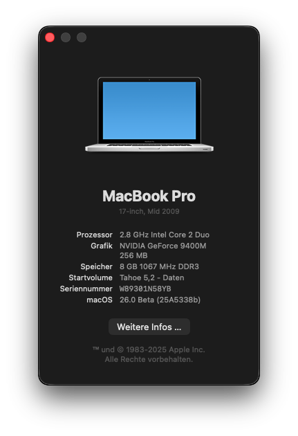

similarly MBP5,2: updated to 26.0b5 from b4, external SSD, with USB installer.
OCLP 3.0.0n used with slight source modifications (see 2nd text file below) to disable patching of wifi and audio. USB1.1, keyboard backlight and non-metal graphis patching left in place.
So internal keyboard/trackpad, backlight, facebook camera work.
Graphics is fast enough to write this (Firefox) but maybe slower than it was with b4. There are occasional window server crashes.
Anyway patched system boots (for this it needs the EFI with legacy USB map, installer and system without USB patches need EFI without legacy map).
Had difficulty to get a valid KDK so made the change to kdk_handler as shown. Maybe I was not waiting for long enough at the beginning of root patching (took more than 1/2hr for kdk finding).
No problems like with MBP11,1/26.0b5 during installation and power-off.
Still enjoying the MBP5,2 from 2009.
And the 2013 MBP11,1 is still my production system (with Sequoia).
Thanks developers!

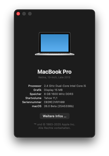

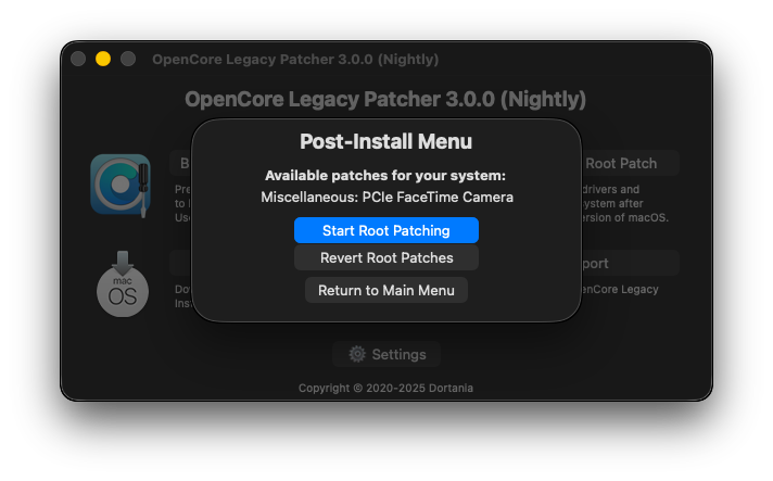

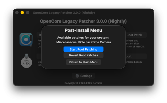

MBP11,1: updated to 26.0b5 from b3, external SSD, with USB installer.
OCLP 3.0.0n used with slight source modifications to disable patching of Haswell graphics, wifi, audio so only Facebook camera patched (which works).
Also manually put the two kexts for HD5000 and Framebuffer into /Library/Extensions (auxiliary kernel collection) where they live in Sequoia and earlier for this MBP11,1. This "clearly seems" to speed up graphics. If that impression reflects reality, part of the Haswell graphics patches may still be fine in Tahoe.

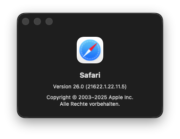

Installation was not so smooth this time: didn't reboot to the next step, so force powered-off then manually booted each time, but that proceeded to a bootable system. The public b2 has a slightly different build number as developer b5, will repeat with this one when InstallAssistant becomes available.
But good enough to write tihis in Safari 26.0. System quite usable overall. Thanks developers!
PS: system doesn't power off the normal way, consistent with the observation during installation.

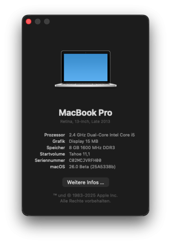

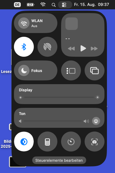

MBP11,1 updated to 26.0 b6 (25A5338b, like public b3) with USB installer, on external SSD.
Modified OCLP 3.0.0n (14 August) used for very limited root patching as in previous post.
Again manual power-off and reboot after each installation step, and normal power-off doesn't work, but resulting system is OK.
System usable and graphics looks OK (transparency reduced).
The log of the KP while powering off is attached.

MBP5,2 too updated to 26.0 b6. USB installer, external SSD.
Same modified OCLP 3.0.0n used for limited patching (non-metal graphics, but no wifi, audio).
Almost-smooth installation, failed once, resulting in the undesired extra - Data in volume naming, but no other negative effects.

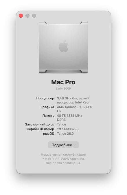

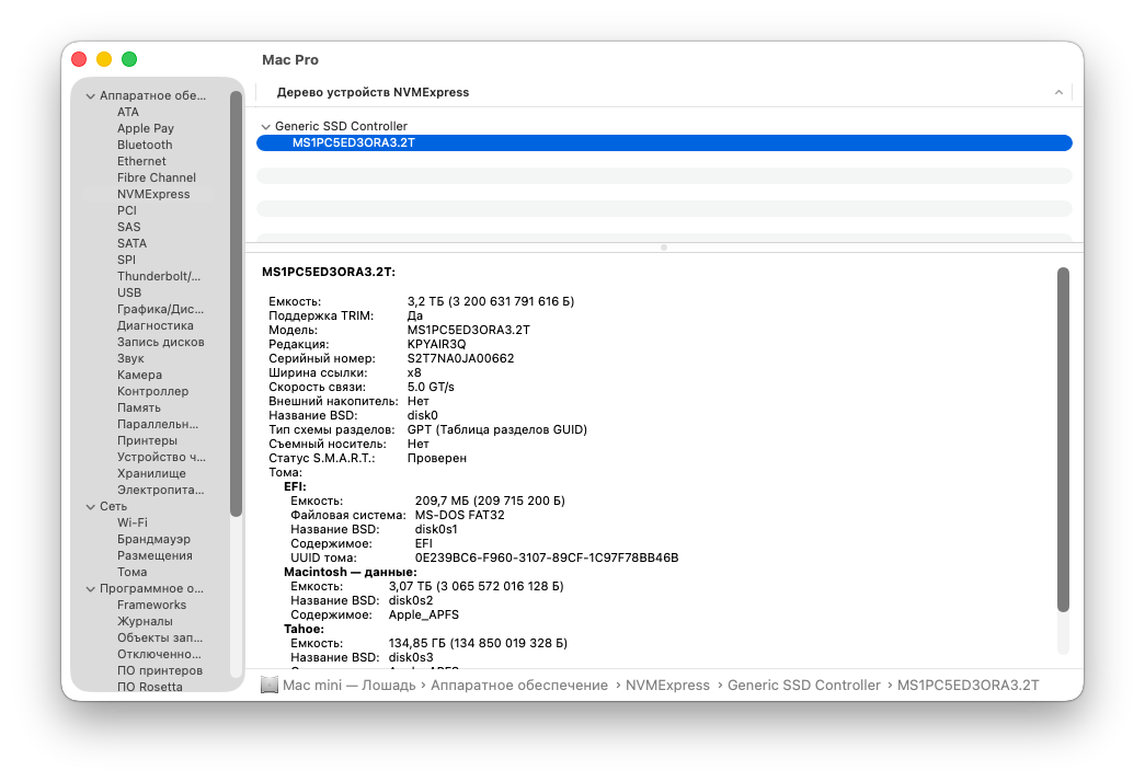

Maybe its being interesting for somebody else...
OS macOS Tahoe 26 Beta6
BootLoader compiled by OCLP 3.0.0 NB
MacPro 5,1 (flashed 4.1)
System boots with PCI-Express x8 SSD Samsung PM7125
As i know - its first macOS, that support this SSD OOB (also tryed on RaptorLake Hackintosh - works great!).
