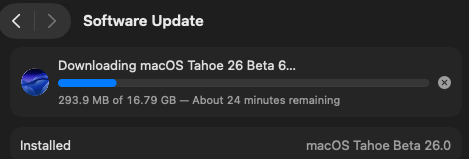

EDIT2: Smooth upgrade from Tahoe Beta 5 -> Beta 6 on my MBP6,2. Still waiting patiently for OCLP post-install patches.

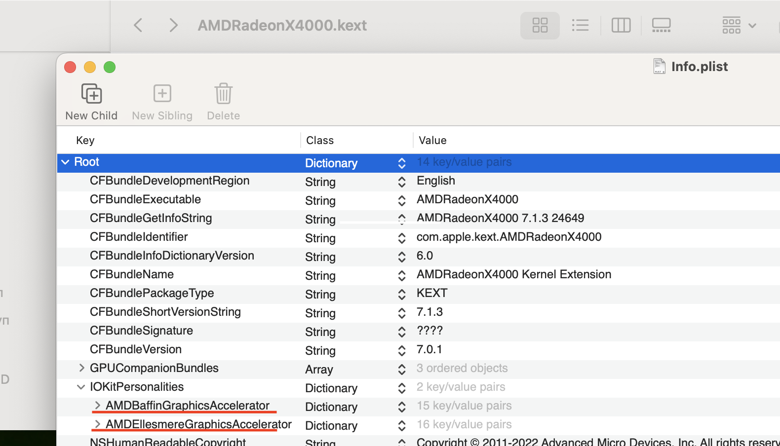

with an AMD Radeon RX570?
If your question is about GPU support. RX570 is Ellesmere, and Tahoe Beta 2 + supports Baffin and Ellesmere. I hope it stays that way.
It should work. You'll have to check it yourself.

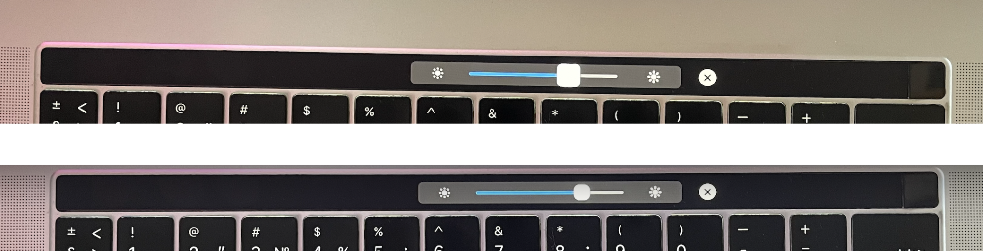

The image on the screen touch bar changes slightly when loading Tahoe Beta.

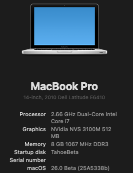

When I launch Tahoe on A1707 where T1 and Wi-Fi don't work, I really like it and I really want to have it there. When I launch Tahoe Beta on Mac Mini with M4, I want to go back to Sonoma. Maybe, i got crazy.

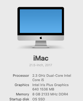

Do you think this will run about as well as Sequioa does on my machine or should I continue sticking with that? The only bottleneck has been the RAM for my usage. The work done on these is phenomenal and continues to breathe life into older Macs.
@Wasp14 I don't have your Mac, but I do have hacks with Radeon Polaris dGPUs and Intel UHD630 iGPUs, all with 32GB RAM. After making some performance tweaks mentioned earlier in this thread, I don't notice any performance difference between Sequoia and Tahoe on these "unsupported" machines. Your Mac has only 8GB RAM, so it's impossible for me to compare, but I'd remain optimistic if I were you.
