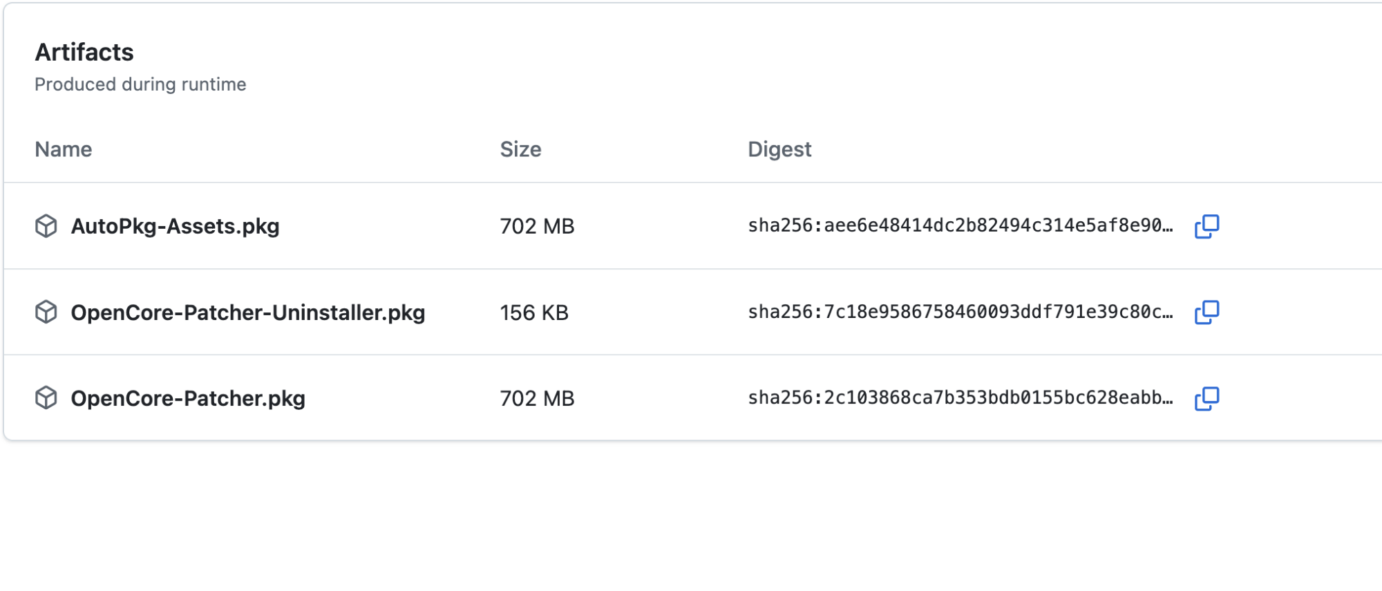

Can someone please verify if this or is not the latest 3.0.0 nightly build. Please note that out of respect for the Dev's there are no clickable links shown.
This is the last modification to OCLP 3.0.0 beta:
Artifacts​
Produced during runtime
NameSizeDigest
AutoPkg-Assets.pkg709 MBsha256:1ad26a405b0ed4d9b010980c8ab0db5e529473cfcb226a3c49dce1aa5fcc6750
OpenCore-Patcher-Uninstaller.pkg156 KBsha256:5e2f8f5b5667a66c04b60d03e85aea42a71662a5d9576a466c06f628af0e5aa5
OpenCore-Patcher.pkg709 MBsha256:a98df2d4ce41d70347f02bd2ad645d5217399668185e91e039db7237efa925c9
OpenCore-Patcher.pkg 709 MB sha256:a98df2d4ce41d70347f02bd2ad645d5217399668185e91e039db7237efa925c9
Thank You for replying, your number is much different than mine. I have just been refreshing the page thinking that when a new update was available it would change, now I finally know that is not the case. I hope now I can get back to the right place. I don't want to impose but help would be appreciated. Thanks again.

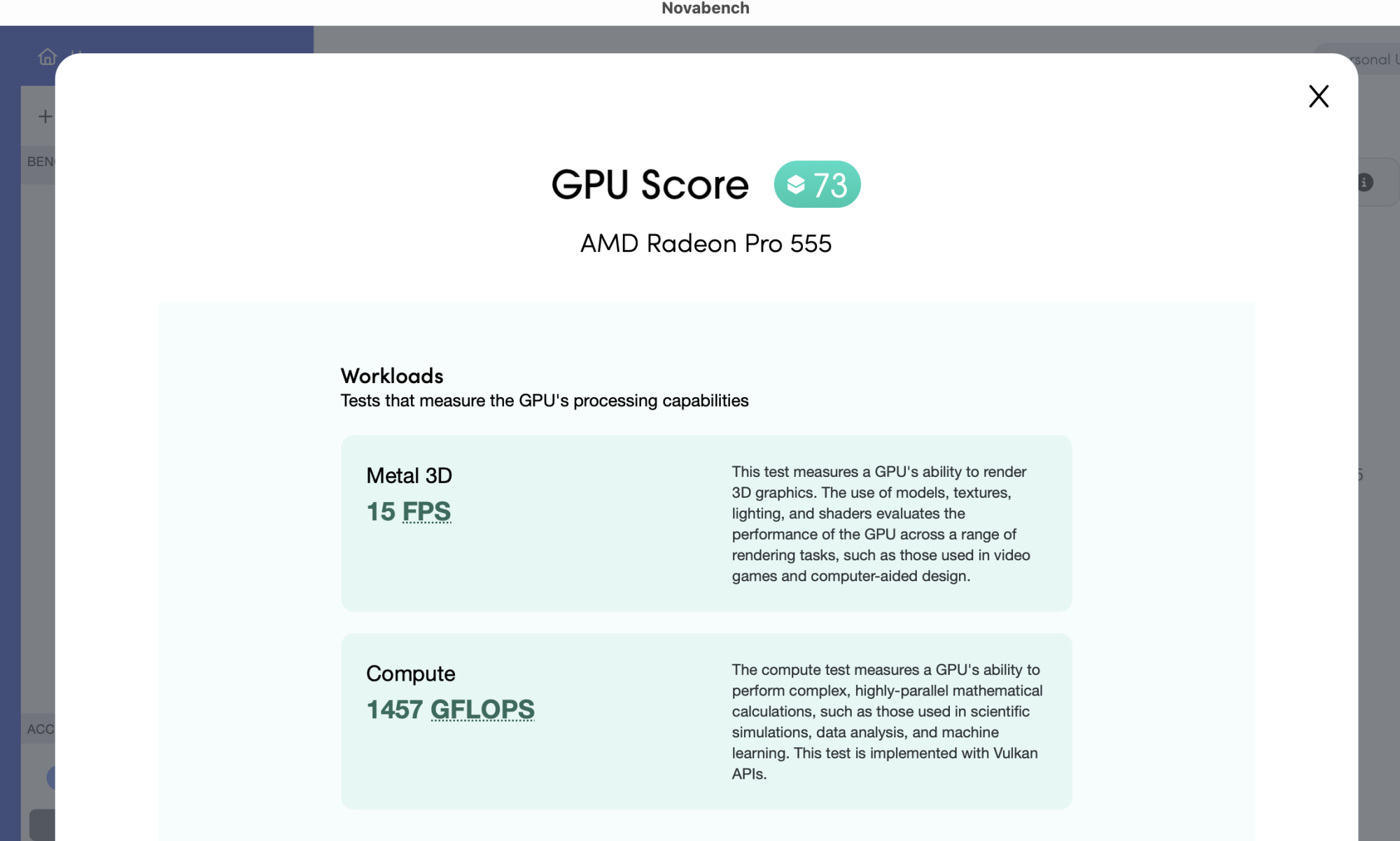

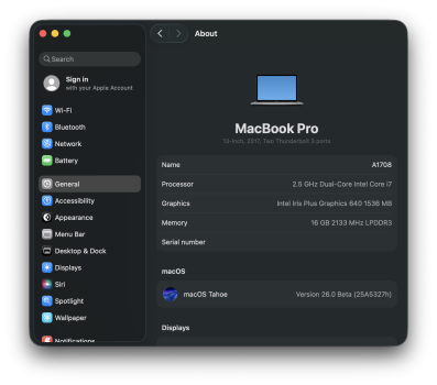

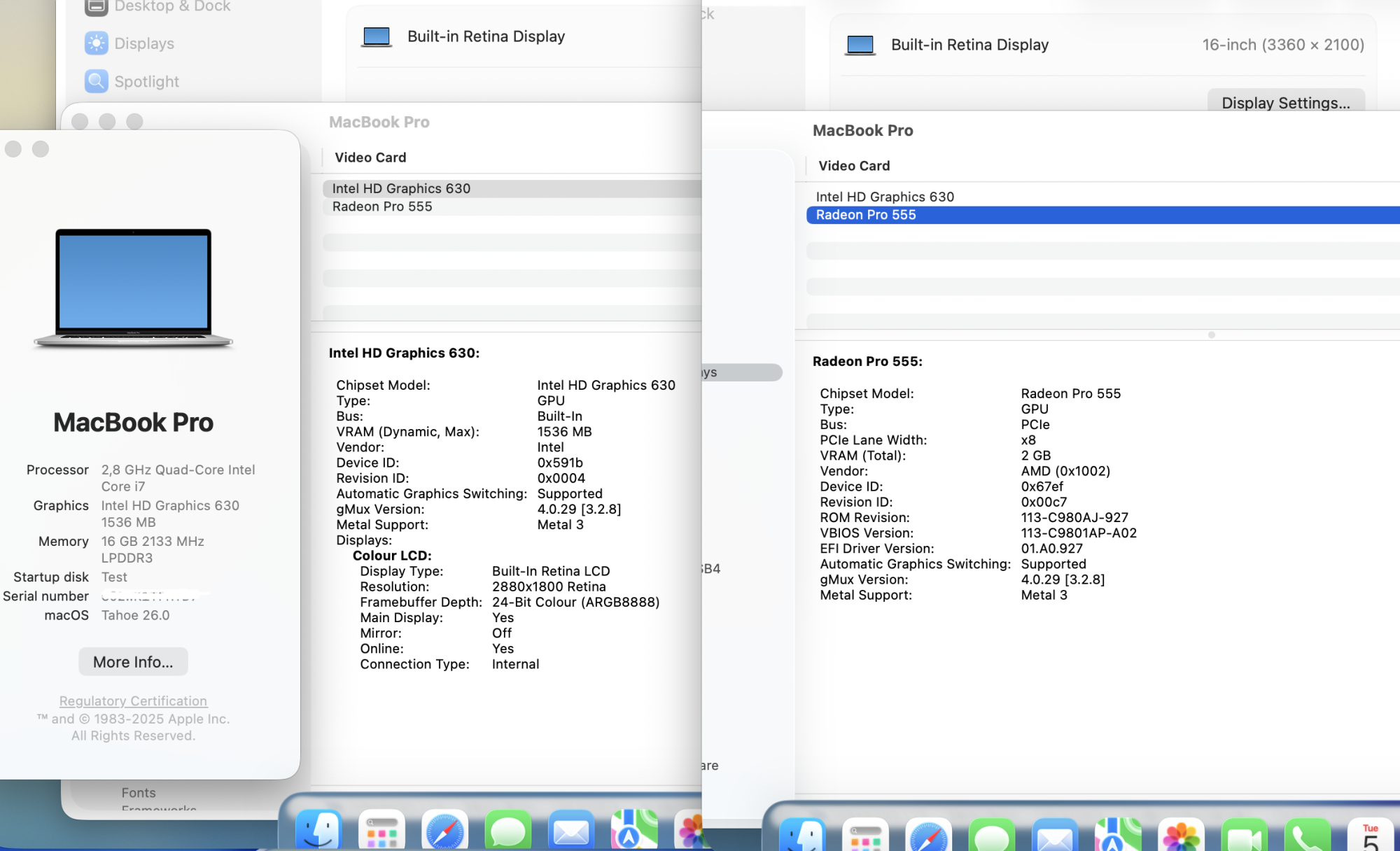

A1707 2017. Full support for HD630 and Baffin Radeon 555 Pro has been discovered in the public beta.
No fixes or patches. Works as is.
Radeon began to use a different port, for this reason it did not work on the internal display. After fixing it works. There is no black screen when starting the Photo application and the internal display does not go out when connecting an external monitor. Radeon passes tests (for example, Novabench).
There is no more good news. The screen brightness is not adjustable. Black screen after waking up. Probably T1 will work conditionally: system accept the user password, but not accept the administrator password.
Support for previously unsupported video accelerators may be temporary or erroneous.

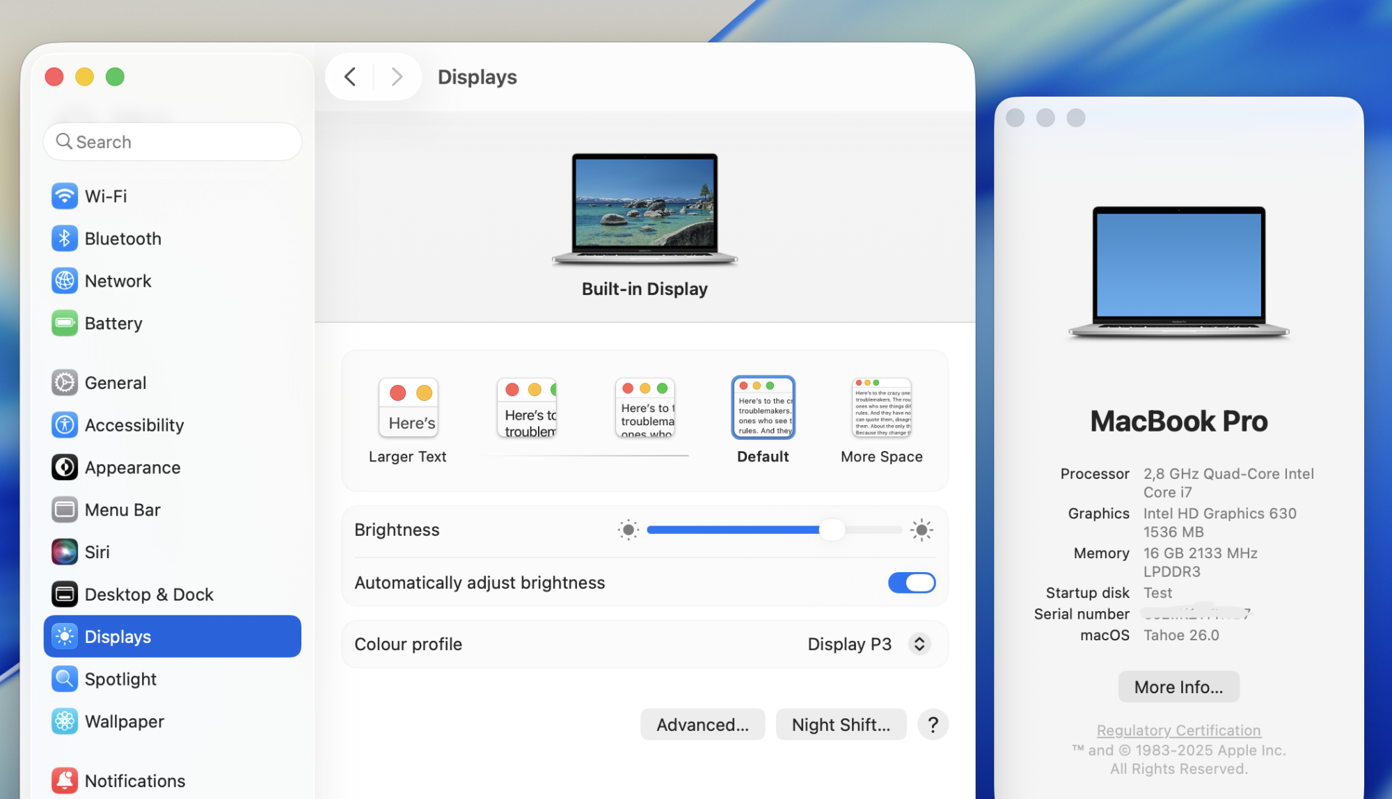

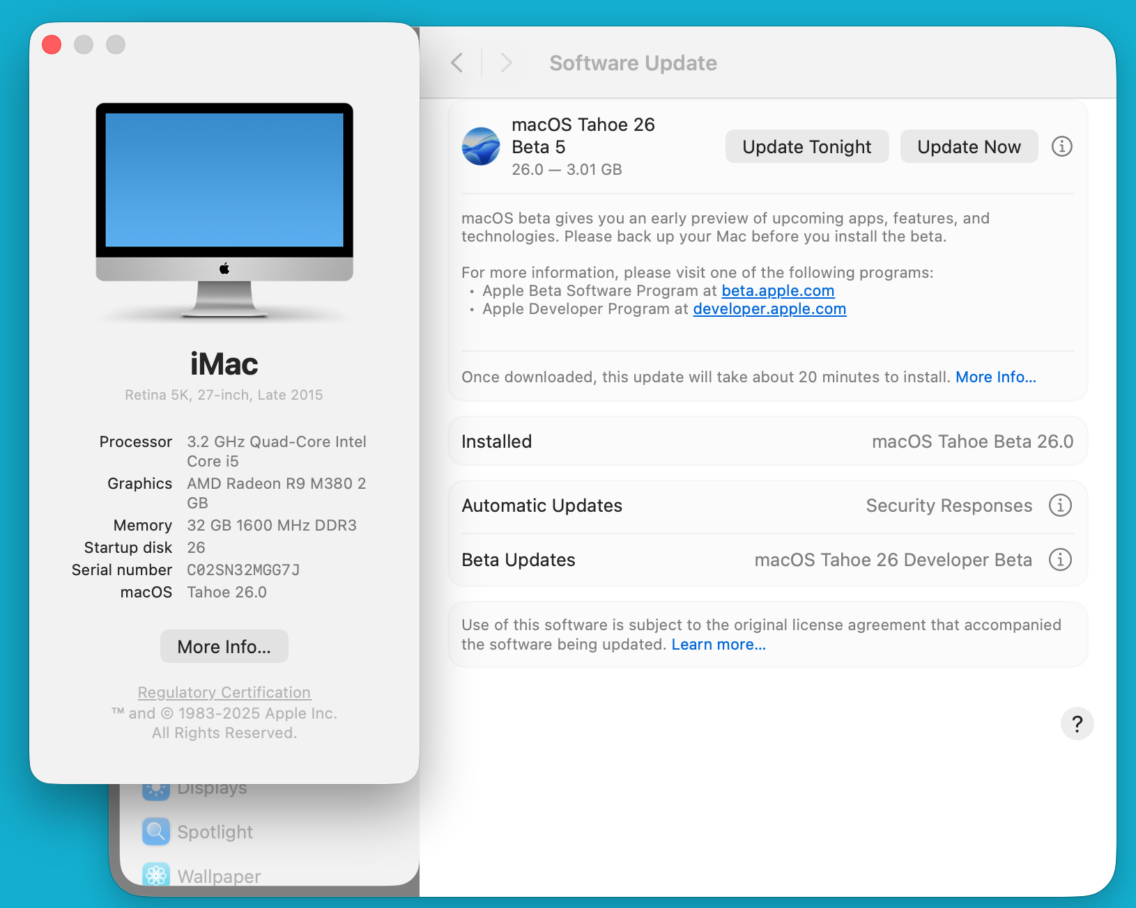

T26b5/3.0.0n installed OTA 3.01GB, it took a restart for everything to come up but all is working as before, some small differences, the apps that replaced launchpad still quickly disappears, but it can be opened from the finder. Still no patches from OCLP. There was a mail update. Firefox works very well. Safari looks very different but I don't use it.

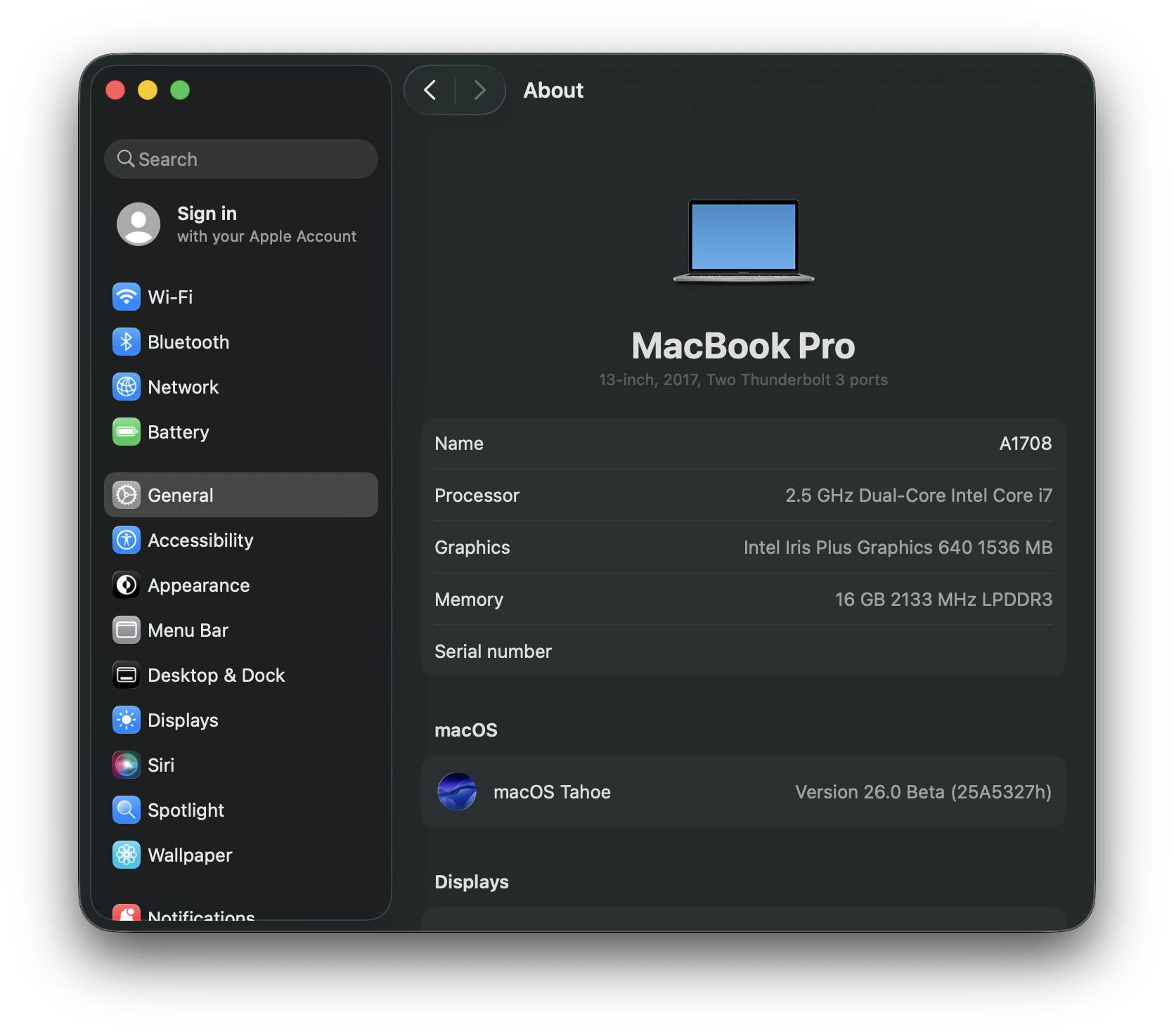

Smooth OTA upgrade from Tahoe Beta 4 -> Beta 5 on my MBP6,2. OTA upgrade downloaded the full 16.7GB installer in my case. Still patiently waiting for OCLP non-metal post-install patches. At this time, my bar is low, so I'm just impressed that the install completes and I can login.
Note that I did need to decrypt my Tahoe volume after applying the Beta 4 -> Beta 5 update (I believe this is because the update was applied with the full installer and not an incremental installer) by following the steps here.

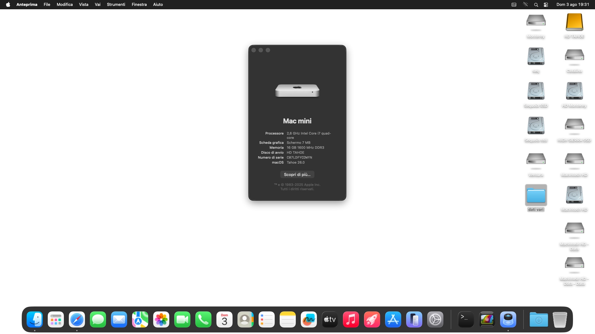

looks good... no wifi... yet...

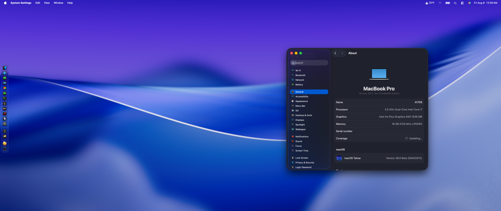

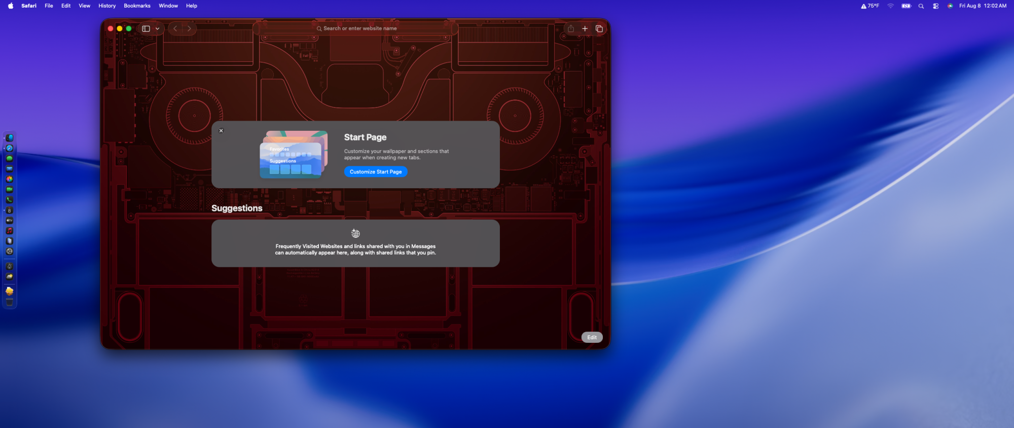

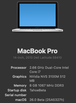

looks good with no patching... yet...
