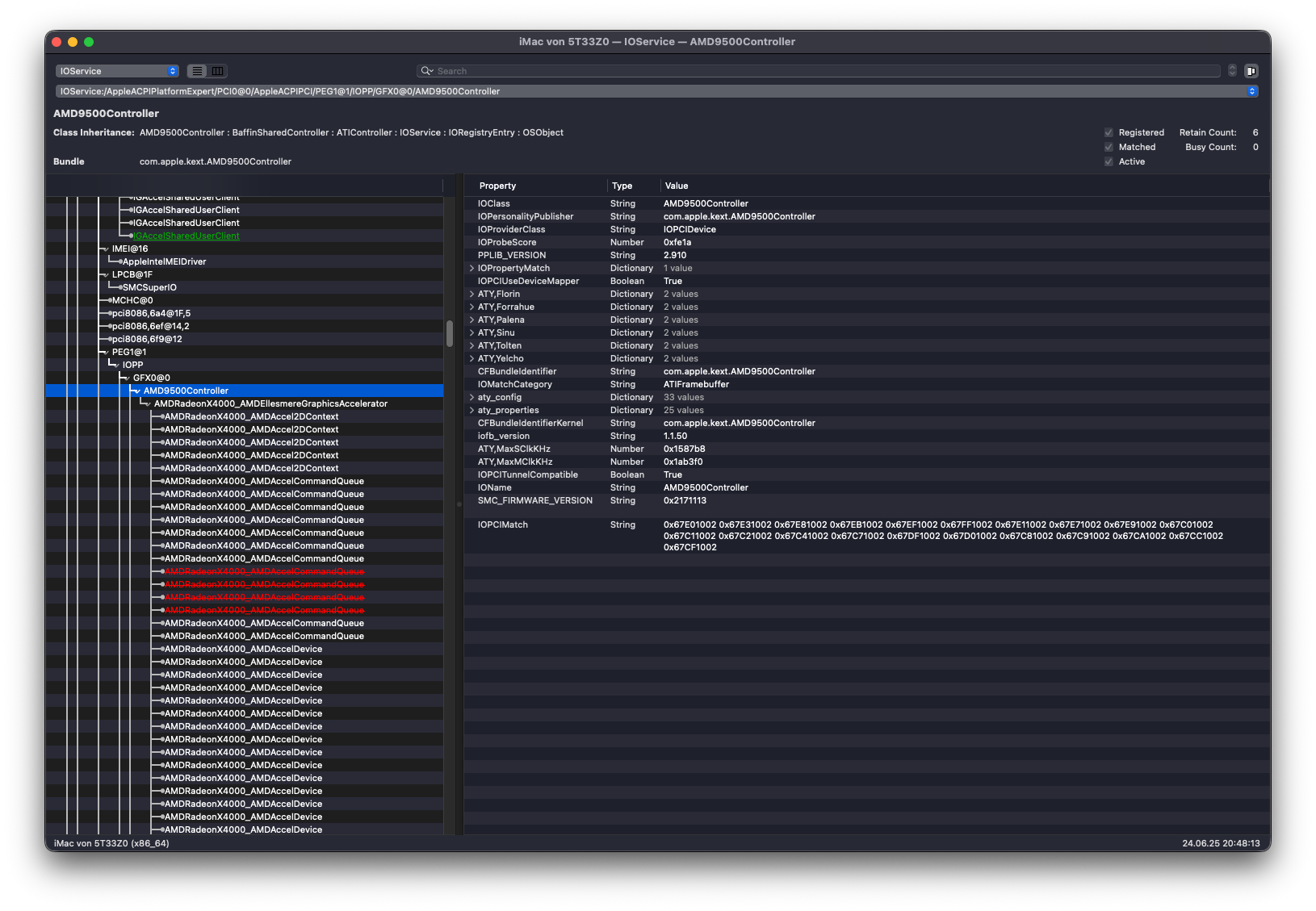

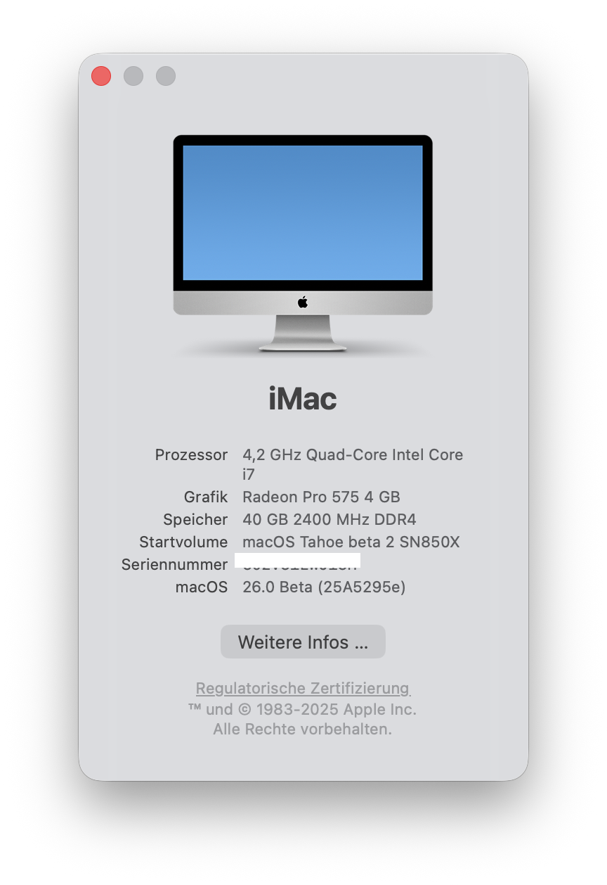

I managed to get my Radeon RX580 back to work in beta 2. I had to disable Whatevergreen during Install. Otherwise the progress bar would get stuck early. Once the install was completed, I enabled it again and rebooted. GPU is working fine now.

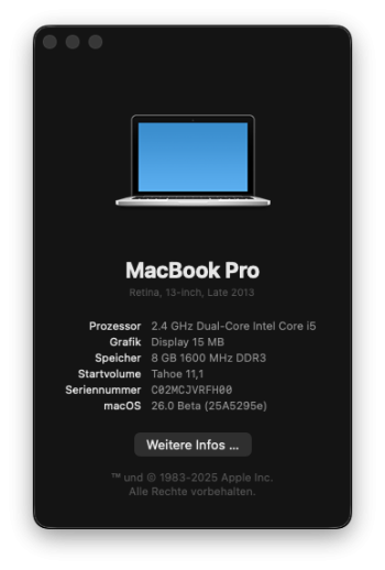

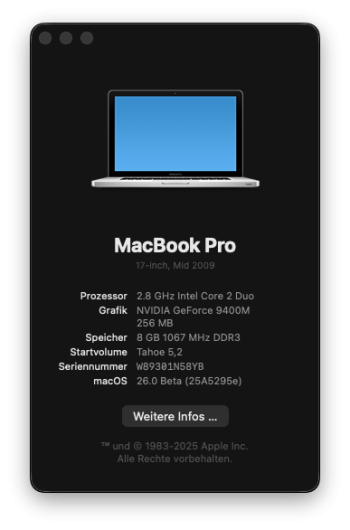

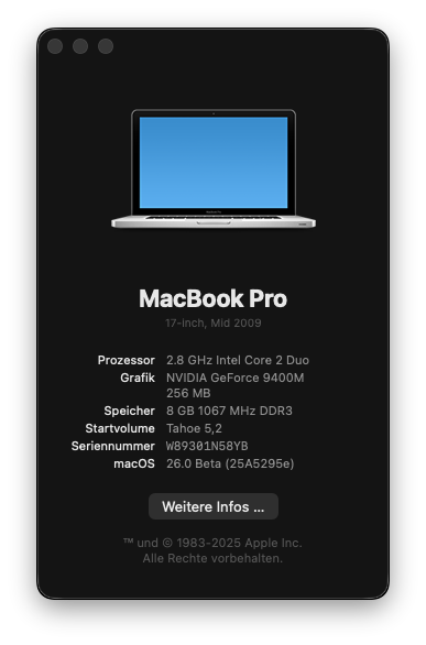

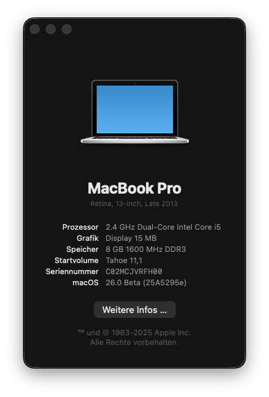

MBP11,1 and MBP5,2: success with installing, booting and logging into Tahoe 26b1.
In both cases, using external SSD connected to onboard USB and made clean install. EFIs generated with OCLP 2.4.0 and modified in-place (on target SSD) to use OC 1.0.5 and the respective Info.plist in USB-Map.kext. Thanks again deveedee and others! See post #67.
Also in both cases, needed to first install Sequoia 15.5 from USB installer, and do all the fresh setup (no data migration), and then install 26b1 over it from USB installer. Without first having Sequoia, after clean install of 26b1 I was unable to proceed beyond login as it seemed that system assistant got stuck (3rd picture, from MBP5,2) - maybe it would just have taken longer than the 1hr I waited. Thanks to Larsvonhier for his remark earlier in the Tahoe posts.
So far so good or even excellent for this 1st beta - didn't expect more at this point.
MBP11,1: updated to 26.0b2 from b1.
On external SSD, using USB installer made from InstallAssistant.pkg downloaded via Mr.Macintosh. Installed over b1 which was installed over clean installation of 15.5 (direct clean Tahoe did not get beyond login/password entry).
Using same OCLP EFI as before, i.e. a modified 2.4.0.
Running at usable speed after letting it calm down for >1hr, until the Dock appeared at all. No patches applied. Writing this post from Safari on this Tahoe system.
Thunderbolt Ethernet working.
Sound not working.
At this early state of Tahoe, that means happiness...

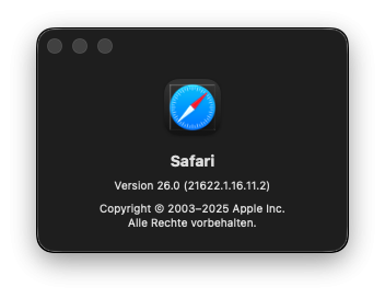

Didn't get Safari to work yet.

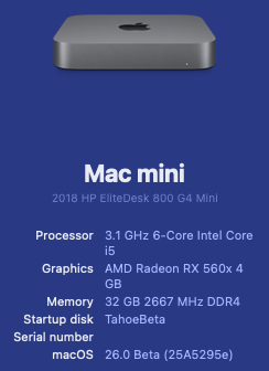

I got myself into a little mess with FileVault enabled in Tahoe Beta 2 on my HackMini8,1. FileVault would not accept my password. I booted into Tahoe Beta Recovery, but was unable to unlock and decrypt through "normal" mechanisms. I was able unlock and decrypt by booting into Tahoe Recovery as follows:
  1. Boot Tahoe Beta 2 Recovery
  2. Select Tahoe Beta Volume to recover
  3. Open Utilities > Terminal
  4. execute 'diskutil apfs listUsers [Tahoe Beta Volume] to view user UUIDs and note the UUID for 'Local Open Directory User' (where Tahoe Beta Volume is /dev/diskXsY)
  5. execute 'diskutil apfs decryptVolume [Tahoe Beta Volume] -user [UUID noted in step 4]
  6. when prompted for password, enter your user password for your Tahoe Beta Volume
The encrypted volume should start to decrypt. Monitor decryption progress with 'diskutil apfs list'
After decryption is complete ('diskutil apfs list' reports FileVault 'No' for your Tahoe Beta Volume), reboot. You should now be able to boot and login to your Tahoe Beta Volume without FileVault.

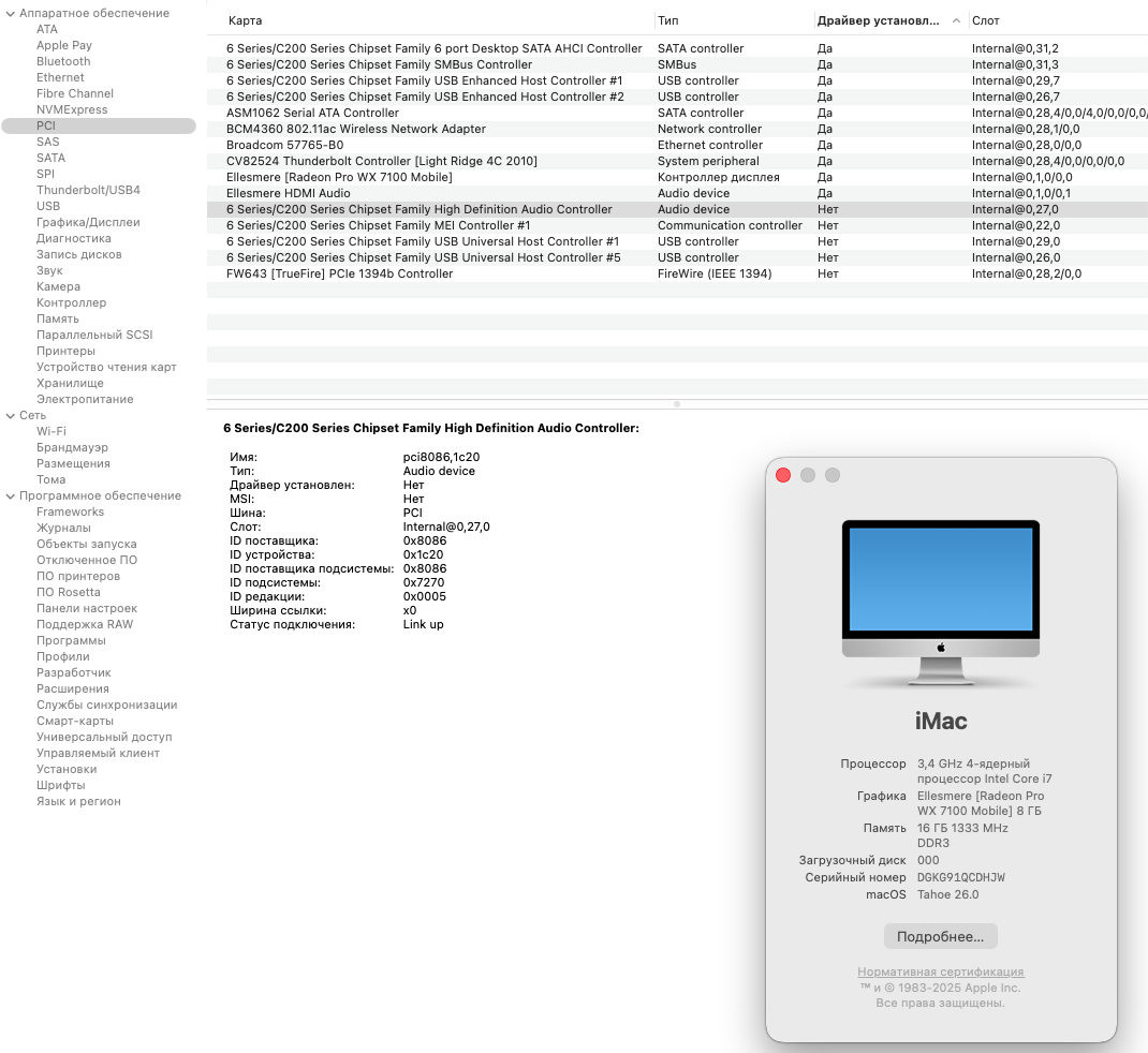

Has anyone successfully run Tahoe beta 2 in Parallels VM on MBA 2016 running Sequoia 15.6 using OCLP?

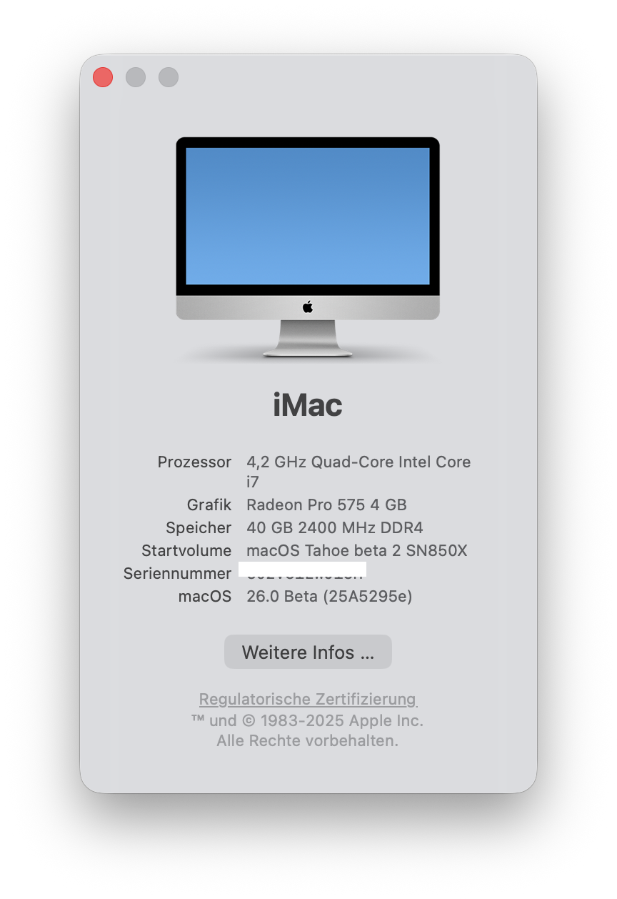

Last Tuesday, I installed macOS 26 Tahoe @OCLP 2.4.0 on my 18.3 iMac.

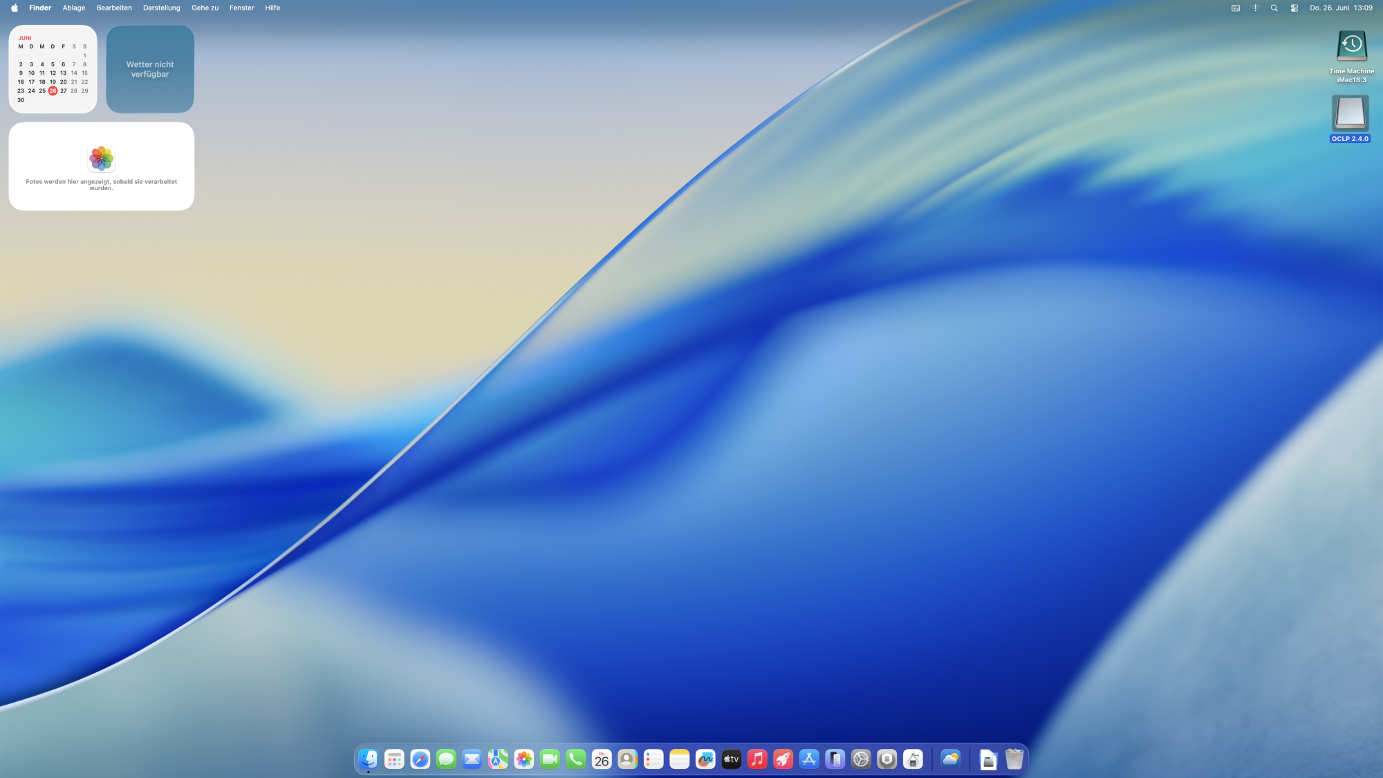

It took a little longer than with other supported macOS versions, but Tahoe was finally ready to boot.

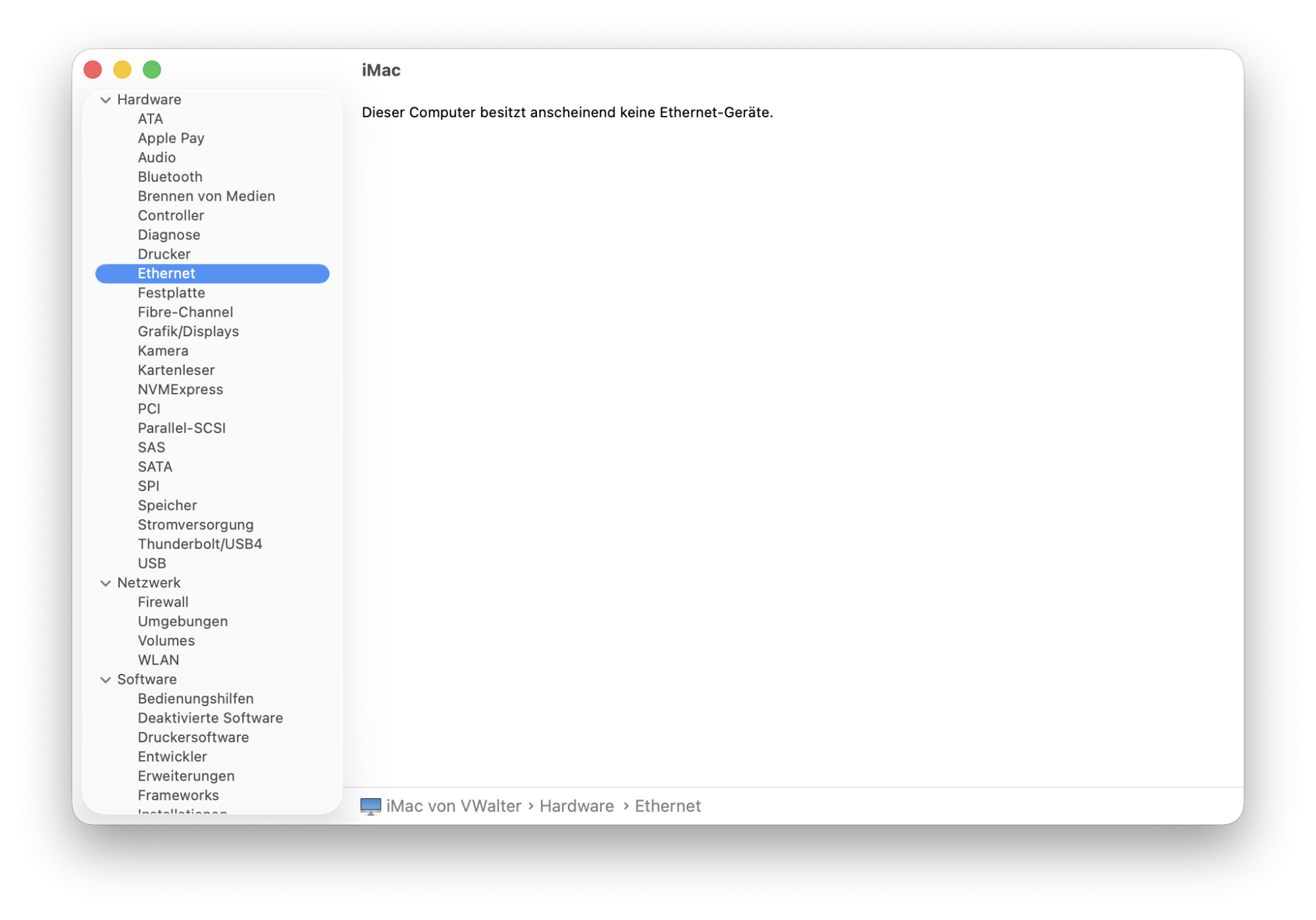

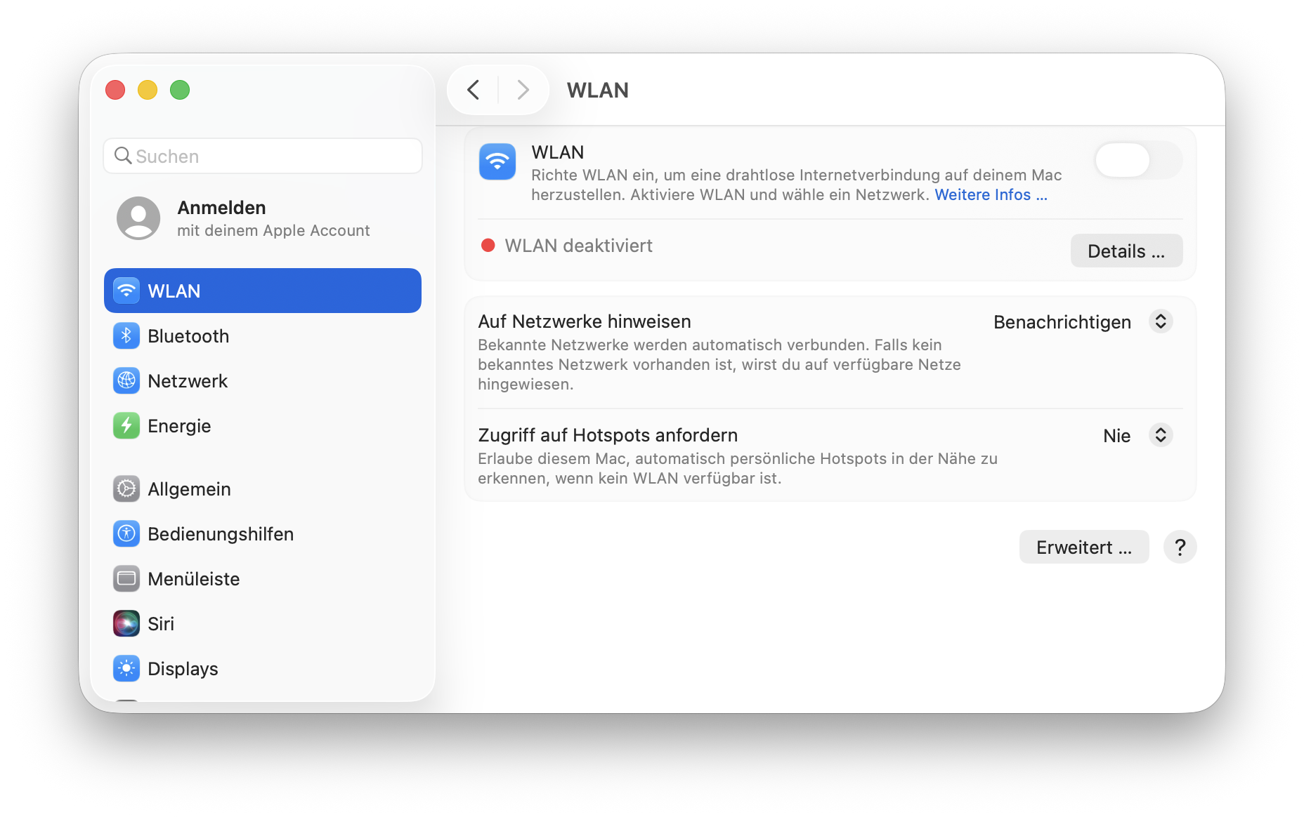

A quick check of the system settings showed that Bluetooth was fully functional, but there was no network. The lack of Wi-Fi was to be expected, but the fact that LAN didn't offer anything either was surprising.

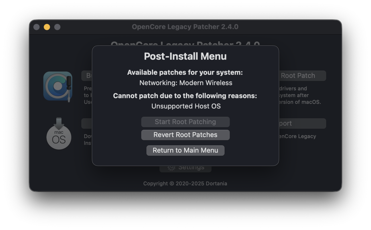

So I opened the OCLP app to perform the post-install and experienced the next surprise:

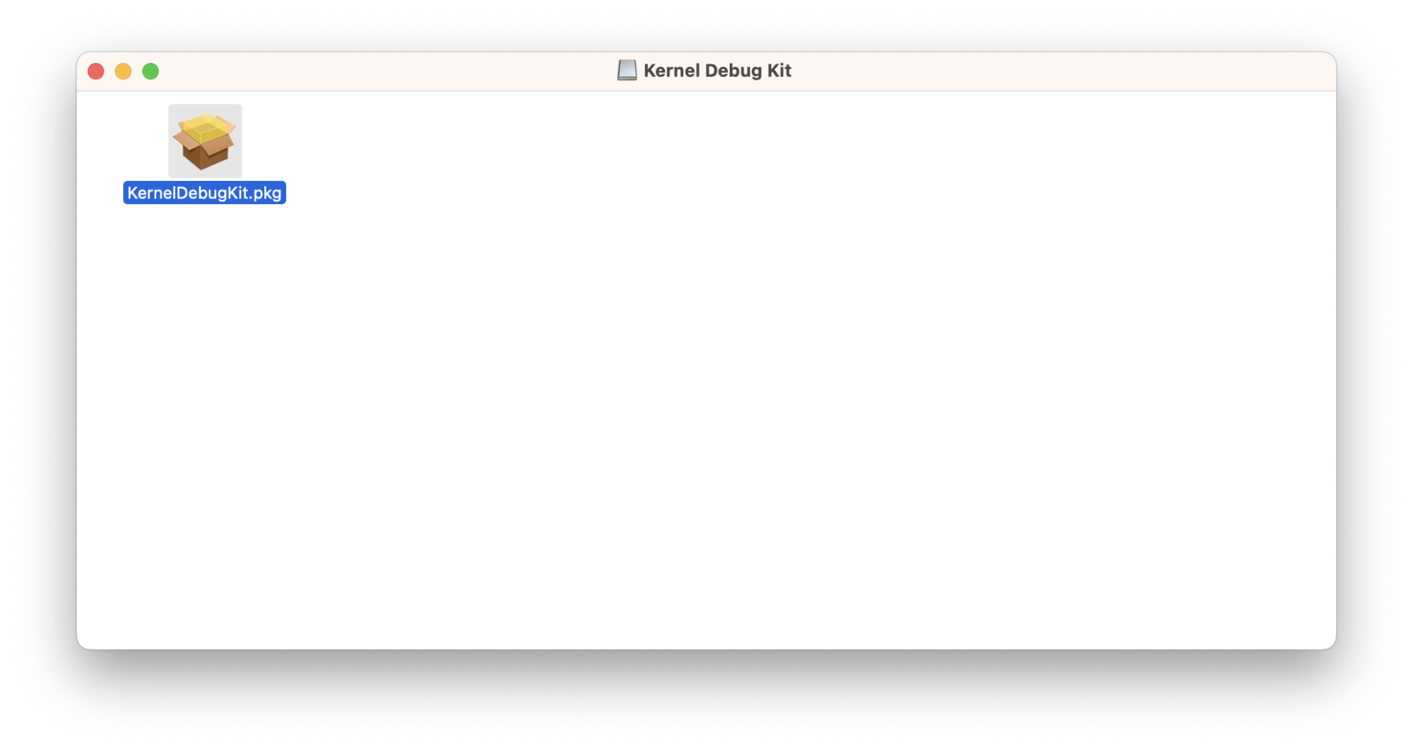

A little online research did yield the Kernel_Debug_Kit_26.0_build_25A5279m.dmg ...
..., but how to integrate it to OC 2.4.0 is a bit beyond my capabilities.
What would I need to do to at least establish LAN?

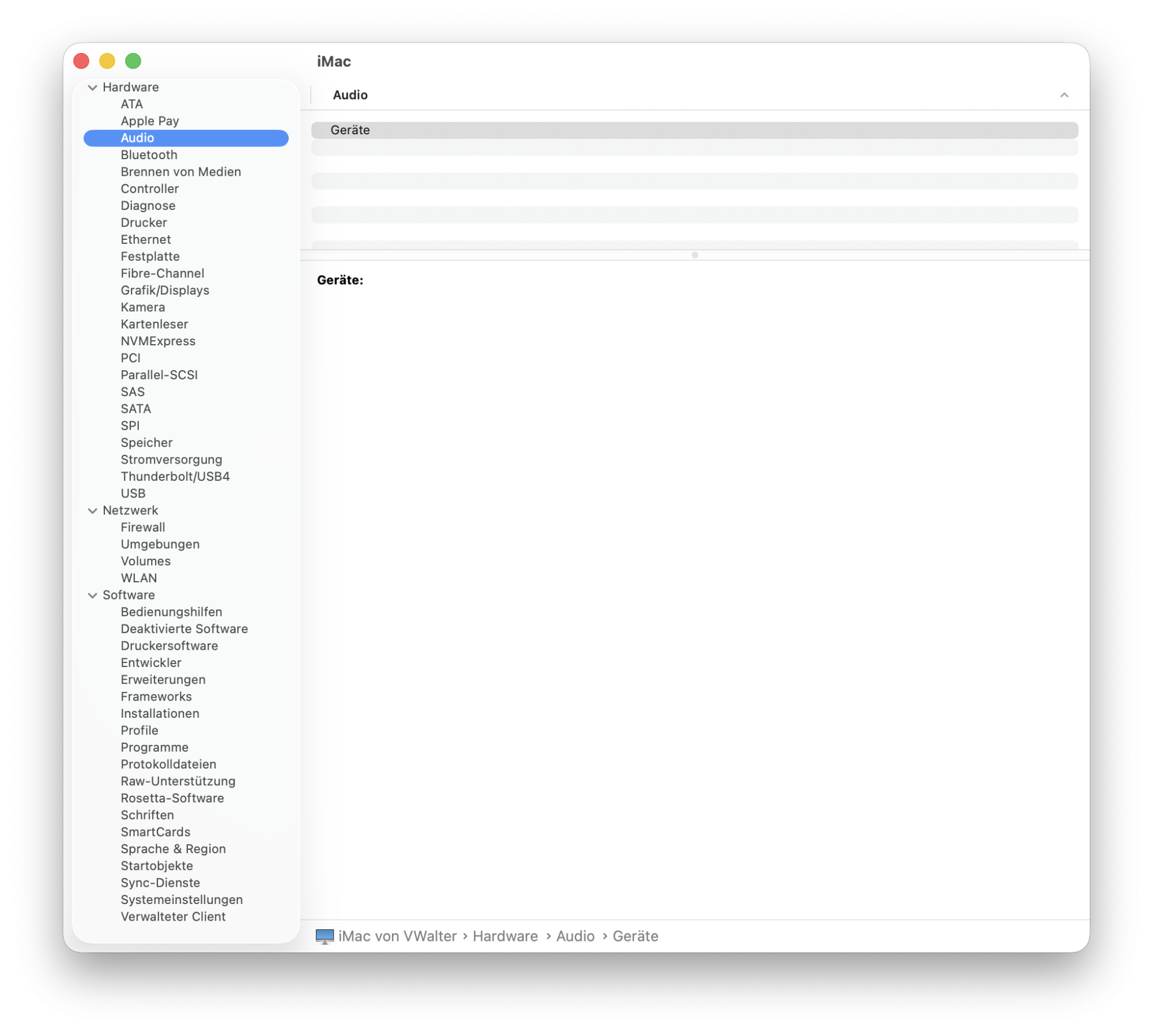

Also Audio doesn't work.
Related suggestions are welcome. :)

Can you send your config.plist? I'll try to turn on the wi-fi.
The appropriate KDK is pulled automatically by OCLP if OCLP supports the current macOS to be patched (contingent upon the KDK's availability from Apple). See here for my modified OCLP results where I simply changed OCLP's macOS constants for Tahoe compatibility.
To properly patch Tahoe, we'll need an OCLP modified for new frameworks in Tahoe.
I know that, but I remember a very similar situation when OCLP didn't download the correct KDK (some version of Sonoma?), but one was able to manually install it with the correct KDK.
I was hoping for a similar effect, but I don't remember how I did it back then.

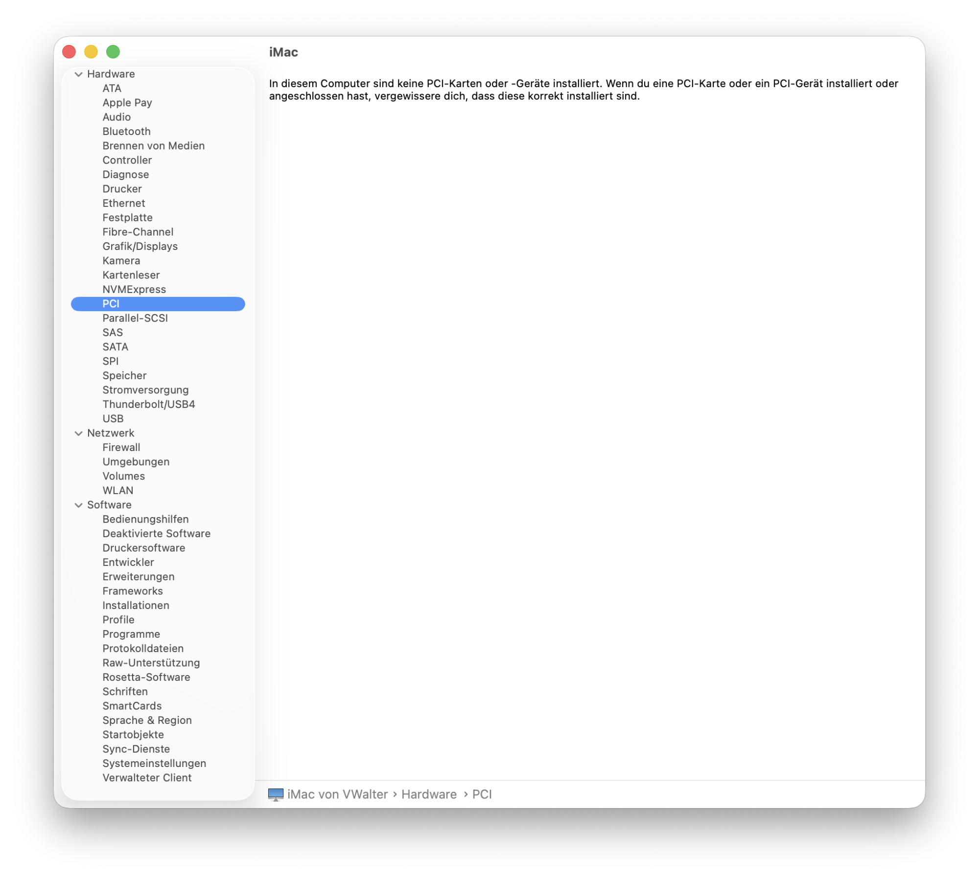

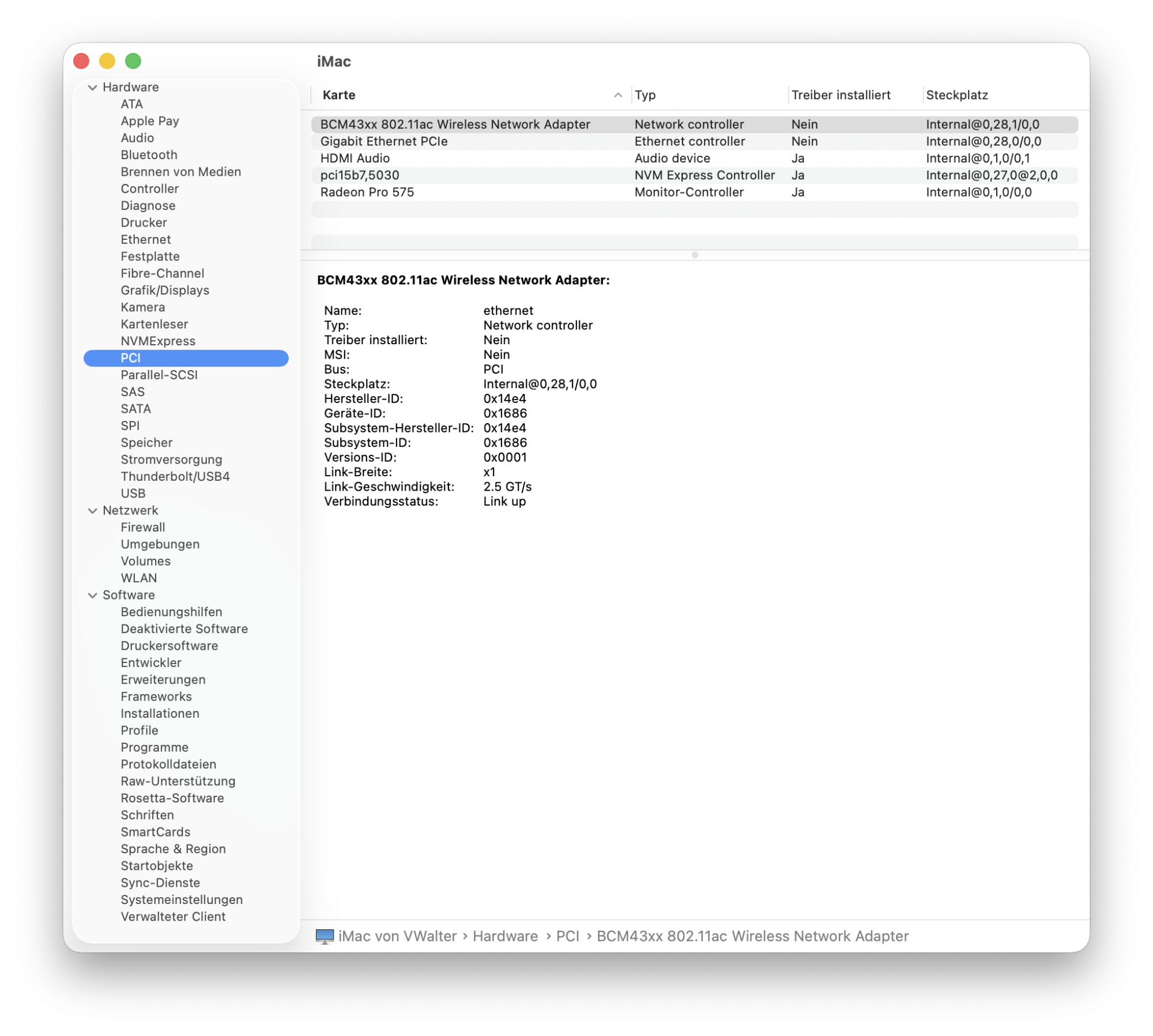

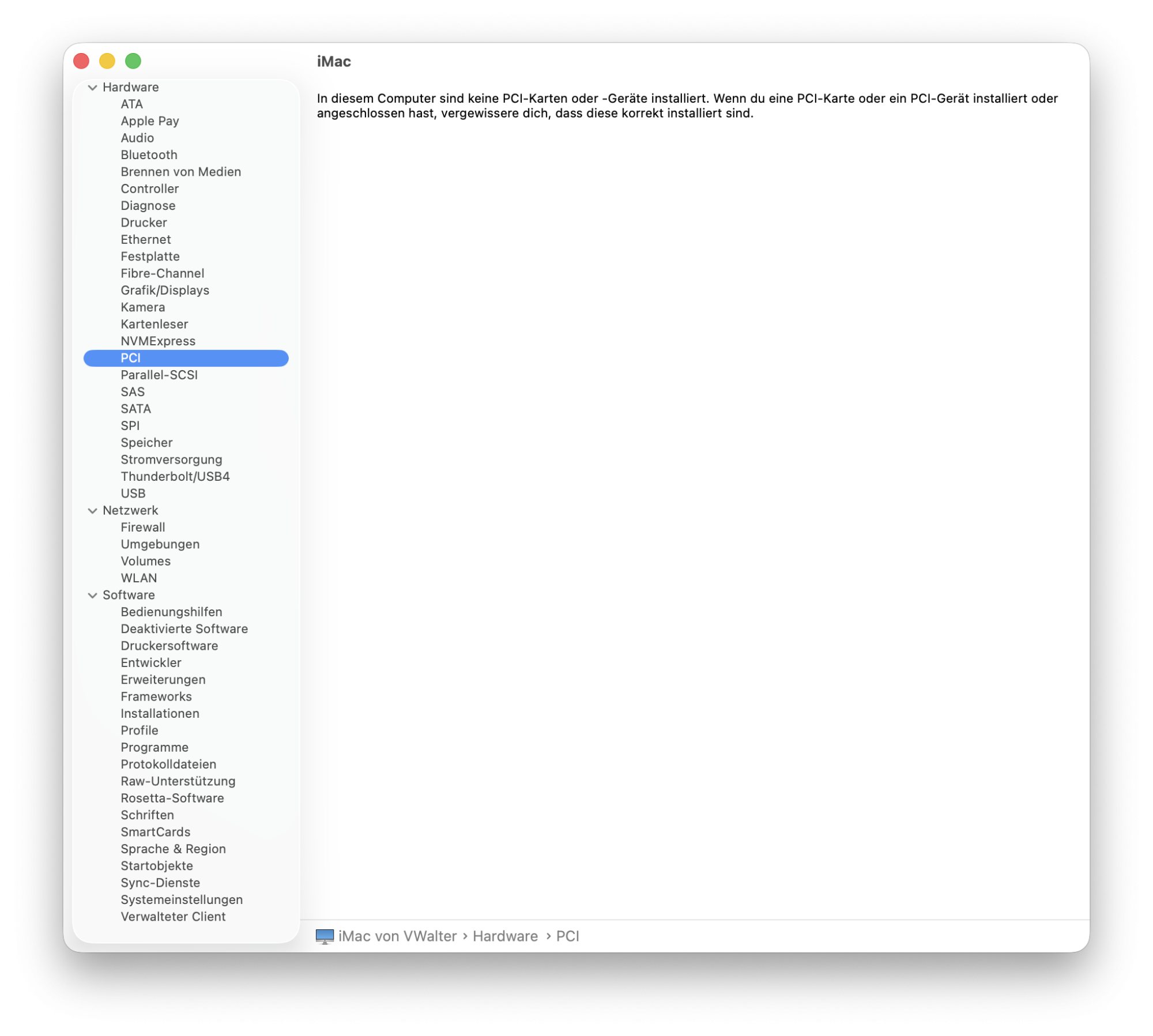

Try this first. Let me know how you are doing in the PCI tab.
I did get some changes - of course. ;)
First pic ist config.plist-standard - second after your modification.

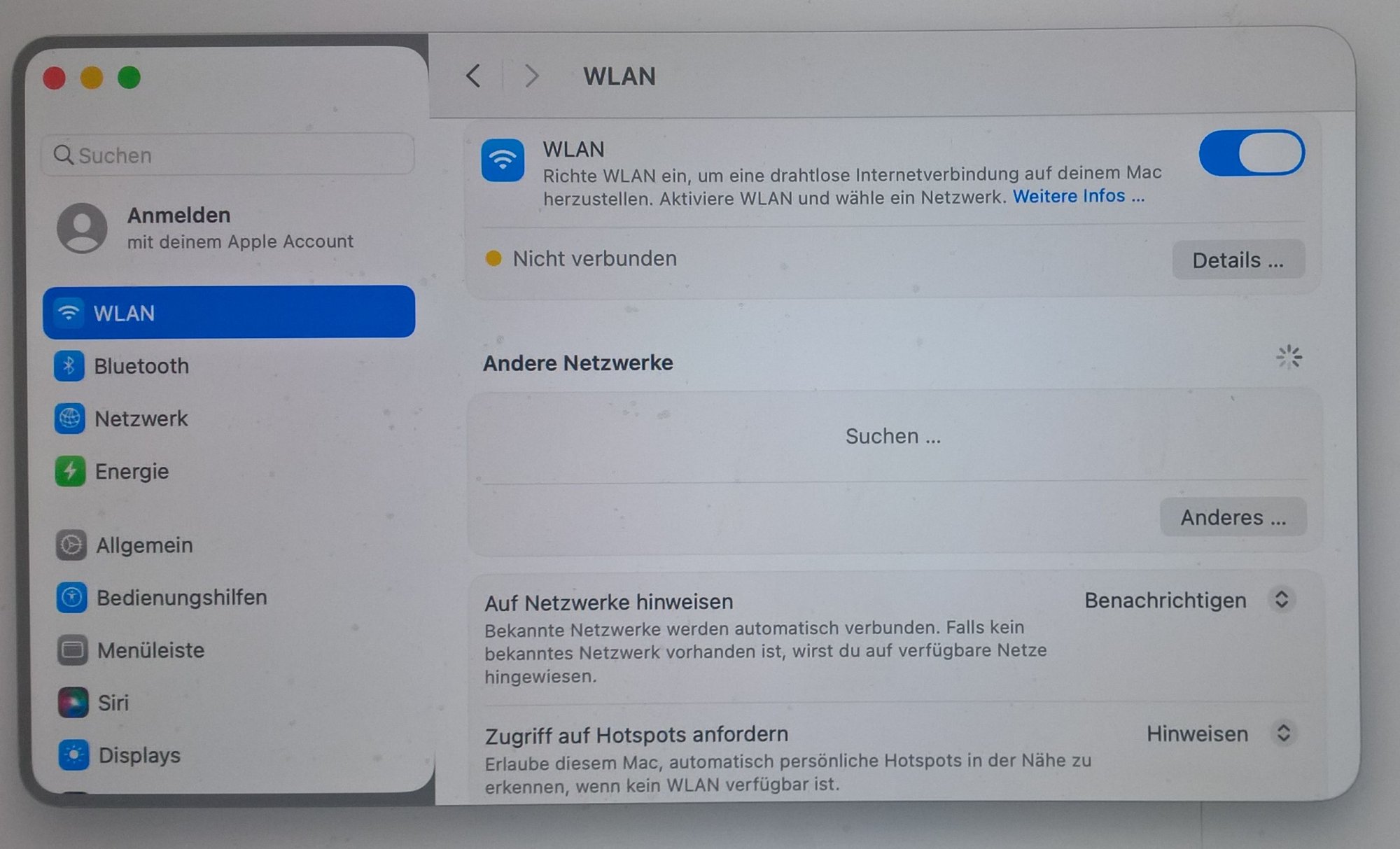

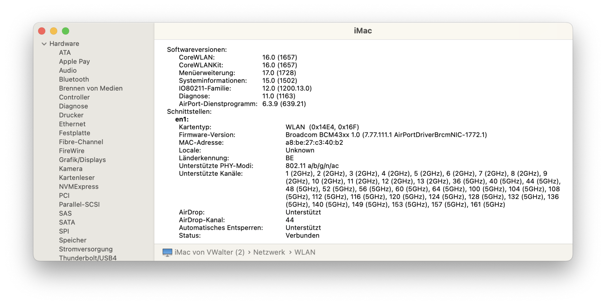

Quite a difference, but still no WLAN to activate for connnection.
OCLP needs an active network connection to retrieve the KDK. If no network connection is available, then KDK would need to be manually installed.

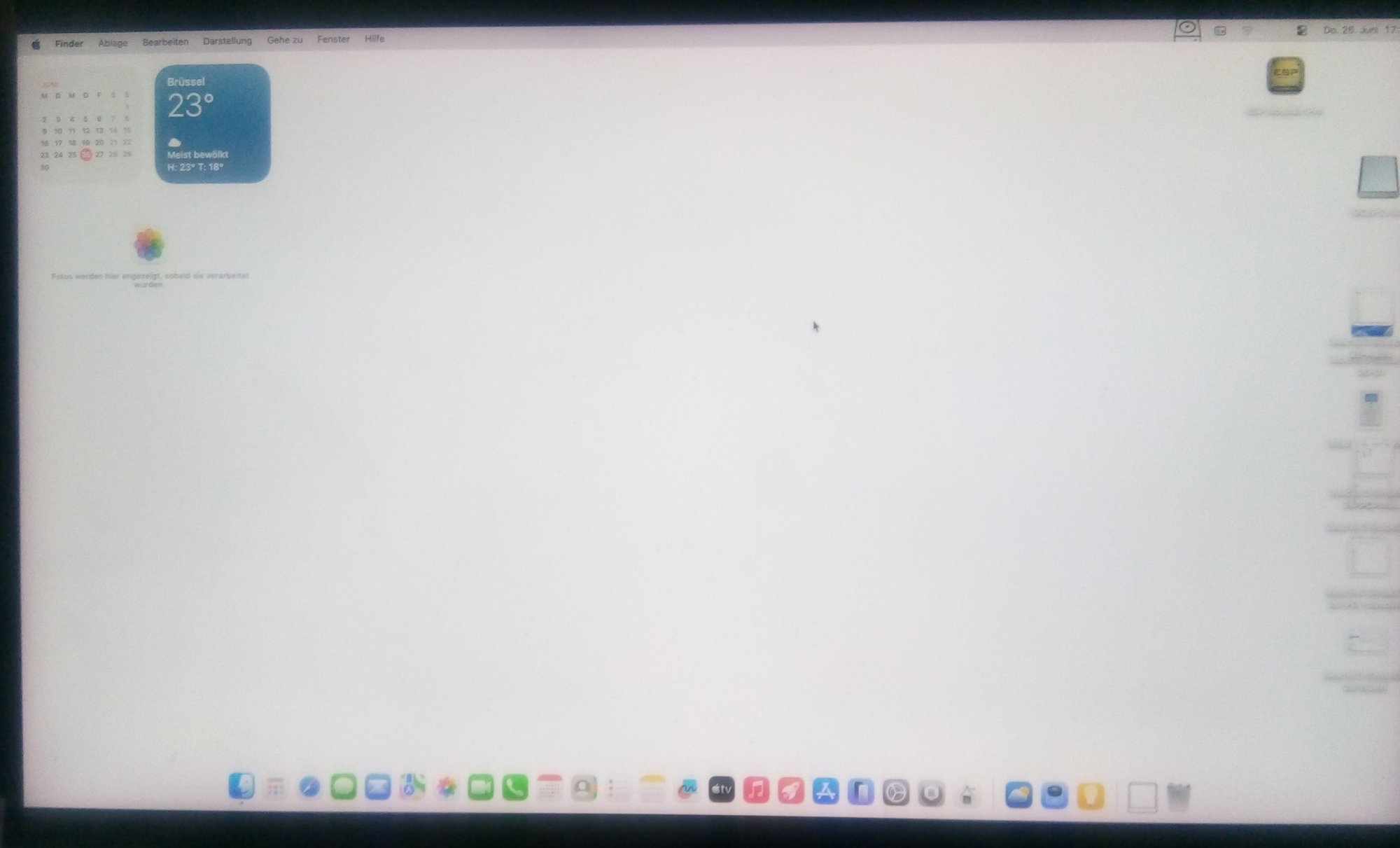

The changes were dramatic—as if I hadn't patched an OCLP-supported macOS yet.
The boot process was more or less normal shortly before logging in—after logging in, there was no more graphics support/a white desktop, ...
... a different resolution (also on the OC-picker), and opening the Control Panel seemed like slow motion.
The Wi-Fi is enabled—the logo is shown in the top right.
Before I can even search for the network, the iMac freezes.
I've now switched to the iMac 18.2, hoping the freeze won't last too long. But it doesn't look good—it's probably a permanent freeze.
I tried several times - always the same, even on macOS Sequoia where WLAN was also missing.
