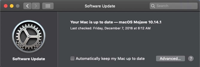

Is Anybody else not getting Mojave updates thru Software Update?
With 10.14.1 i had to grab the combo update manually and looks like with 10.14.2 i'll have to do the same.
It did however grab some updates for FCPX a few weeks ago so it is talking to Apple servers. I even reset it to default incase it wasn't.
Help !!
tsialex
Contributor
Jun 13, 2016
13,455
13,602
Help !!
If you forced HFS+, updates don't work anymore. Don't know anything else that block updates if you have a standard install.

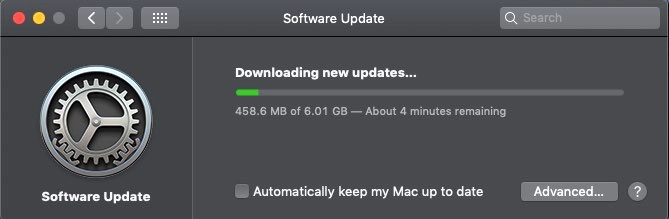

Ahhhh yes i am HFS+ instead of APFS on my RAID boot drive.
Very interesting how it all works now..In the AppStore i found Mojave and i clicked on 'Get' and it triggered the Software Update.
What about Safari and iTunes updates will the newer versions all be in this combo update ?

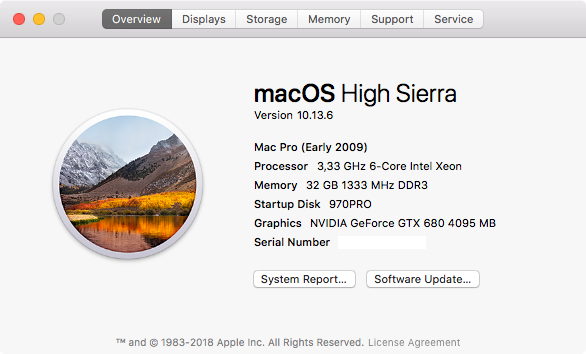

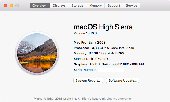

No, I have a GTX 680 4GB working perfectly here. There's two 4GB firmwares for GTX 680, and there is a GTX 780 6GB that works too, at least two people have it here.
Embraer is a nice place to work, I have a old buddy from middle school that works there.

AlexMaximus
macrumors 65816
Aug 15, 2006
1,237
582
A400M Base

Last question here for finding the ultimate Mojave solution:
- If I get a Quadro K5000 Mac edition in slot 1&2, it would give me Mojave capability. Check
- Moving my current Nvidia 980Ti in slot 3&4 with the Pixlas power cable should work as well. Check
- That leaves me with one open PCI slot (5) for an I/O Crest SP_Pex40129 card to move my two PCIe SSDs on there.
My USB card would need to be scraped, or going for an expensive netstor PCI expansion chassis.
In Windows, I guess I would have still the power of the 980Ti with the "right configuration" for games using the 980Ti
On the OSX side, I could Use the 980TI for Resolve in Mojave.
This might be better than a solo VEGA64 because of missing bootscreens and missing bootcamp and gimped apple encoding.
Do you think this config would be feasible, did I forget something?
