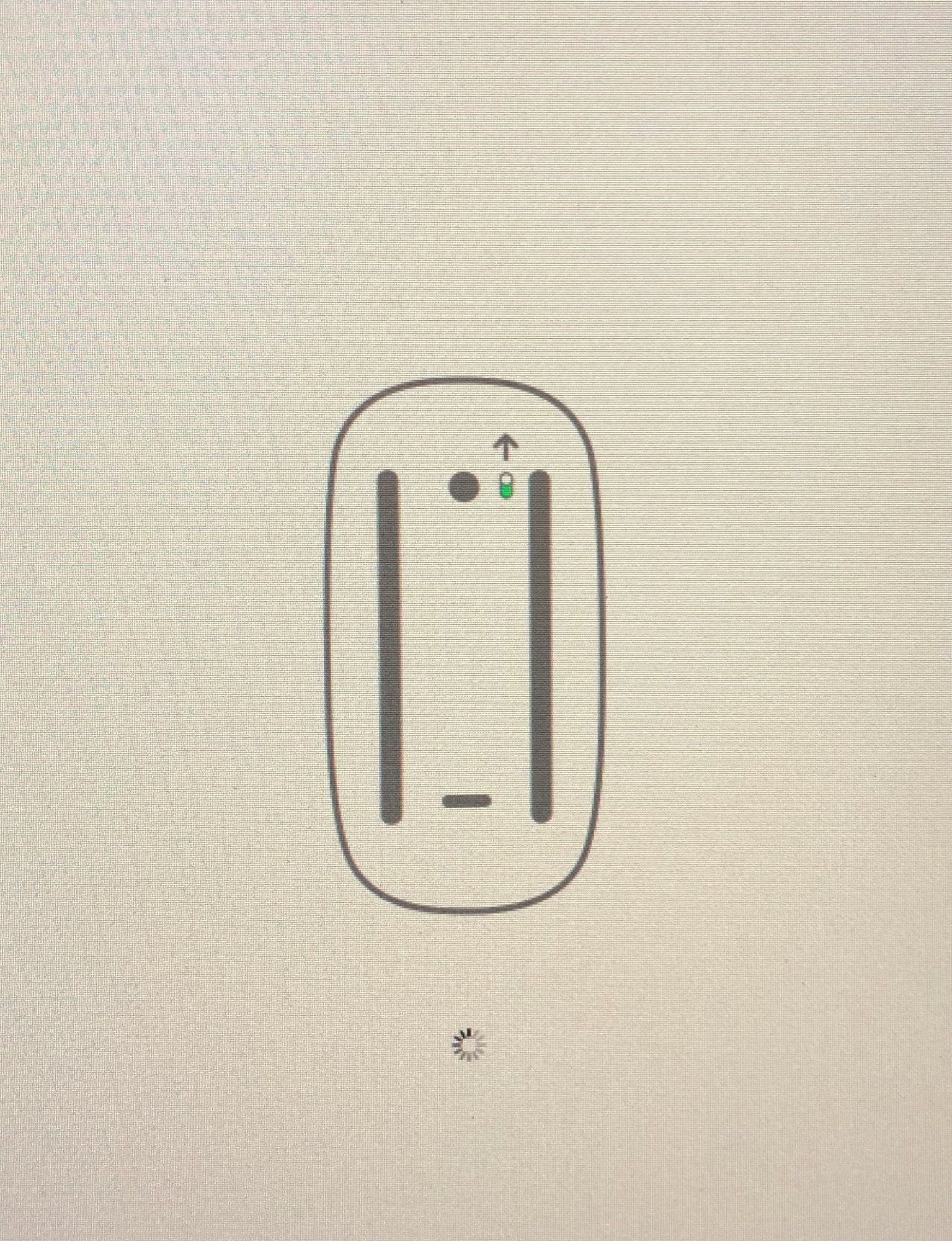

Trying to go from 140.0... to 144.0... and get this when I boot off Mojave on an external (had to remove my M.2 in order to do so). Any ideas what this is trying to say? Until my wifi/bluetooth card arrives, I only have a dongle for Bluetooth:
Trying to go from 140.0... to 144.0... and get this when I boot off Mojave on an external (had to remove my M.2 in order to do so). Any ideas what this is trying to say? Until my wifi/bluetooth card arrives, I only have a dongle for Bluetooth...View attachment 896031
Use wired keyboard and mouse.
The picture is telling you to connect/turn on an Apple Magic Mouse, it's showing the bottom of it.
Reactions: jeffhalmos
It's just that when I did turn it or the trackpad on it didn't go away. Found both wired keyboard and mouse and will go at it again. Thanks.

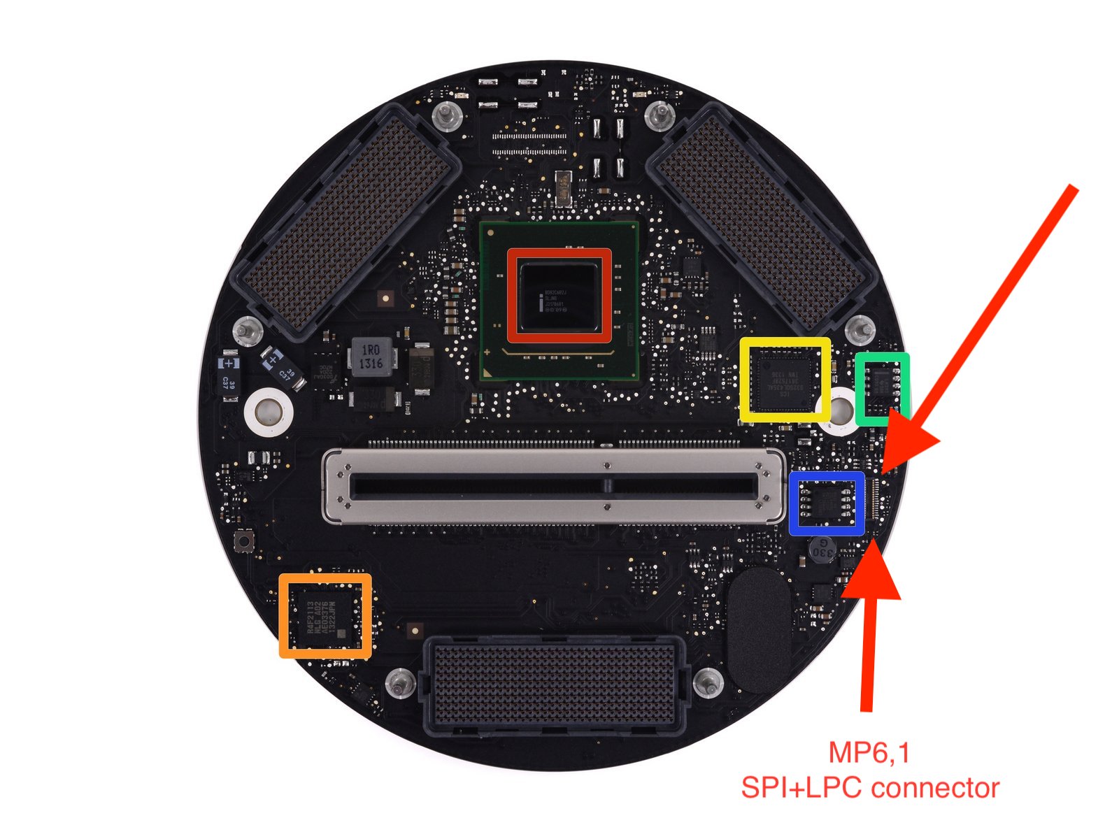

Ah, sorry I'm referring to the 2013/6,1 (trash can). Does that still apply?
Your problem is very different.
MP6,1 is a IntelME Mac*, albeit disabled, and the firmware is encapsulated and signed. Only Apple efiflasher can flash the firmware, unless you disassemble your trashcan and use an external programmer plus an adapter for the SPI+LPC connector to flash the reconstructed image.
You need to install the Apple OEM SSD back, the firmware flashing process can't continue if the original Apple 12+16 blade is not inside. Install it back, install Catalina on it and the firmware update process will happen automatically.
Post ThunderStrike, Apple disabled the access to the SPI after boot. Apple EFI firmware flasher saves the firmware and the flasher inside the EFI partition, do a reboot, then the firmware is flashed. This happens while the access to SPI is still open. When macOS boots, it's disabled.
Reactions: SamPotts
