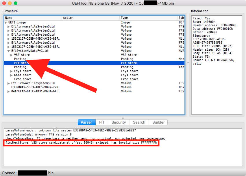

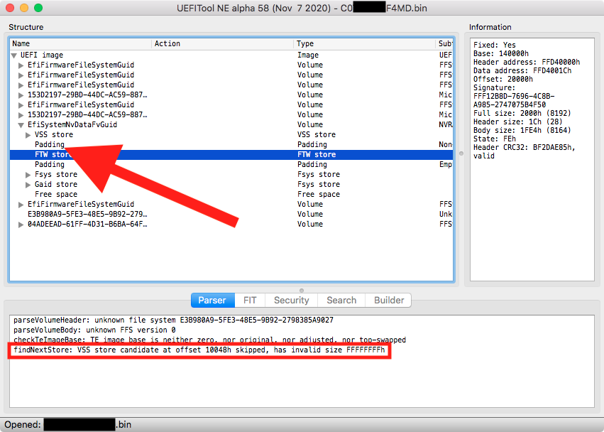

Another one with a corrupt header for the 2nd VSS store, it's the fourth one in 11 days.View attachment 1731819

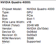

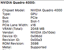

For me, with my ADHDI this is like wading through a swamp of alligators. I don't know what to erase and reformat or how to do it. Do you mean to download and reinstall Sierra?
Make a createinstallmedia installer of High Sierra, nuke your disk, re-format it and then install High Sierra. This is not BootROM related, but incorrect disk partitioning. If you don't know how to do it, it's easy to use the search or to google it and find instructions.
Quadro 4000 is a Fermi GPU (GF100-825-A3), Apple does not support METAL with Fermi GPUs, your screenshot shows a known misidentification. METAL is only really supported with NVIDIA Kepler GPUs.

I am working with a cMP 5,1 (mid-2010) that was used as a soft-RAID fileserver which I got for free from my work. It still has the dual 2.4GHz quad-core processors, four 4 GB DIMMS, and ATI Radeon 5770 in it, and my plan was to install a old GTX 760 card I have so I can run Mojave.
While I was waiting for a second auxiliary PCI-e power cable for the "new" video card to be delivered, I was sifting through all the information on OpenCore here because I am interested in having access to a boot menu that works with my non-flashed GTX 760.
Then I encountered the information on this thread about the potential issues production cMPs may have with a low amount of VSS Store space, corrupted NVRAM, and non-working garbage collection. So I started to check on the state of my cMPs NVRAM / VSS Store.
Here are things I did before the first dump of my eMPs BootROM that could have affected its NVRAM VSS store:
  • Updated Boot ROM to MP51.007F.B03
  • Reset NVRAM (2 chimes) and erased 3 HDDs to remove "broken" software RAID config
  • Removed one HDD after SMART status showed imminent failure
  • Updated Boot ROM to MP51.0089.B00 as part of High Sierra install
  • Installed fresh copy of 10.13.6 High Sierra
  • Rearranged and reseated four 4 GB DIMMs because at first one DIMM was not being recognized. Now all four are recognized and tested without any errors
  • Had to reset NVRAM (2 chimes) again while trying to figure out how to convert High Sierra boot volume from HFS+ to APFS. It took some CLI hoop-jumping, but I got it converted.
After all that, so far, I've dumped the BootROM six times today, and here's what I saw:
1. The VSS Store's free space on the first ROM dump was 20093, and the second store was fully empty (65448). The only repeated entries I see in that dump are MemoryConfig, but those seem to just be updated with a sequence letter at the end (ie., "MemoryConfig", MemoryConfih", "MemoryConfii", etc.) There were a bunch of entries marked Invalid.
2. On the second ROM dump (after 5-chime reset and a couple reboots to disable SIP) I found the VSS Store free space was much lower, at 6610. But the second store was still completely empty, and the entry list appears to be the same as before (no repeats, and quite a few Invalid entries.
3. After three more reboots, things changed a lot. There were only 3 entries in the main VSS Store marked Invalid and the free space has jumped up to 52695. But the second VSS store's free space was down to 55222, because it now has entries, all the same as what was in the main VSS Store except no Invalid entries and one was repeated (AAPL,PathProperties).
So if I'm understanding what I've been reading correctly, it appears garbage NVRAM collection was still working on my cMP 5.1. But then things got worrying.
4&5. I rebooted two more times before I got the GTX 760 card installed. On each reboot, the main VSS Store free space went down, to 46446, and then to 40197. There were more entries marked Invalid, but with the free space still well above 50% of the maximum, I decided to move forward with installing the NVIDIA card and beginning the Mojave upgrade with the Boot ROM update to 144.0.0.0.0.
6. After successfully updating to 144.0.0.0.0, I dumped the ROM again, and now the second VSS Store is gone! The main store free space is down to 24513, and I see a new message in the bottom pane output of the UEFITool: "findNextStore: VSS store candidate at offset 10048h skipped, has invalid size FFFFFFFFh".
I haven't started the Mojave install, because it appears the NVRAM has become corrupted. I'm not sure what the best course of action is at this point. Could this have happened because I jumped directly from BootROM MP51.0089.B00 to 144.0.0.0.0?
As an aside, I notice that the link speed for my GTX 760 card is 2.5GT/s, not 5.0GT/s, even though it's a PCI-E 3.0 card.

Yep, now the NVRAM volume is corrupt.
No. The problem is with the design of the NVRAM volume.
This happens a lot, it’s a 10+ years old Mac that was never intended to be running after all this time.
You will need a BootROM reconstruction. I’ll send you a PM later.
