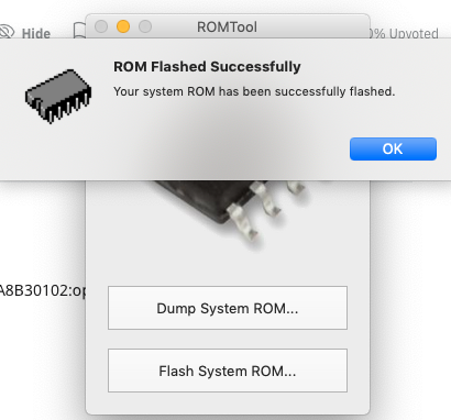

But anyway, then I tried to reflash the bootrom hoping that might fix the issue, but when I booted into Mojave again...it said I needed the security update all over again, which is the part that threw me for a loop. Why would it be asking for that again when I had already run it a few days before? All the security updates to OSX should have already been installed. Unless somehow it was never completed properly due to the partition map break down maybe....

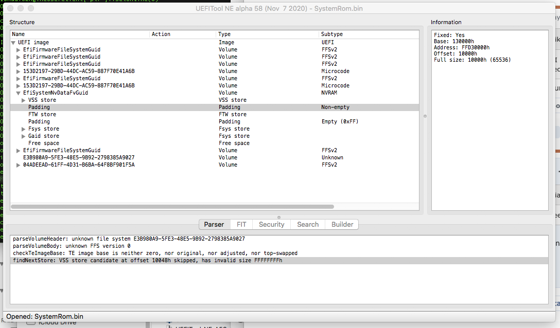

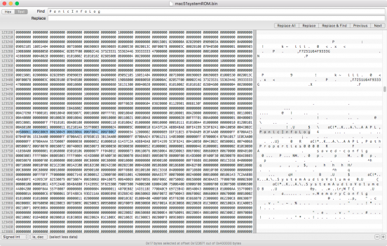

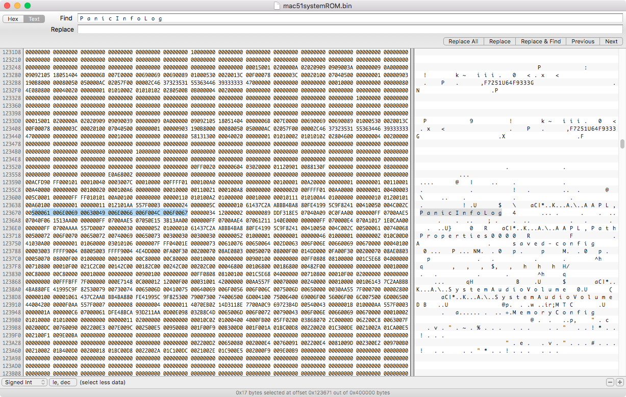

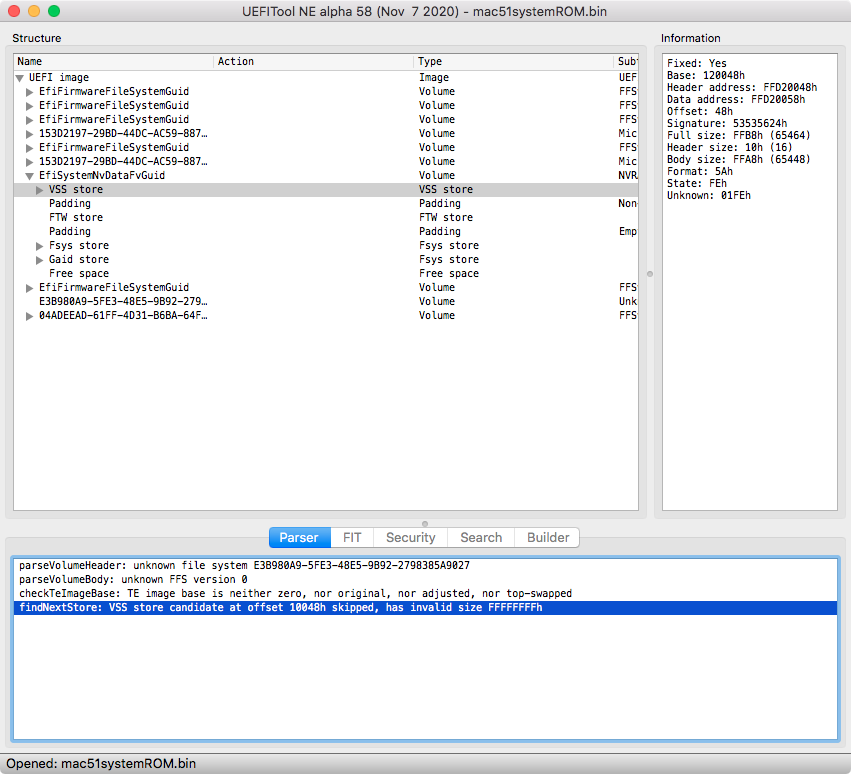

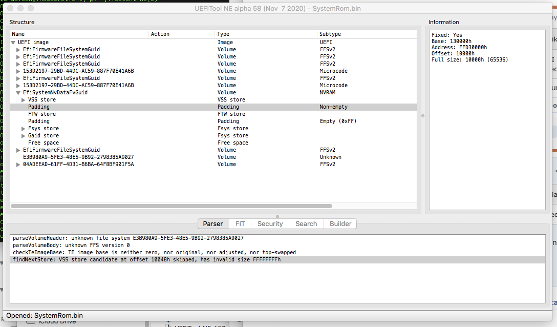

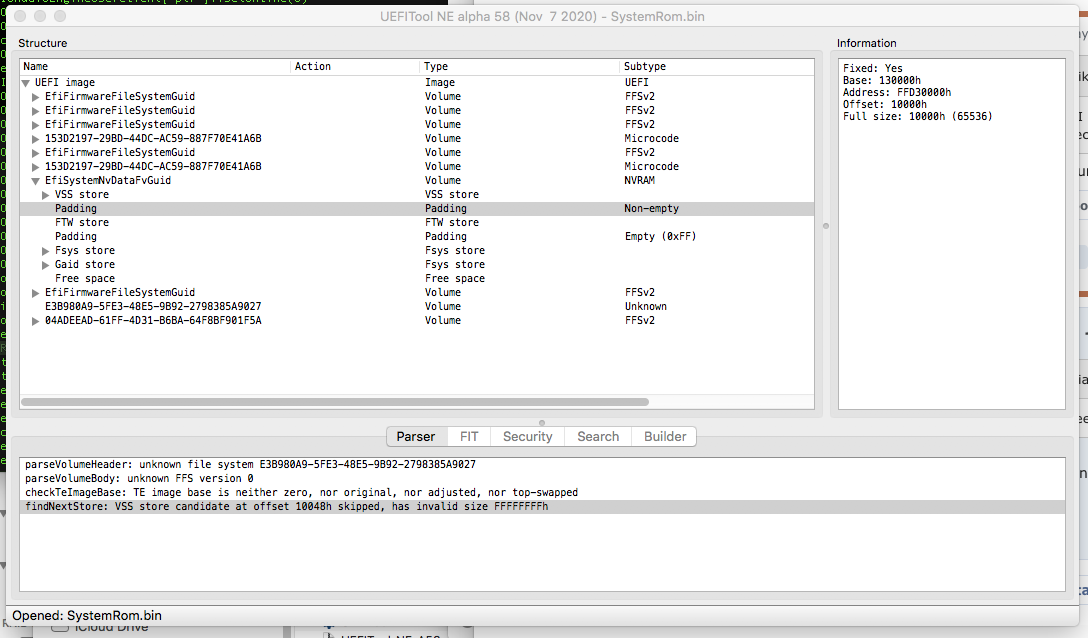

Another example of an overrun NVRAM/secondary VSS header corrupted, this time is a MP4,1>5,1 from @Muckd:

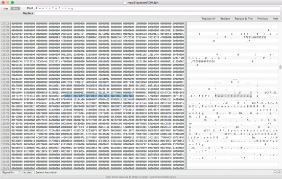

This is starting to become common place with hybrids (cross-flashed early-2009 Mac Pros). Read more about the problem below:

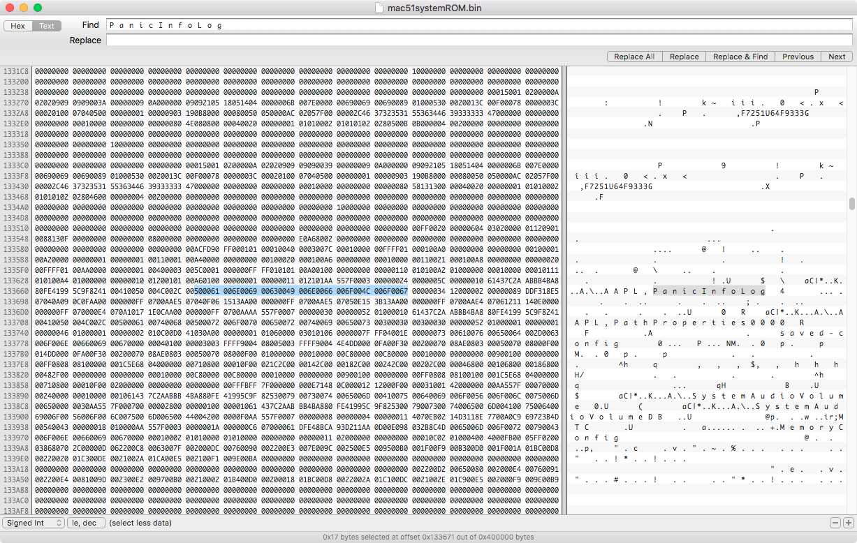

One thing that I've noticed from the start, but I didn't had enough data to investigate, these dumps with secondary VSS header corrupted usually have several PanicInfoLogs:
Screen Shot 2021-06-01 at 23.02.40.pngScreen Shot 2021-06-01 at 23.02.34.png
The question now is, the PanicLogs are a cause or a consequence?

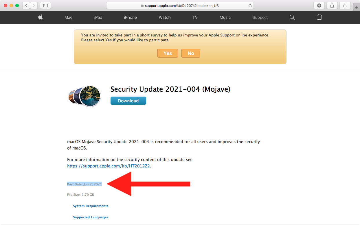

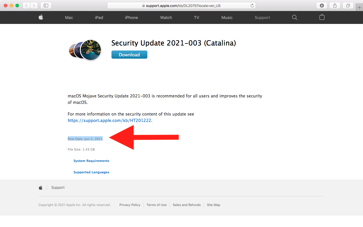

Apple re-issued stand-alone Security Update 2021-003 for Mojave and Catalina again today:

Apple re-issued Security Update 2021-003 for Mojave and Catalina again today:
I'm not sure that this is a reissue as much as it was making them available for separate download. There wasn't a change in the software update catalog for these updates since their initial release on the 24th of May.
Edit: I downloaded the updater and the included package was built on May 20, so it's definitely not a re-release.
Thanks for the heads up. I think the security update was applied correctly the first time or second time, it’s just that the disk where I have OC EFI, got completely messed up, partition map was destroyed and after that I tried to do low level full erase but eventually it would not even detect the drive in drive utility. Something got seriously messed up. I have since put it into a pc and running seatools on it, it’s possible the HDD chose this same moment to fail but it’s mighty coincidental that happened on the same night that I originally ran the security update.

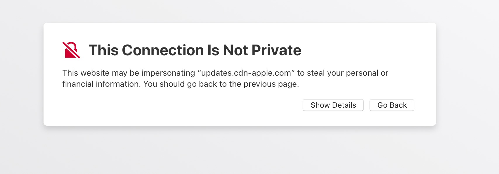

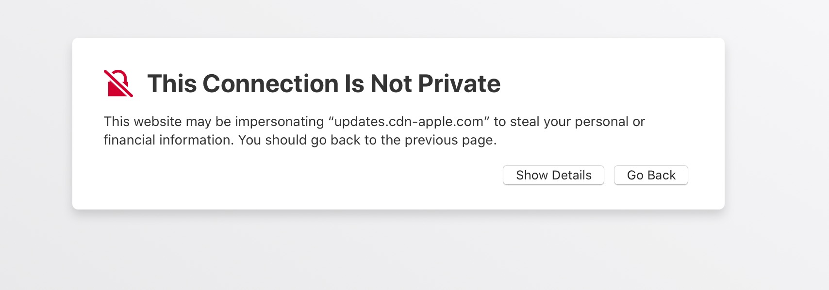

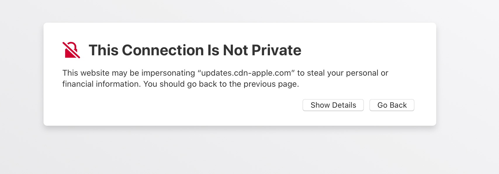

I went to have a look at that Catalina Security update, I used the URL I see in your screen shots, but when I open that link it shows the same page as you see, but when I click on the Download button I am getting directed to something that Safari is flagging impersonating "updates.cdn-apple.com to steal your personal or financial information"
What gives?
What gives?
Direct link to the support page for Security Update 2021-003 (Catalina):
https://support.apple.com/kb/DL2075?locale=en_US
Link of the update package works fine from Safari and it's an Apple official domain.

the domain does look legit I agree. I'm a little nervous when I try to allow it through anyway, it prompts for my system password with no other explanation...
