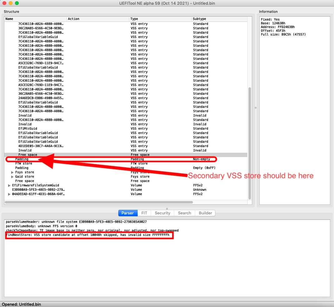

Indeed, no surprise, the "FreeSpace" entry of interest in UEFITool is completely missing. So it looks like I need a ROM reconstruction. I reached the point in the Rom dumping instructions where it says "DM @tsialex". OFC I sign up to find that I need 2 posts before being _allowed_ to DM! Sigh. @tsialex , can you help me?

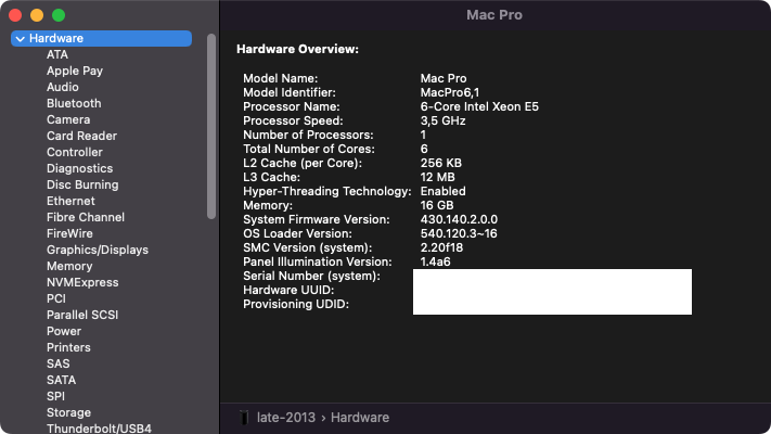

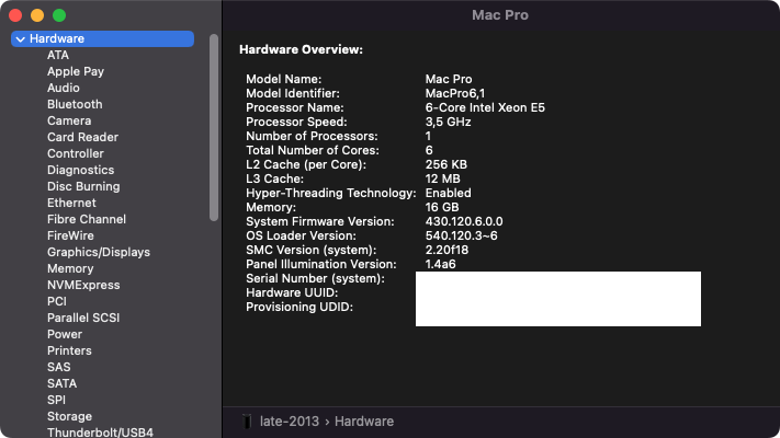

While this is a MacPro5,1 thread, MacPro6,1 had a new EFI firmware update with today's Monterey 12.5 DP4, the new EFI was updated from 430.120.6.0 to 430.140.2.0.0:

Nope, your NVRAM volume at least already have a corrupted header for the secondary VSS, see below:
You probably already have other issues. I'll send you a PM.
