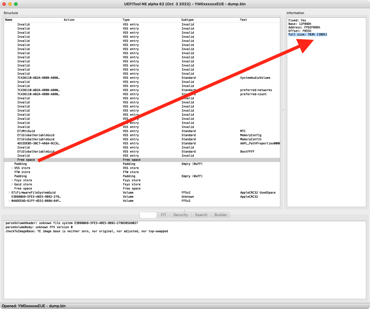

In theory, PEI when at power on initialization detects the main VSS store with less than 2KB of available space should immediately trigger a garbage collection run.
In real life, BootROM image dumps like this one from @macguru8 are becoming worryingly common:
One DIMM change/one MemoryConfig entry superseded and, at minimum, the secondary VSS store is overrun.

BootROM image dumps like this are becoming worryingly common
What's he got filling the NVRAM up ... any particularly large items?
Presumably running Monterey ... has he messed with Ventura as well?
