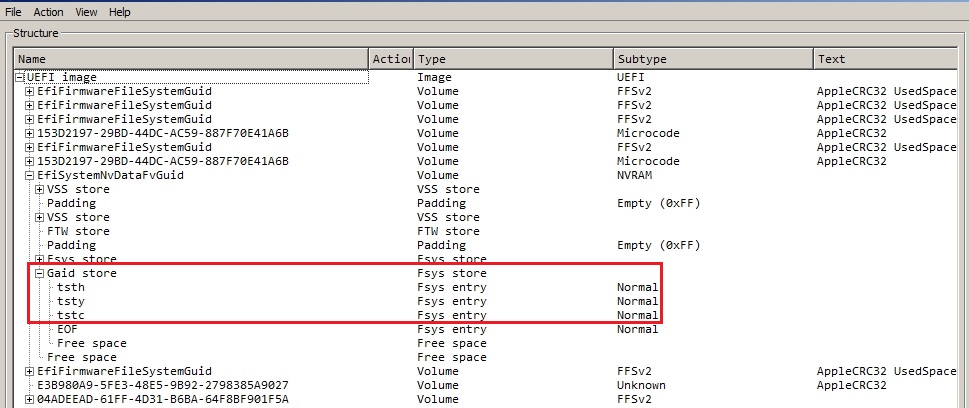

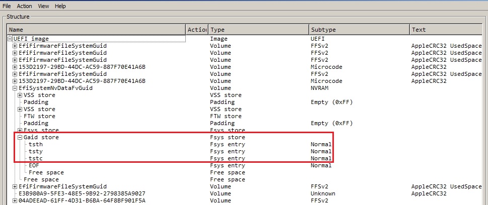

@tsialex:
Do you know something of the meaning of the marked entries tsth, tsty, tstc?

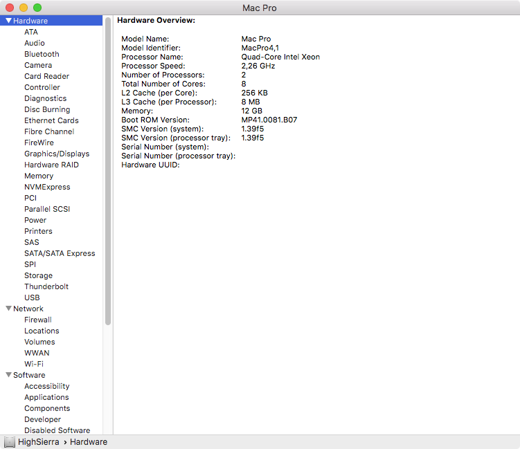

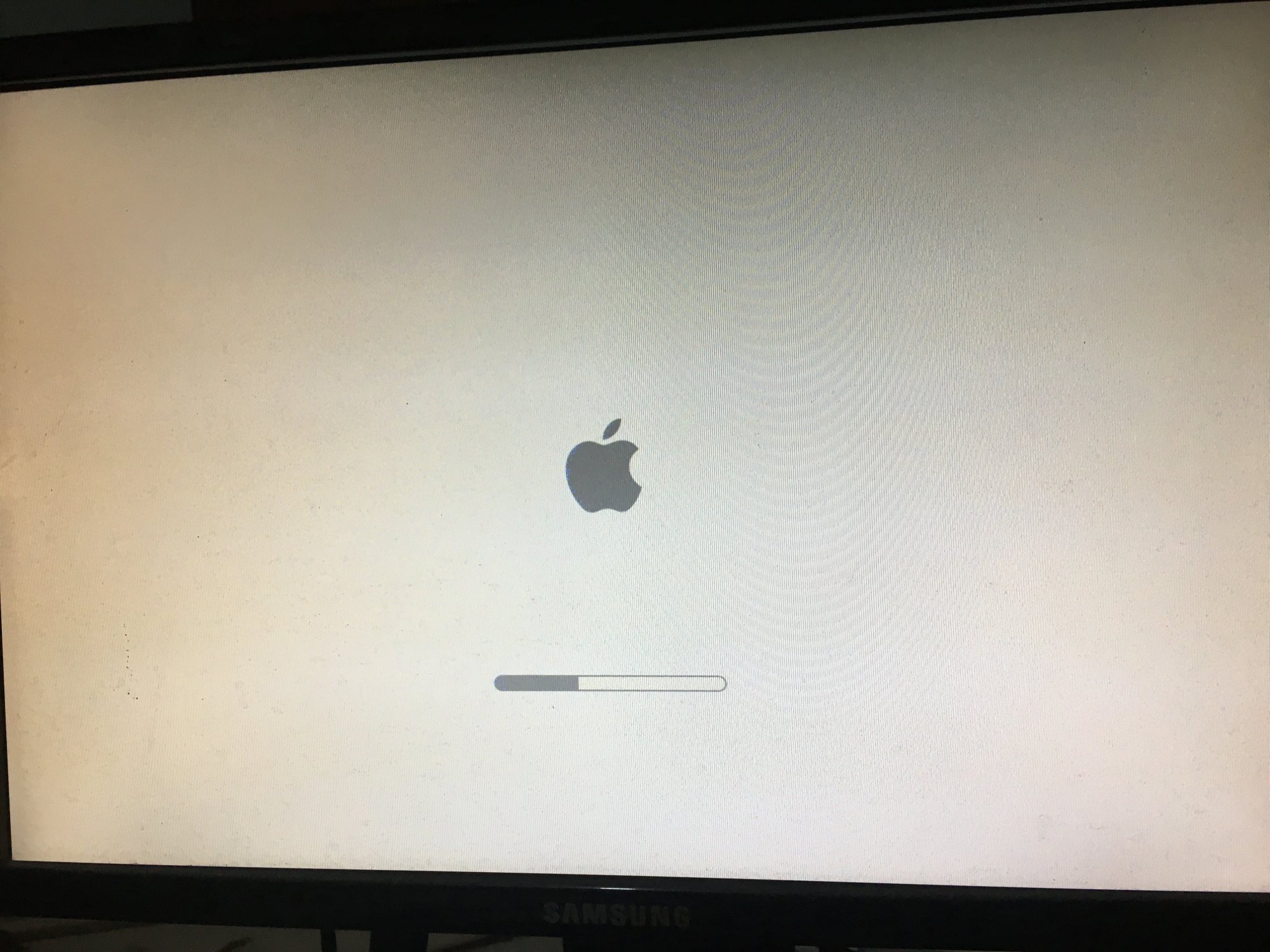

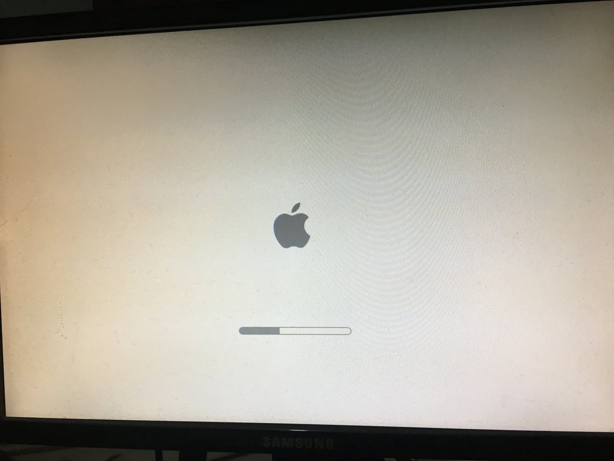

What about Pigsyn’s MacProFirwareToolUpgrade? It has option to downgrade, but to 2009. Which probably will be to far since I have 6-core processors. Is it correct? Can you provide me more details about your service?
Completely useless, but I just confirmed that you can only downgrade back to a MP4,1 EFI if your BootROM is MP51.007F.B03.
Had to reconstruct MP51.007F.B03 with my test Mac Pro intermediate files and downgrade from 144.0.0.0.0 to the reconstructed MP51.007F.B03 image to finally be able to run MacEFIROM's tool downgrade procedure successfully.
