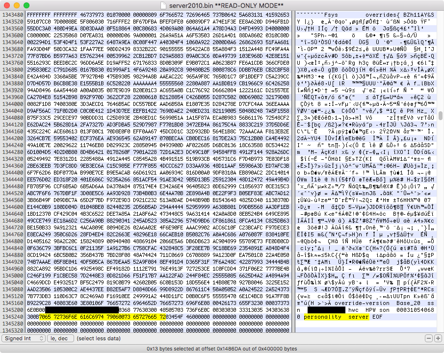

This BootROM have a interesting characteristic that I only heard about but never saw before, personality server. Some refurbished Macs and Apple repaired ones have similar info in this area too.
This one is a 2010 Mac Pro Server.
I almost ended my backlog of BootROMs to reconstruct. If anyone needs checking/correcting, get in touch.
Tomorrow is a holiday here and I almost ended my backlog of BootROMs to reconstruct. If anyone needs checking/correcting, get in touch.

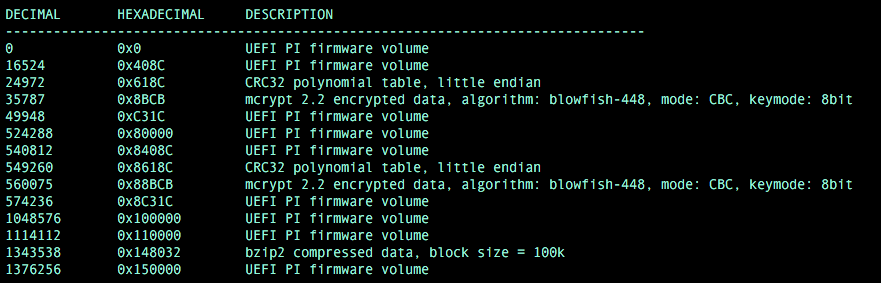

So I finally dumped my bootrom (still on 84) and ran binwalk on an old MBP I have for development and the like. I don't see any of the weird things people have mentioned before, is mine good?
Seems clean, but binwalk don't show PanicInfos, hardwareIDs problems or checksum errors.
Use this info to upgrade to MP51.0089.B00 and then to 138.0.0.0.0: MP5,1: What you have to do to upgrade to Mojave. Read this too #436.
You don't need to install 10.13.6 or Mojave, just use the full Mac App Store installers to upgrade your BootROM.
