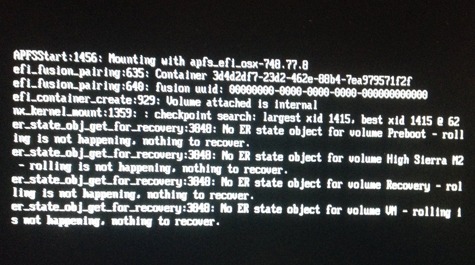

Attached is the screen from Linux EFI booting after BootROM 0089.
This is probably not new info, but I hadn't come across something like it on these forums.

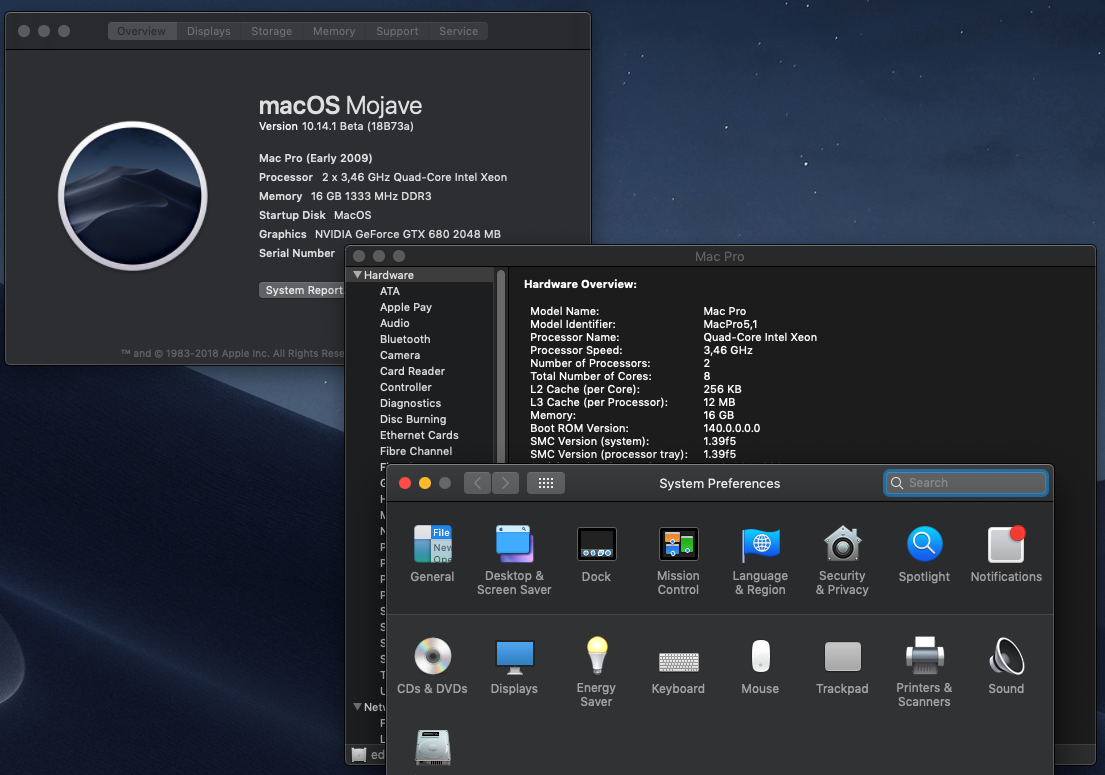

hi,
have a rather silly question, why my bootROM version showing like this (below) not like others here ?
I mean I see common number are in MPxxxxxx format
All know MP5,1 BootROM versions:
  • MP51.007F.B00
  • MP51.007F.B01
  • MP51.007F.B02
  • MP51.007F.B03
  • MP51.0082.B00 **
  • MP51.0083.B00 **
  • MP51.0084.B00
  • MP51.0085.B00
  • MP51.0087.B00
  • MP51.0089.B00
  • 138.0.0.0.0
  • 139.0.0.0.0 **
  • 140.0.0.0.0 **
** betas
