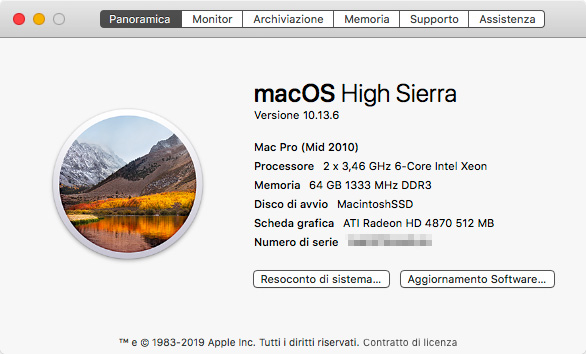

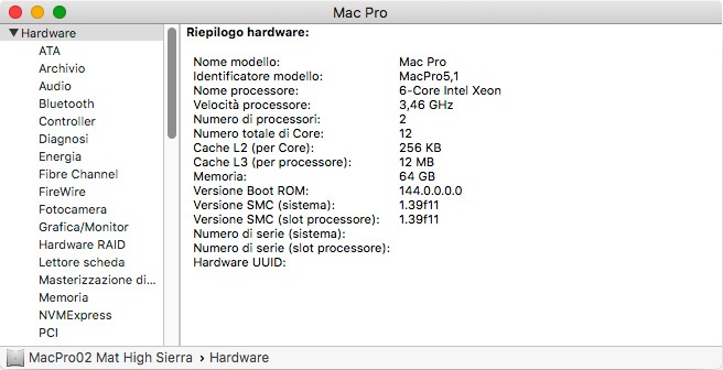

GTX 980 (flashed), genuine MID 2010 cMP 5,1 on latest High Sierra 10.13.6 and successfully updated BootROM to 144.0.0.0.0, but no boot after that with GTX 980 - not even a chime.
Hi, I hope some owner of a flashed GTX can share his experience.
First off, thank you @tsialex and all you other competent contributers in this helpful thread.
I am not a computer pro and after seraching for some hours I feel pretty much stranded.
My apologies if this is has been already asked.
I searched this thread but could not find a solution.
To be clear from the beginning:
the MP is not bricked after the BootROM update, well, it doesn't seem to be.
And, I am not interested to install Mojave.
Like it reads in the first line of this post, I succesfully updated to BootROM 144.0.0.0.0 on my cMP 5,1 thanks to tsialex's instructions. I managed to do so with running the latest Mojave Installer (only for the firmware update) and having installed a flashed GTX 980.
No other PCIe slot is in use.
The system is installed on a 2.5" SSD (Anglebird "Apple SSD") which resides in the first HDD bay thanks to a 3.5 to 2.5 adapter.
What I missed to do before the firmware update is to unplug the DisplayPort cable that connects the graphics card to an ultra wide Dell monitor with a lower-than-4k 3440x1440 resolution.
And there was a Wacom tablet attached over USB.
The Mac Pro was and is still on latest High Sierra 10.13.6.
It boots fine after I switched to an old ATI Radeon HD 4870 and connecting it to a 23" Apple Cinema HD display.
In the meanwhile I reset 3 times nvram after I read a comment about doing so in another post.
But there is still no boot when the GTX 980 is installed. I switched between Radeon and GTX a couple of times. The GTX card gets powered, a click and some lights on the mb, some drives spinning up.
No chime, no boot. With the Radeon, immediate booting.
I am writing this post from my MP5,1 with BootROM 144.0.0.0.0 on the latest HS.
Is there any chance that I will get my GTX 980 back to work ?
Thanks for any comment.
