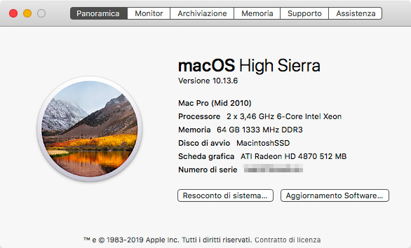

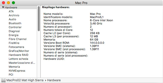

GTX 980 (flashed), genuine MID 2010 cMP 5,1 on latest High Sierra 10.13.6 and successfully updated BootROM to 144.0.0.0.0, but no boot after that with GTX 980 - not even a chime.
Hi, I hope some owner of a flashed GTX can share his experience.
First off, thank you @tsialex and all you other competent contributers in this helpful thread.
I am not a computer pro and after seraching for some hours I feel pretty much stranded.
My apologies if this is has been already asked.
I searched this thread but could not find a solution.
To be clear from the beginning:
the MP is not bricked after the BootROM update, well, it doesn't seem to be.
And, I am not interested to install Mojave.
Like it reads in the first line of this post, I succesfully updated to BootROM 144.0.0.0.0 on my cMP 5,1 thanks to tsialex's instructions. I managed to do so with running the latest Mojave Installer (only for the firmware update) and having installed a flashed GTX 980.
No other PCIe slot is in use.
The system is installed on a 2.5" SSD (Anglebird "Apple SSD") which resides in the first HDD bay thanks to a 3.5 to 2.5 adapter.
What I missed to do before the firmware update is to unplug the DisplayPort cable that connects the graphics card to an ultra wide Dell monitor with a lower-than-4k 3440x1440 resolution.
And there was a Wacom tablet attached over USB.
The Mac Pro was and is still on latest High Sierra 10.13.6.
It boots fine after I switched to an old ATI Radeon HD 4870 and connecting it to a 23" Apple Cinema HD display.
In the meanwhile I reset 3 times nvram after I read a comment about doing so in another post.
But there is still no boot when the GTX 980 is installed. I switched between Radeon and GTX a couple of times. The GTX card gets powered, a click and some lights on the mb, some drives spinning up.
No chime, no boot. With the Radeon, immediate booting.
I am writing this post from my MP5,1 with BootROM 144.0.0.0.0 on the latest HS.
Is there any chance that I will get my GTX 980 back to work ?
Thanks for any comment.
Mat
Maxwell NVIDIA GPUs that are not flashed with Mac EFI will only work with web drivers correctly installed, you need to reinstall the web drivers. Without the web drivers correctly installed and with the NVIDIA NVRAM setting enabled, your GPU won't work and you won't see a screen on your display.
Btw, every time you clear the NVRAM, you will need to re-enable the NVIDIA NVRAM setting again booting with a working GPU, or using screen sharing/ssh/etc, and then opening Terminal:
Code:
sudo nvram boot-args="nvda_drv=1"
The correct thread for help with NVIDIA drivers is FAQ - Nvidia Web Drivers, your problem is off-topic here and not related to MP5,1 firmware.

Thanks, tsialex.
I will try with re-installing the web driver and setting the boot argument and post the outcome. I posted my question here because this morning before doing the BootROM update the GTX 980 worked fine which makes me suspect a correlation.
BTW, when the Mac won’t boot and not even chime can this still be web driver software related ?
Could the firmware update change how power distribution is handled from the PSU to PCIe and other components like memory banks ?
GTX 980 is a Maxwell GPU and only works if the web drivers are correctly installed and activated.
No. Your problem is that you cleaned the NVRAM and removed the "nvda_drv=1" boot argument.
Your problem is not related with MP5,1 firmware at all and the firmware updates didn't change anything related to your GPU not working.

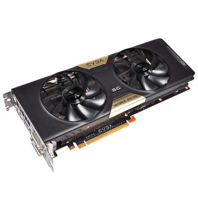

These eBay prices for used 2012 era NVIDIA GPUs are just stupid.
K5000 and GTX 770 are not flash yourself GPUs, GTX 680 is if the card you buy follow the eVGA GTX 680 Mac Edition reference, try to find one like 02G-P4-2680-KR and flash yourself. This is the best instructions Step-by-Step Instructions for Flashing GTX680.
AMD RX 580 needs to be 3rd-party flashed or won’t work for the first upgrade requirement, this you can't flash and have to buy already flashed. You can enable Mojave x264/H265 hardware acceleration with a RX 580.
These eBay prices for old NVIDIA GPUs are just stupid. K5000 and GTX 770 are not flash yourself GPUs, GTX 680 is if the card you buy follow the eVGA GTX 680 Mac Edition reference, try to find one like 02G-P4-2680-KR and flash yourself.

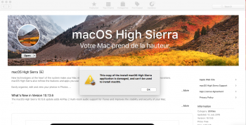

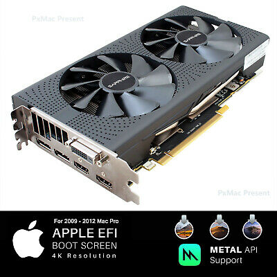

Hello Guys,
Got my metal card (RX580 with EFI Boot) and ready to switch to Mojave my CMP5.1 2012 (then maybe Catalina later). Before the switch, I was willing to upgrade a current drive in Sierra to High Sierra. So, I am fighting since hours with an error: the 10.13.6 image from Apple is corrupted! 1 year ago, I downloaded successfully and kept on my Mac. Any bootdrive with it will fail. Launching it directly from application section fails too. I just downloaded again from Mac Apps store, and got same error (picture attached).
I started to run of ideas. What am I missing? Thanks for your help.
ps: I want to keep a drive in HFS+ with graphic card drivers still compatible with my 580, to switch back from bootcamp simply.

As @IndioX suggests above, resetting the date on your MP (and turning off network time) should enable this to proceed.
Many thanks as well as to Indiox. I was feeling it was a kind of intended limitations...
But the error message got is really (....)!! No words about certificate. Once it can be downloaded by the official channel, this do need to be explicitly written somewhere in my opinion.
Gonna try as soon as possible.

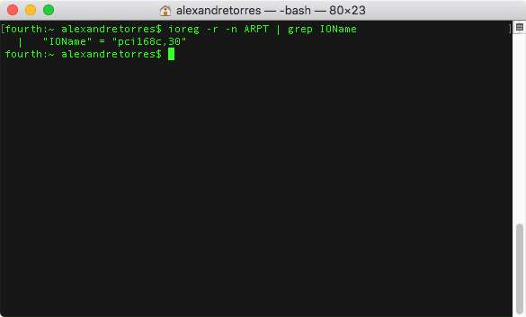

Maybe you have one of the now unsupported AirPort Extreme cards, Apple removed support for several old cards with Mojave. Boot a macOS version where it worked and check the model.
You can use this command to show the PCIe ID (manufacturer and model) when macOS don't support the AirPort, then you search for it.
Code:
ioreg -r -n ARPT | grep IOName
This table for Atheros models will help:
Code:
pci168c,2a AR9281
pci168c,24 AR5418/5133
pci168c,2a AR9280
pci168c,30 AR9380
pci168c,34 AR94621
pci168c,2a AR9283
pci168c,2b AR9285
pci168c,2e AR9287
pci168c,2b AR9285
pci168c,2e AR9287
pci168c,2a AR9280
pci168c,30 AR9380
pci168c,32 AR94851
pci168c,32 AR94851
I'll add one for Broadcom models later.

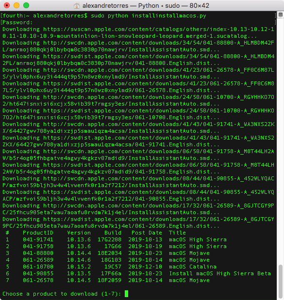

This is the Apple Support page where you can get the link for the 10.13.6 Mac App Store Installer (you need this even if you already are on 10.13.6). see the image below. Note, if you never used Mac App Store before, you need to validate your account first and download a free app before trying to get High Sierra View attachment 793503
First of all, apparently I missed all this manual firmware update nonsense, so thanks a BAZILLION for all your help to help us squeeze the last bits of life from our Mac Pros!
Secondly, I'm running Catalina 10.15.2, and I am trying to download the High Sierra 10.13.6 installer, and I cannot.
I clicked your link above, found the link to "Get macOS High Sierra," and it took me to the App Store. When I clicked the "Get" button, it launched System Preferences > Software Update utility and started downloading. I let it go overnight. When I came back this morning, I received a message saying the update couldn't run because it was too old.
Is there a way I can download the installer and bypass the Software Update utility, perhaps via Terminal? Or, when the download finishes, where is the file kept? I see nothing in the /Applications or /tmp folders.

You can always use installinstallmacos.py, download it from here https://github.com/munki/macadmin-scripts, you need to download the 17G66 build.
Hi.
A short follow-up: modifying date worked perfectly! I have now High Sierra in HFS+ allowing to get out from bootcamp easily.
I have upgraded twice the bootrom and I am now under Mojave 10.14.6 with all running smooth.
Thanks for the KEY hint and a big (...) to Apple who did not reply me and put 0 indications in the official downloading page.
Link on App Store is pointing to HS 10.13.6 while after the download, it is only 10.13.3. Not a big deal, but what a mess in terms of information sharing...
Hi.
I don't know where you got 10.13.3. Apple offers only 10.13.6 for download and the re-issued version released last October don't need the change of date at all.
Btw, 10.13.3 BootROM version is MP51.0084.B00.
