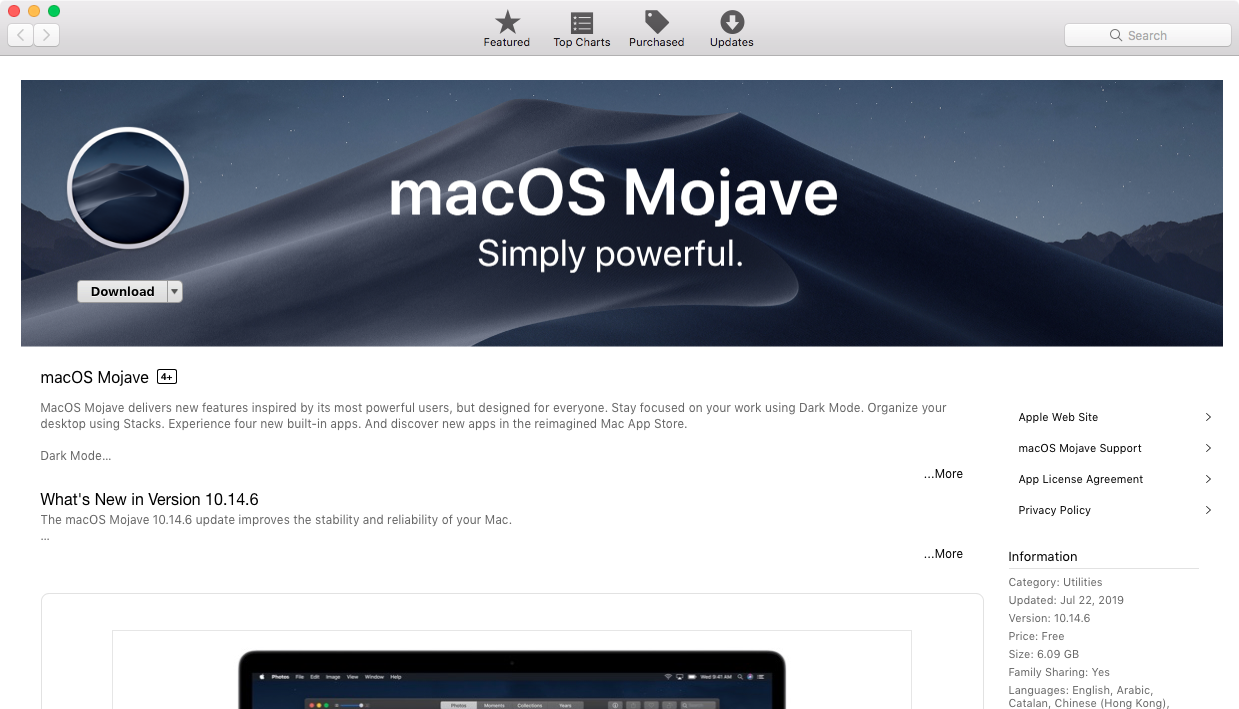

Thank you kindly, tsialex and Macshrauber,
I am on High Sierra, Boot ROM version MP51.0089.B00 and ready to move forward to 144.0.0.0.0
As for the matter of doing it offline as Macshrauber mentioned or only as an online direct download as tsiales mentions in post #1, is it possible to do this offline without risks?
- If so, is there a recommended link to the specific download?
From post #1, the link: full Mac App Store installer for Mojave leads to itunes and when it opens it reads that it is not available in the US store. I am in the US. and found many versions after digging for a while.
This is where I spent hours downloading different versions and the ones I tried where not complete versions or as full versions did not open after download. I believe I have established that I have a metal supported card. I did have very slow wifi and it stretched things further... and there may be a chance that might have influenced the downloads... I don't know.
- Does anybody now the link for the right download for online install to follow procedure as per the first post? Then I can stick to making that one work. (and drop the install after the Boot ROM is upgraded).
- If not, and if only offline is the option, where do I get the right Mojave download and is there a specific procedure to follow or just standard follow the prompts until done?
I apologize for all these questions. I am a bit stuck and I definitely want the Boot ROM upgraded now, before I move on to Mojave and further.
Your help is very appreciated.

Mojave direct link from first post is correct, just opened it from High Sierra and confirmed it working:
Anyway, you can always use installinstallmacos.py to download Mojave full installer.

Thank you, tsialex!
The problem must be that I tried downloading it from my macbook air, which is running Mojave already. I have to take my 5,1 home and try your link from there.
Thanks again!

where #4 is the latest Mojave full install.
Thank you, tsialex and Macshrauber.
With proper internet it all went a lot faster and smooth.
I first created a SATA hard drive with a clean install of High Sierra, did the latest updates, then downloaded Mojave, commenced the first part of the install, verified a successfu Boot ROM upgrade and installed Mojave right after that. A complete clean install that I will backup and set aside to upgrade from later. That way I can chose to only install the applications I use and no added ""crap. (crap can live in my laptop)
Thanks again!
Happy camper here.
