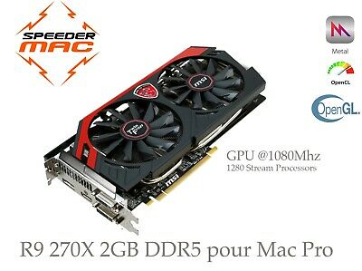

We have a Mac PRO Upgraded to 5,1 with the configuration above, running great High Sierra 10.13.6 :
- upgraded from quad core 2009 to Westmere 6 core 3,46 Mhz
- ROM 144.0.0.0
- AMD R9 270X 2GB
All of that seems Mojave compatible and ready to go.
But the MAc Pro doesn't want to boot with Mojave, and stop with the grey Apple with the progressive bar.
What we tried :
- When we try to install directly from high Sierra, we had a warning talking about Filevault and Graphic card.
But no filevault active on the computer, and the graphic card seems metal compatible.
So we use Mac Os Mojave Patcher and install Mojave. The install went at the end, but at the end of the process , the Mac Pro won't go at the end of th boot.
- Install Mojave on another computer does the same thing.
Anyone can help ?

Apple removed support for Pitcairn family of GPUs after Mojave. That’s your problem, unsuppprted GPU.

Metal support has nothing to do with driver support. If the card is not one that has the PCIe id in the drivers, it won’t work. Apple removed HD7850/7870/R9-270/R9-270x made from Pitcairn and Curaçao GPUs but kept support from the ones made from binned Tahiti (HD7950/HD7970/R9-280/R-9-280x)chips. That’s why some of these cards still work, they use Tahiti chips with less CUs and less RAM.
