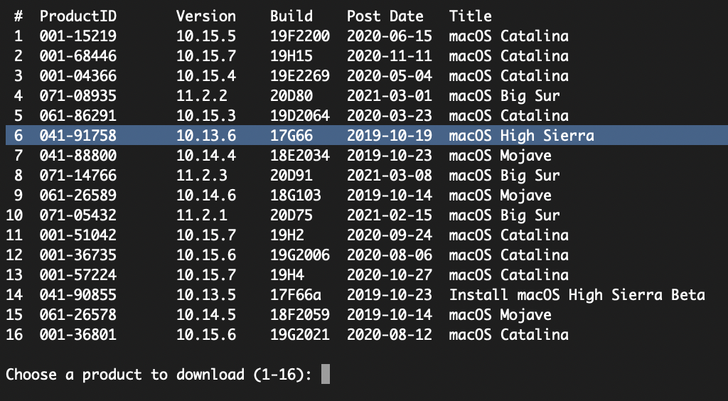

So I already have a clean install of High Sierra, installed from a createinstallmedia USB disk. On a SATA disk. And the original problem:
"When trying to upgrade the firmware Mojave installer constantly asks administrator password in order to add a new helper tool and won't ever shut down."
Download this full installer with script and try again.
MAS does not always serve full installer.
That download and fresh install of High Sierra via installinstallmacos.py did it! Thank you very much! :D
